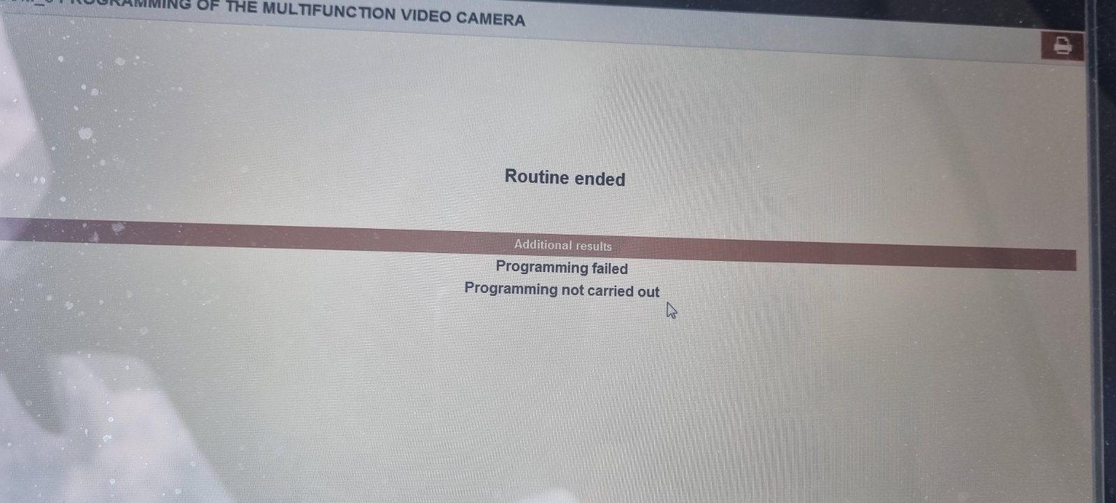

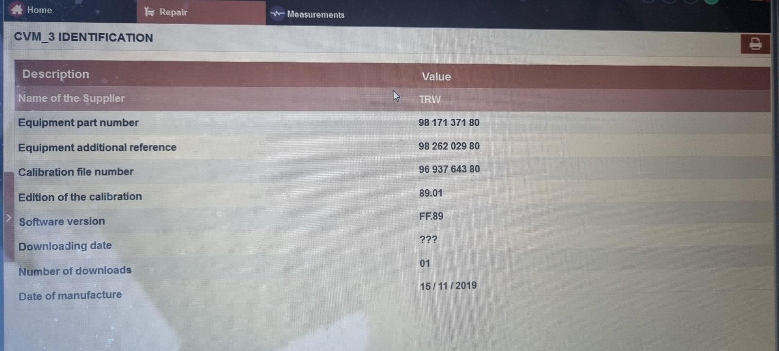

I have a warning on tha lane departure and lane assistant.
The error codes are
B1000 54 Download of the calibration of the multifunction video camera
And downloading date is ??? Under identification
Tried the dynamic calibration where you Drive in 70 road for a while but it ends with an error.
Anyone with input or tips on this ?
Maybe also some information about how the static calibration procedure?

Re: Peugeot 3008 multifunction video camera
Basically it's saying the calibration has not been downloaded successfully and until it has been, you will get this error. This will require PSA server connection access for calibration download.
If you don't have a paid account for access to the server you'll need a dealer to calibrate it.
This can happen if the option to download has been selected and then aborted or not completed - leaving it in an unconfigured state.
Fault Code: B1000 54
Description of Fault: Downloading of the calibration of the multifunction video camera: Absence of calibration.
Error during downloading of the calibration
The ECU is virgin: Absence of the calibration file in the ECU.

Can i use my pirate(china bought) pp2000 device and purchase a token for my car and use the official https://public.servicebox-parts.com/ to do this myself?
Or do i need special equipment for the static calibration anyway after i do the download ?
