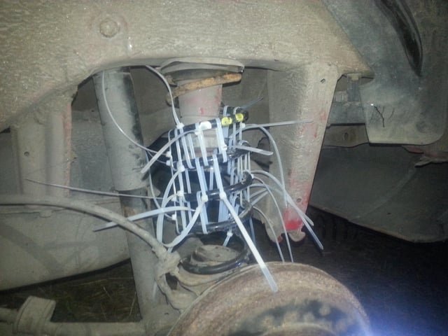

Purely for interest, I asked about the use of biodegradable ties and was told they are made to go with biodegradable waste sacks for the catering industry. It enables the large scale storing of organic waste which can then be deposited in landfill without further interference cutting costs and ensuring the environment is able to fully decompose the waste!! :)
x 3565
Biodegradable cable ties..... also known as string :lol:

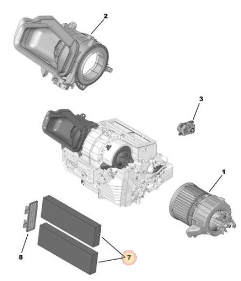

Copied from the parts thread:
GiveMeABreak wrote: 03 Aug 2024, 12:50 No worries
(10) Driveshaft Self-Locking Nut, Torque: 28,5 da.Nm
As for Gearbox oil, you're supposed to replace the amount removed, but if unsure, drain and refill. Quantities here depending on operation:
Quantity of oil to fill after draining: 2,1 ± 0,1 litres.
Quantity of oil to fill after an overhaul: 2,2 ± 0,1 litres.
Oil quality: 75W80.
Cabin Filter:
(7) Cabin Filter, 3 Options:
OEM Original Carbon Filter (Particles & Gas), part: 9804163480, £50.96
Cheaper Carbon Filter (Particles & Gas), part: 1612920480, £21.07
Anti Allergenic (High Performance Carbon, part: 1616959280, £63.65
On a LHD this on on the right side, so can't see it being different for a RHD. I believe you need to remove driver side centre console trim (remove centre console side trim cap to reveal screw). You'll need to find the cover as below and remove this to extract and refit the 2 filters. There are 2 plastic clips (tabs) to release the cover.

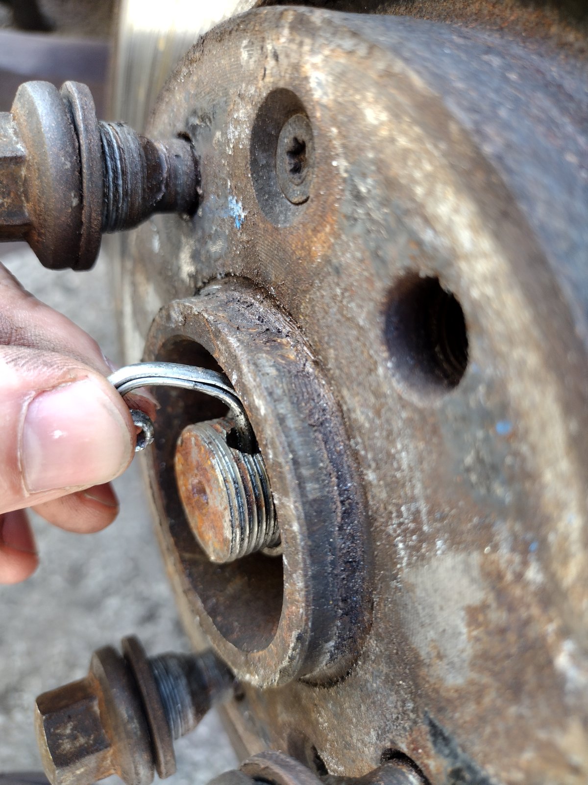

Right hand side driveshaft nut is not coming off.
I can keep going but it seems fairly clear with a 600 mm breaker bar plus extra length of gas pipe, sure wasn't done to 285 newton meters!
Posts: 5360
Joined: 25 Apr 2022, 09:03
x 2366
Unread post by MattBLancs »
It's also a 36 mm nut, and some how a split pin wrangled in to the hole in it. Who knows what bodgery is going on here!!

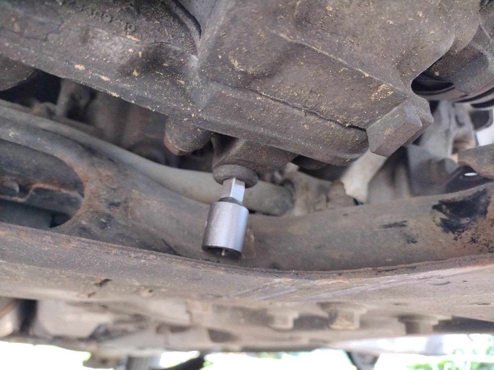

Gearbox oil drain location is suboptimal!

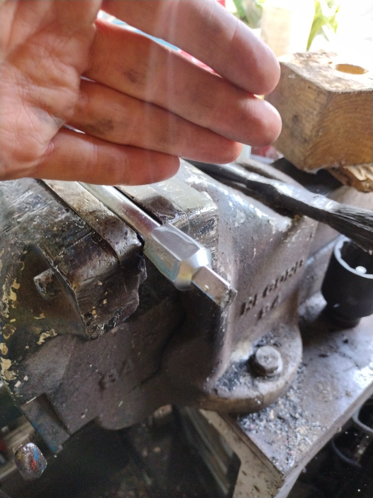

See if I can grind some flats either side of this 3/8 drive 8 mm Square adapter

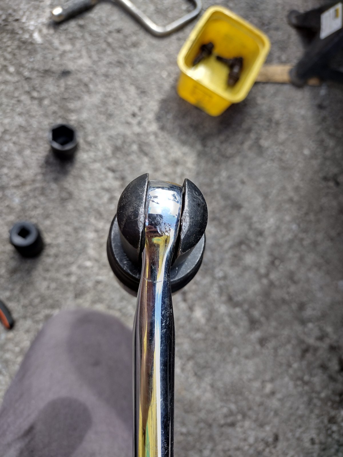

One smoking hot 17 mil drive to 8 mil Square plus 3/8 drive :)
Posts: 5360
x 2366
The guesses at 60° aren't too far off amazingly!
