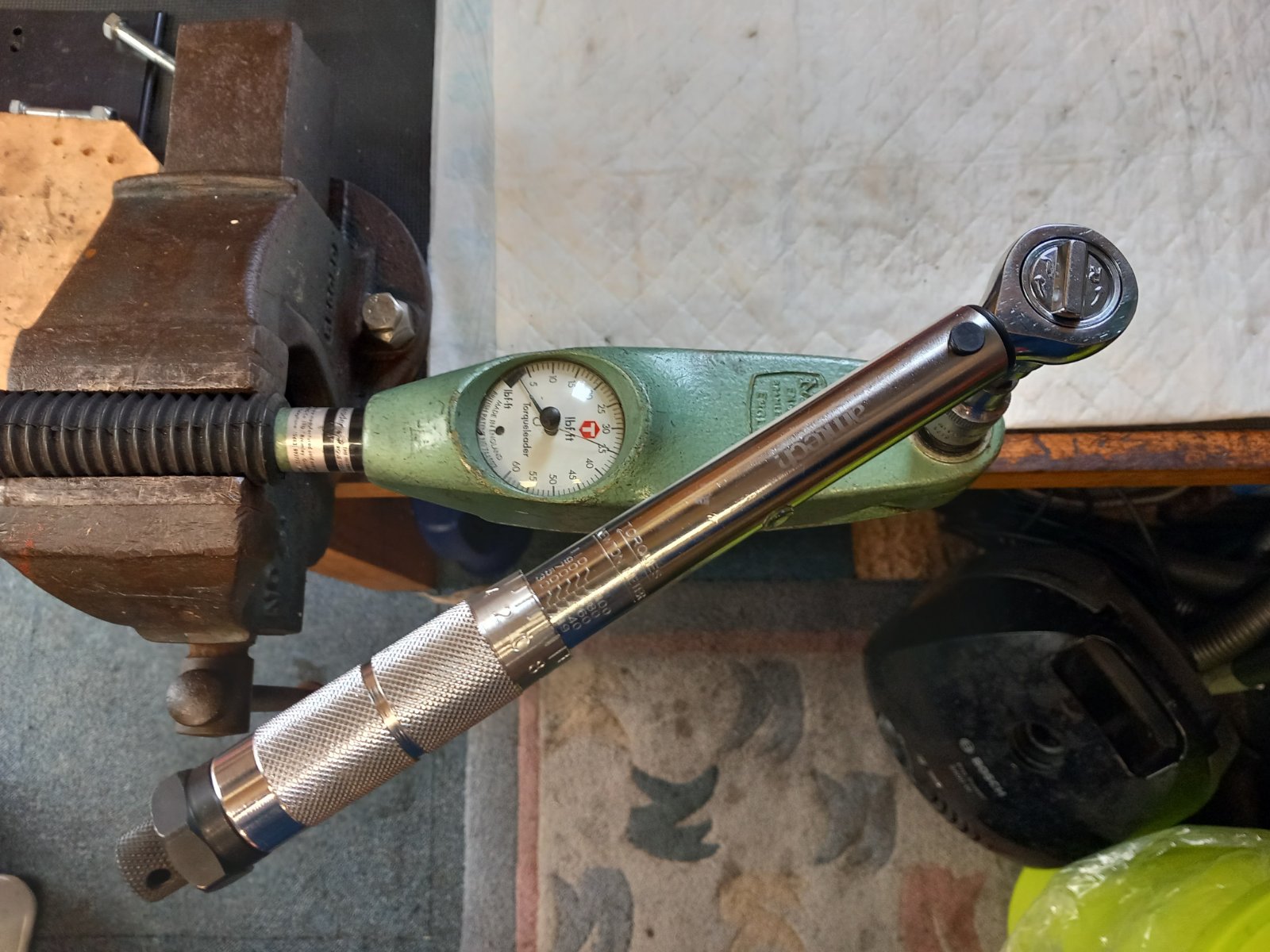

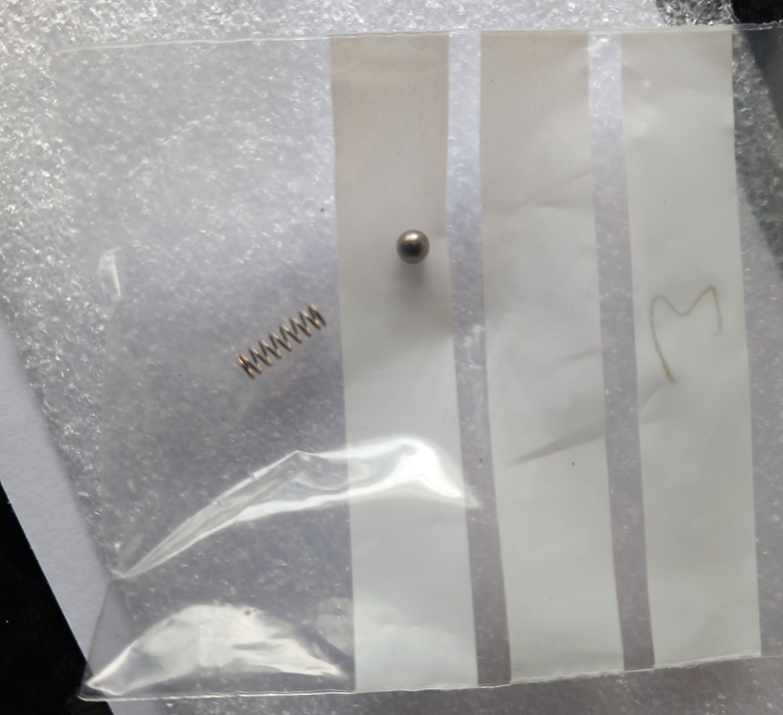

Last time Mick attempted to use his little torque wrench, the head fell to bits and exited the body... In doing so, a small spring and ball bearing went ping and successfully made a bid for freedom.
These components form part of the head ratchet assembly...
Replacements were sourced although the reassembly job had to wait until I was in the right mental place to do the job. It's incredibly fiddly and there's only one chance to get the spring and ball back where they belong along with a massive risk of 'pingfukit' occurring

Success was achieved and as the last part of the job, I checked its calibration using my test gauge.
Interestingly, this particular example of the breed is designed to only act as a torque wrench on RH threads. Turn the ratchet to L and it acts as a small breaker bar!
