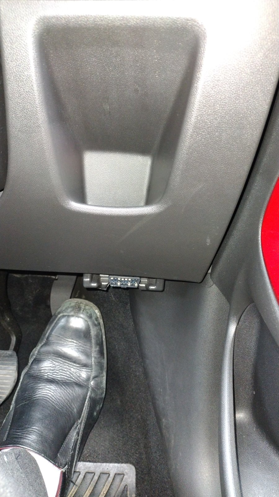

This (recent hire car) Vauxhall Crossland is perhaps the other extreme in terms of OBD port availability!
On display at all times!!

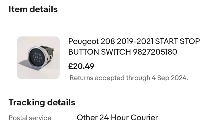

Unread post by MattBLancs »
Start button ordered
eBay
eBay
£16.39 with a voucher. Decided to try a black one in the hope of avoiding any peeling chrome issues. (Genuine, second hand. Rear connection visually same as the correct chrome faced item, so hoping a direct swap)
By the way, here's the current one:
ST {triangle} RT STOP!!
Which feels horrible under your fingertip too!
