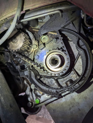

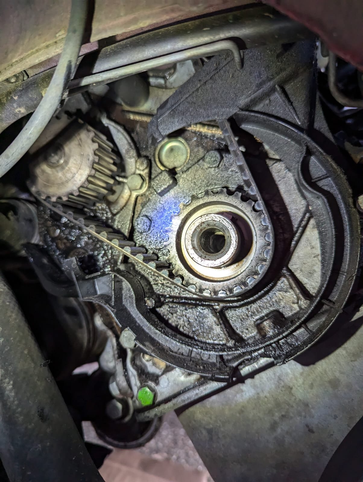

Ok, managed to get some time and good Werther at the same time.
Got the pulley wheel of and removed the auxilary belt and all the Timing belt Covers.
Turns out my timing belt is pretty loose and I think my crank seal is bust.
Woodruff key looks pretty Solid tho, no Play in the crank sprocket wheel, with belt installed.

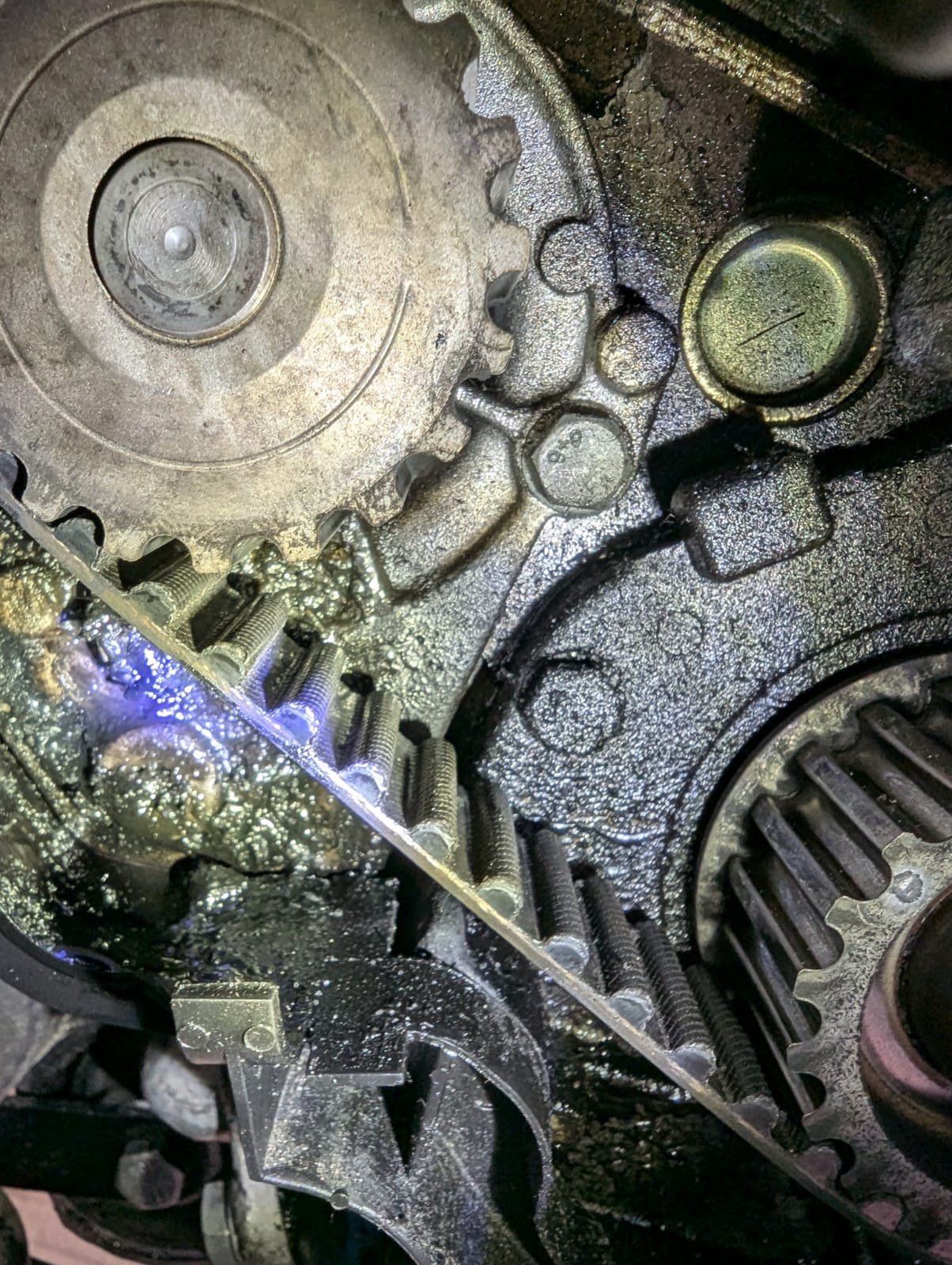

Did the cam belt, timing was Dead on.
What a tight fit in that engine bay for doing the cam belt, nearly broke my fingers, but what an amazing tipp with bending a bit of brake pipe to lock the flywheel!
Only the ever so slightest play in the crank pulley for the cam belt with the woodruff key.
Engine still runs as s**t as it did before, but that cam belt definitely needed replacing.
