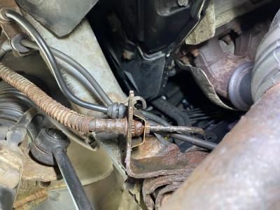

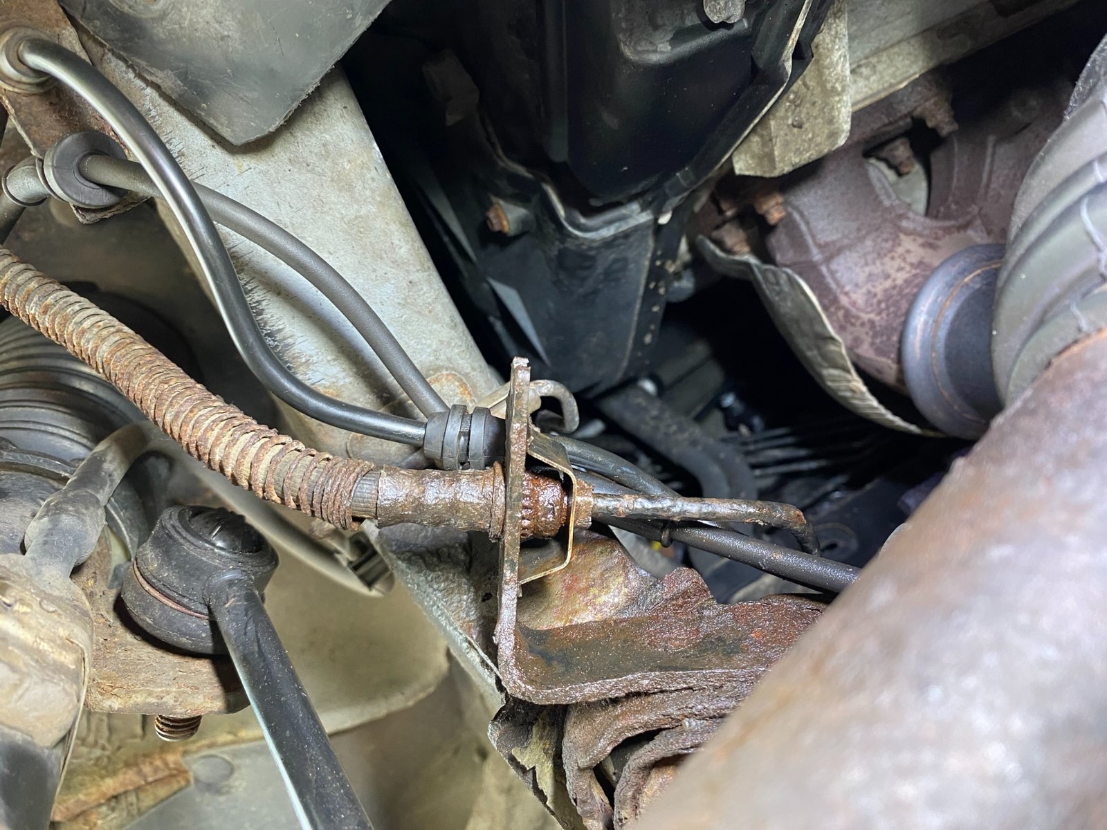

Have the new brake hoses but can't get the old ones out at the body end... #-o
Any tips anyone ? From looking at the new one it looks like the serrated edge is a push fit into the bracket then the brake pipe screws into it from the back side ?
If so I can't undo the nut on the back and can't even figure out what size it is.
It's too small for an 11 (spanner just slips) and too big for a 10 so I guess it's a rusted away 11...
I did manage to hammer a 10 spanner onto the worn side of the nut and apply quite a bit of force but it would not turn at all.
At this point I'm stumped and the car is off the road again and fit only for trailer collection or going to the scrapper as while I can re-connect the old hose it is not fit to drive any distance.

Posts: 26409
x 7163
Re: Simon's new Xantia V6 and Leaf blog
You may have to renew a couple of sections of metal brake pipe. Awkward if these are "Citroen specials" with Citroen flares and ends. If its just "normal brake pipe fittings" and pipe, easy enough to make or have made up a new pipe with the right ends on. The next joint up the line should be undoable if in the engine compartment.
Had to do this with the front brake hoses for the Micra for an MOT. Even off the car there was no way the joint between the flex hose and the metal pipe was coming undone short of complete destruction where the metal pipe and end would need renewing anyway.
I have the appropriate hex brake spanner and unlike last years struggles...there was a cunifer pipe and decent hex on the union nut. Promising. Fascinating trivia the cunifer name comes from ( copper, nickel and Iron (yes the fer bit)).
Same story as last year as it turned out. The join between the metal pipe and the flexible hose would just not undo. Sorted it by making a new pipe with new ends going from the ABS block to the flexible hose.
I came to the conclusion that because the new flexible hoses never come with new banjo bolts and new copper crush washers should such a job be required on another vehicle It would be a good idea to get some in advance.
The undoable nuts 2023 and 2024

Ok, after a couple of hours struggling tonight I've thrown in the towel, for good this time. :(
Sorry Michel, I did my best but I just couldn't get these brake hoses changed, (can't get the nuts undone on the metal pipe, although I only tried one side) and as a result a pickup and drive home is no longer an option within the remaining MOT time.
I did a quick 10 minute test drive at 30-60mph with very little use of brakes and the right disc was up to 90C and the left disc up to 115C and smelling very hot, so both sides are definitely binding quite badly due to the pistons being unable to retract properly. (And it's definitely the pistons not the calipers or pads as I can't squeeze them back in with polygrips unless the bleed valve is open to give the oil somewhere to go)
Any attempt at a long journey is likely to do serious damage to the brakes if not catch something on fire... it's fine for driving on and off trailers but that's about it.
As such I'm going to put it up for sale in the for sale section as "trailer collection only, parts or project". Thanks for showing an interest but unless you're willing to trailer it and do battle with the brake hoses and brake lines it may not be the project you're looking for.

NewcastleFalcon wrote: 23 Jul 2024, 18:05 You may have to renew a couple of sections of metal brake pipe. Awkward if these are "Citroen specials" with Citroen flares and ends. If its just "normal brake pipe fittings" and pipe, easy enough to make or have made up a new pipe with the right ends on. The next joint up the line should be undoable if in the engine compartment.
It very much looks like the same undoable nut problem here. I have no idea exactly where those brake lines run to and it's not a job I want to get involved in especially if I'm already selling the car.
I'm out. :(

Posts: 54947
x 8295
Mole Grips ;) That's what I used last time I was presented with this issue! They well mangled the union heads but it got the job done and the Mole Grips did them up again on the new hoses...
Access is not the best but with a bit of percywhatsit you can do and if all else fails, these pipes are easy to replace as they use 'normal' flares at both ends and can be made up using ordinary Kunifer pipe...

Mole grips and heat from a Micro-Flame torch..........as Jim says, the flairs are standard to the ABS block

CitroJim wrote: 24 Jul 2024, 05:28 Mole Grips ;) That's what I used last time I was presented with this issue! They well mangled the union heads but it got the job done and the Mole Grips did them up again on the new hoses...
Tried mole grips, no joy. Can't get a good grip on it or get it to turn - very much like Neil described with his.

Stickyfinger wrote: 24 Jul 2024, 07:11 Mole grips and heat from a Micro-Flame torch..........as Jim says, the flairs are standard to the ABS block
Tried it, can't do it, don't want to have any more to do with it.
Time to walk away from the car I'm afraid as it has too many problems that I can't and don't want to deal with.
