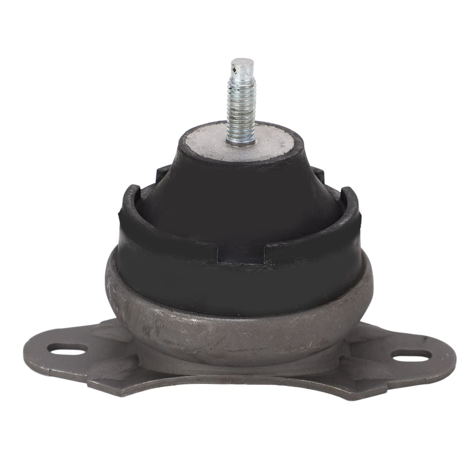

It was simply a nut on the right engine mount(pictured below) that was too tight, that way, the vibration was passing through the bolt instead of being absorbed by the upper engine mount near it. There's no need to screw the nut too tight, as the engine is on top of that platform, so it is not held in place just by that nut.

After I did this "free fix", the vibrations got better, but never really went away. I've decided to remove the mount and inspect it. It was completely worn out, so I installed a new one. The car is now super smooth, as it should be!
