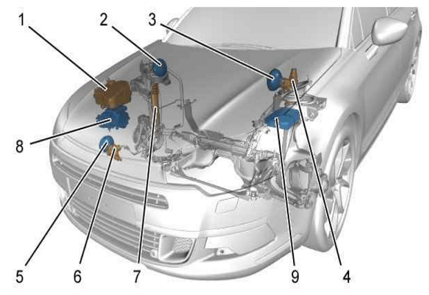

I will ask him for the exact code, but in the meantine he would like to know the precise location of the second suspension ecu which this vehicle is supposed to have in the rear somewhere.
Also any circuit diagrams pertaining to the suspension system would be greatly appreciated.

Still unsure of exact location of the second ecu. Kees, you say it's on the left side where the fuses are? Could you be more specific? Under the bonnet or in the back by the battery?
I think eliminating the comms error is key. Once we've done that the system should activate at least. If it doesn't work as expected we could then replace the original BHI.
Any pictures or circuit diagrams would be much appreciated.

(9) Variable damping suspension (CSS) ECU (dedicated to the power steering and the body height sensor).chris_reade wrote: 09 Jul 2024, 15:07 Thanks guys, I think we knew most of that. But the comms error existed with the old pump and BHI, and it's still there now with replacement pump and BHI.
The pump does at least work where the old one didn't.
Cheers
(Note: despite name, there is no variable damping (AMVAR), it's just retained the same name from the C6.
