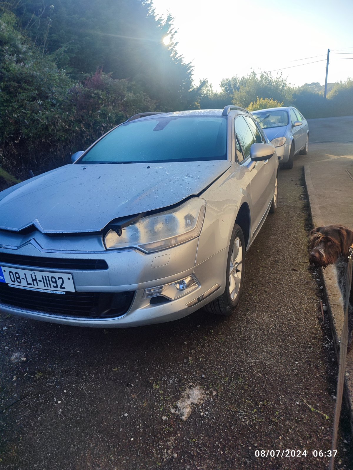

Just said I'd post a picture of the car so you can see it actually exists.

Nice to see it, looks smart. Hope you had some success soon.
