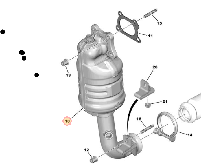

(10) Catalytic Converter, OEM, Part: 9672883980, £989.41
Can't help with non-official part numbers.
x 3565
Re: C3 Which Catalytic Converter
Ta for that, Marc. It confirms that - theoretically at least - both the 'cheap' and 'expensive' cats are suitable, so I ordered the 'cheap' one and it'll be delivered tomorrow. :)
