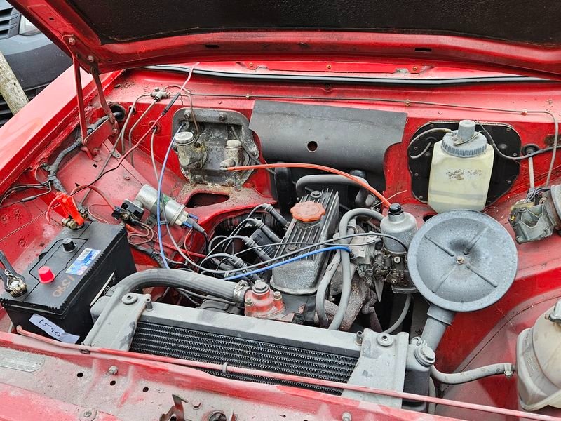

Remember when car maintenance used to be easy?
- Posts: 6847
- x 3565
Re: DIY Car Maintenance with function over finesse!!
Someone's left a saucepan with a lid on it on the right hand side of that engine bay.
