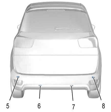

Re: Parking Sensor Fault
So in this case to clarify, this will be number 6 on the diagram
(6) Interior left rear proximity transmitter sensor
The whole system gets deactivated if even one sensor is faulty.
