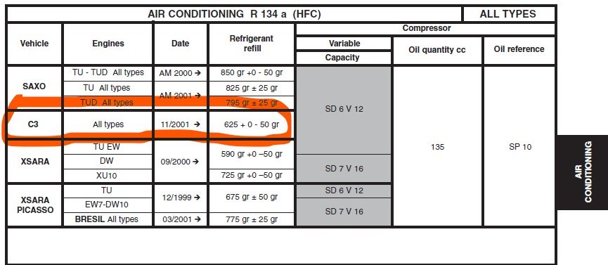

I have another question, what amount of air conditioning refrigerant must be added to the installation for this model? The service guy put 500 grams in my system. The air conditioning compressor is new, the radiator is new, the cooling fan runs on both speeds but the air conditioning compressor starts and after a few seconds it stops then starts again and stops, I thought maybe it is not the correct amount of added agent

Hi, I need help. I can't find the sticker indicating the refrigerant charge either. I replaced the compressor, but it's still not cooling at 100%. I don't know if it's undercharged. I have a Citroen C4 Grand Picasso 1.6 HDI. Can you help me

According to this chart it needs 450 g of R134a but if it also has a rear evaporator it uses 675 g.
https://www.nrf.eu/nrfcontent/uploads/2 ... 0_2024.pdf
Probably better to give any more replies here where more info is given on the problem viewtopic.php?p=873585#p873585
