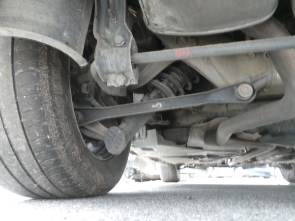

best picture i can find has the coil, not the hydractive

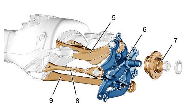

When installed in the C5 and sitting at normal ride height, what is the approximate angle of the shock to the long #9 lower link? (looks 45°ish)
What is the length of that number 9 link from center to center of the mount points? (maybe 300mm ish?)
How far inboard from the number 9 link outer eye is the shock mount center if you draw a line up from the shock eye to the link bar how long is the short end of the link? (looks something like 50mm)
I'm trying to calculate what the shock extension to suspension height relationship would be. For example if it is 45°, 300mm, 50mm then each 2 units of shock extension will get 1.2 units height change body to wheel.

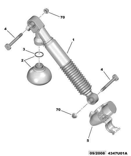

Here is a drawing of the rear strut/cylinder...
Now to burst your bubble............sorry, but I think you are thinking that it is all down to the strut and the sphere, these really are just parts of the working system.
The reason the Citroen suspension system works is because it is complicated, valve blocks, height sensors, electro control valves, even the internal diameters of various pipes to control flow etc. Add to all of that the method of control by the various ECU's which is milliseconds via the electric solenoids on the valve control blocks.
ALL of that is needed to run a system that responds in the way it does, none of that is remotely possible with the relatively simple and slow valve control of an Air-Bag type control unit. I also suspect that such systems would also not work, even explode, under the very high pressures required in the Citron systems.
"Sphere gas pressure" does not control ride height, spheres control the shock absorption rate by both gas pressure and the sphere neck valve/bore along with the fluid. Height is controlled by the (to simplify a lot) the amount/pressure of the fluid in the system and this is constantly adjusted by the valve blocks releasing it from the pump/accumulator part of the system. Fluid return is also controlled via these valve blocks.
You may wish to consider a more analogue system using earlier types of the suspension.
