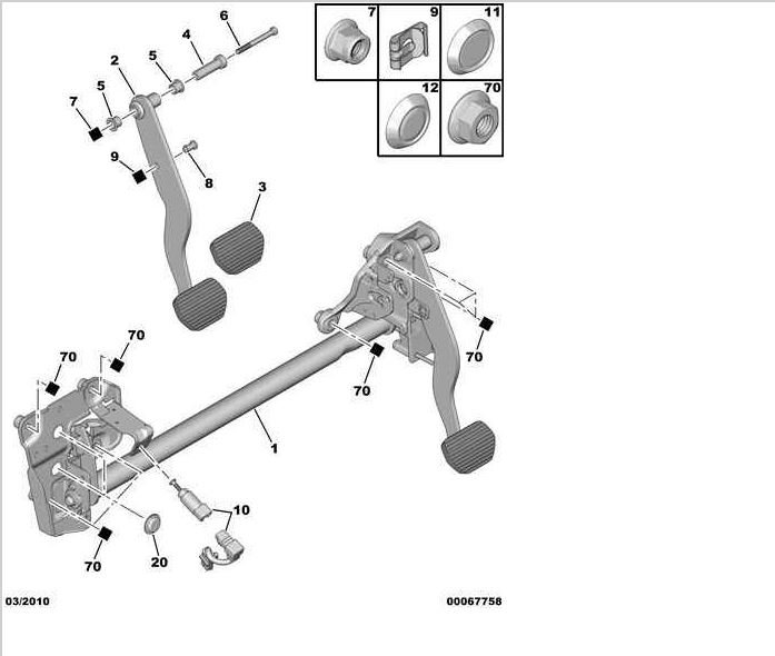

Ok I’m a bit confused here.
All I can see under the dash is a wire going to the throttle nothing on the foot brake, am I missing something?
Is there a difference on the later c5 this is 2015 exclusive.
Taken a pic but cannot see how to send it.
Posts: 11783
Joined: 28 Mar 2013, 21:05
x 1968
Re: C5 brake light switch.
Unread post by Stickyfinger »
Part 10, on the passenger side on RHD cars

Thanks for that, so the switch is on the passenger side?
Posts: 42019
x 6955
Yes for Right Hand Drive vehicles as you can see in the diagram above.
