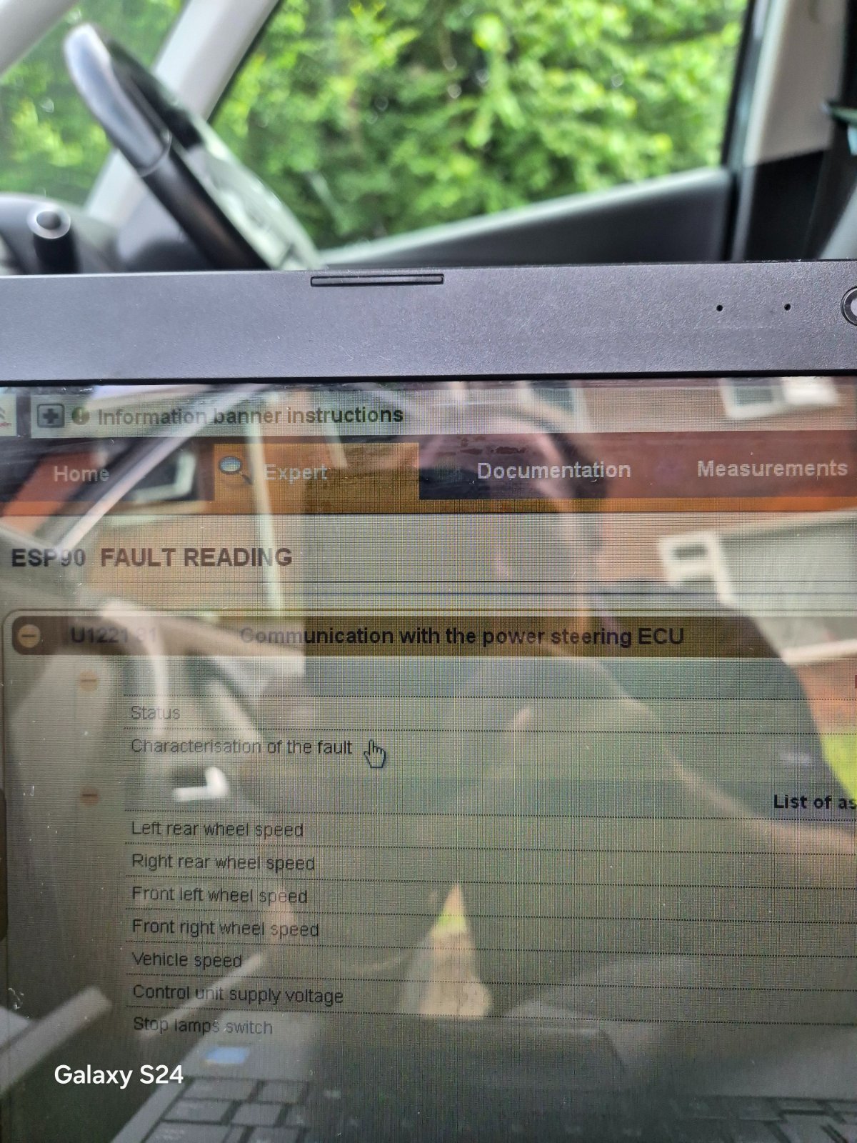

Hi all I hope someone can advice how to resolve this.
I have replaced an electric steering rack in C4 MK2 1.6bluehdi with second hand one and have an fault code U1221 81 stating ''No communication with power steering ECU'' I have used latest lexia diagnostics so believe the code must be correct.
Can someone advice if the new steering rack needs to be somehow coded or calibrated?
Any advice would be much appreciated thanks

| Fault Code: | U1221 81 |
| Description of Fault: | Communication with the power steering ECU: Data invalid. Value received invalid. The time for recording the fault code is 100 milliseconds. |

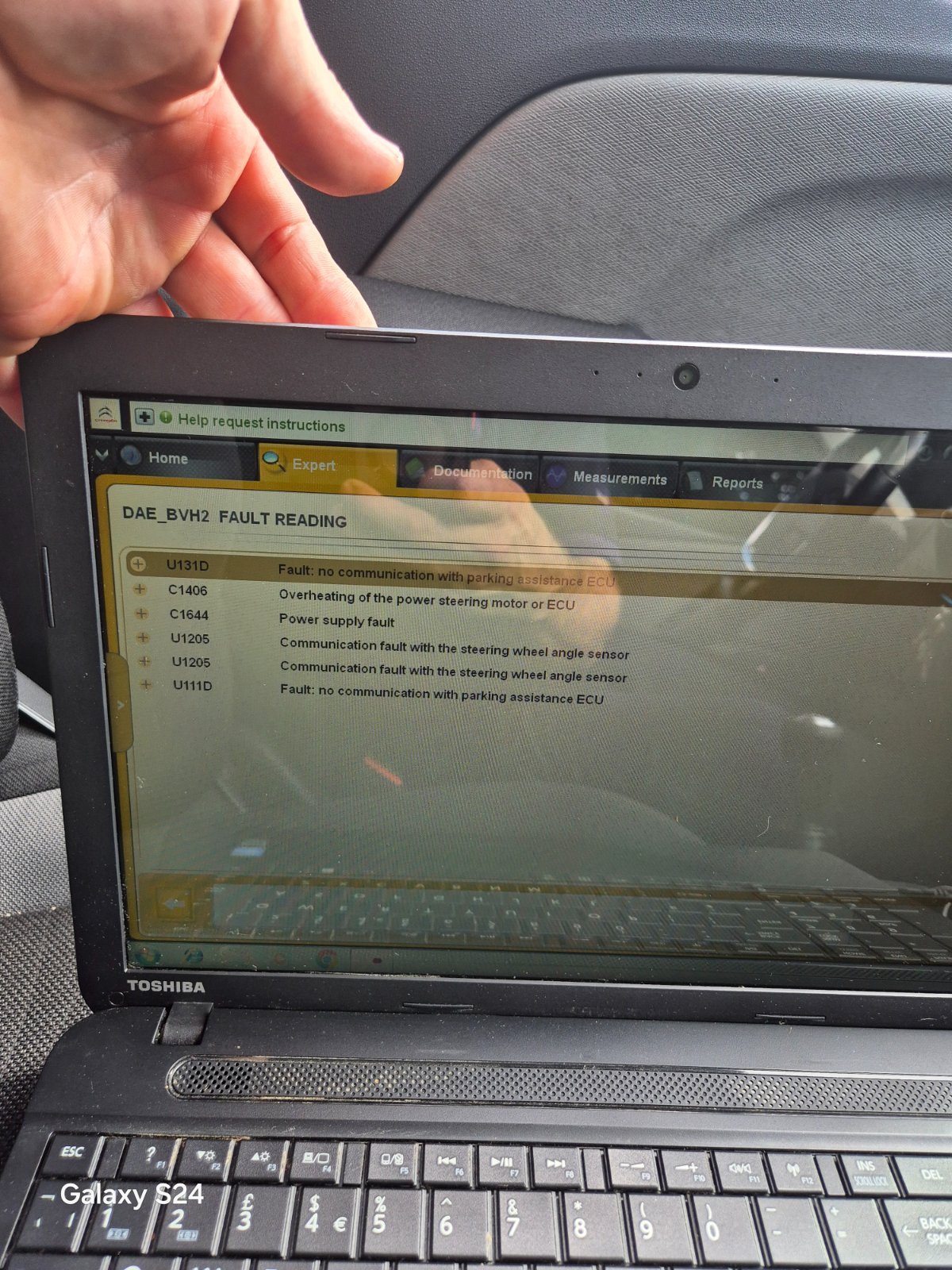

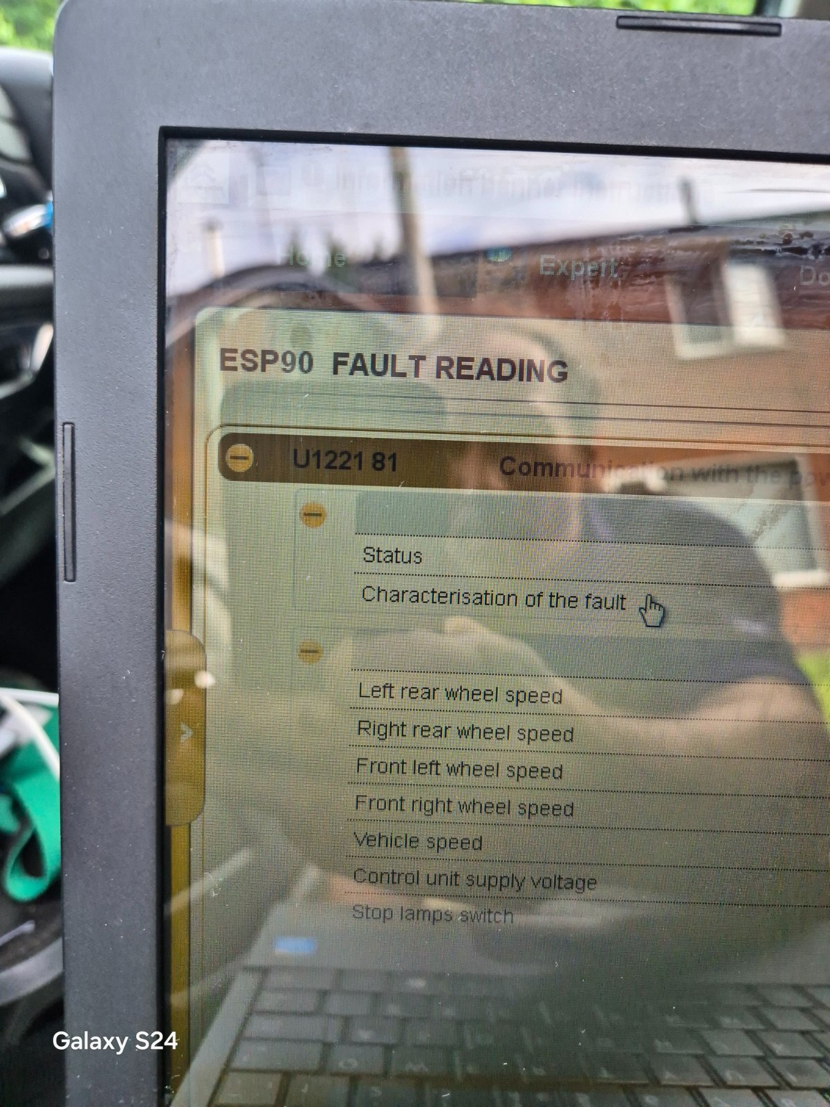

Does the new rack need to be programmed? As when tried to calibrate wheel angle sensor it woudn't let me, any idea?
When gone to the steering whell ecu this are the faults ( see picture)
Do I need to remove the old rack ECU and stick it back on the new one or there is a easier way surelly.
Any advice guys would be really appreciated.
Thank you.
Thank you.

That's why I asked if you had replaced it with the exact same part number from the exact same vehicle as it may well be configured differently. Yes they do require calibration if removed / replaced.
If your vehicle has semi-automatic parking assistance, then it will have an absolute steering wheel angle sensor fitted, as well as the standard steering column torque sensor. This is because when switched on, the power steering ECU has no idea with a torque sensor alone what position the steering wheel is at for leaving a parking space, so requires the absolute angle sensor located int he steering wheel.
As far as I can see, you don't have semi-automatic parking assistance, so won't have the steering wheel angle sensor, just the torque sensor. So this may be why there is no communication with it.
If the donor unit is from a vehicle that did have the semi -auto parking, then of course it will cause problems when fitted to your vehicle.
Also, are you 100% sure you haven't bought a broken unit.....

The photo doesn't show communication with power steering ECU it says no communication with parking assistance ECU. Or are they the same thing?
- x 6957
Re: No communication with power steering ECU after replacment
Parking assistance ECU is separate, but the point I was trying to make is that the donor ECU may be configured differently for a vehicle with semi-auto parking, which will have a separate steering wheel angle sensor to operate in addition to the normal steering torque sensor for models without. So everything is inter-related as the Parking ECU gets it's data from the ESP ECU concerning the steering angle sensor, which won't be fitted on vehicles without semi-auto parking.
This may be why there are some anomalies if the existing configuration is set for options that don't exist, so is not getting expected data.

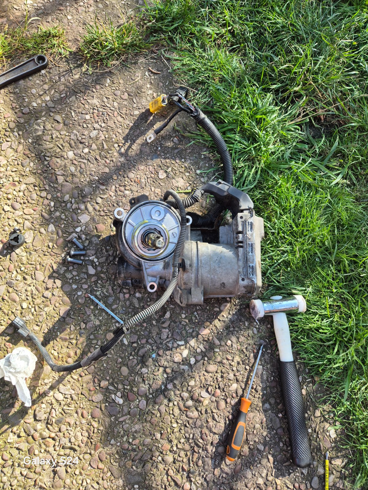

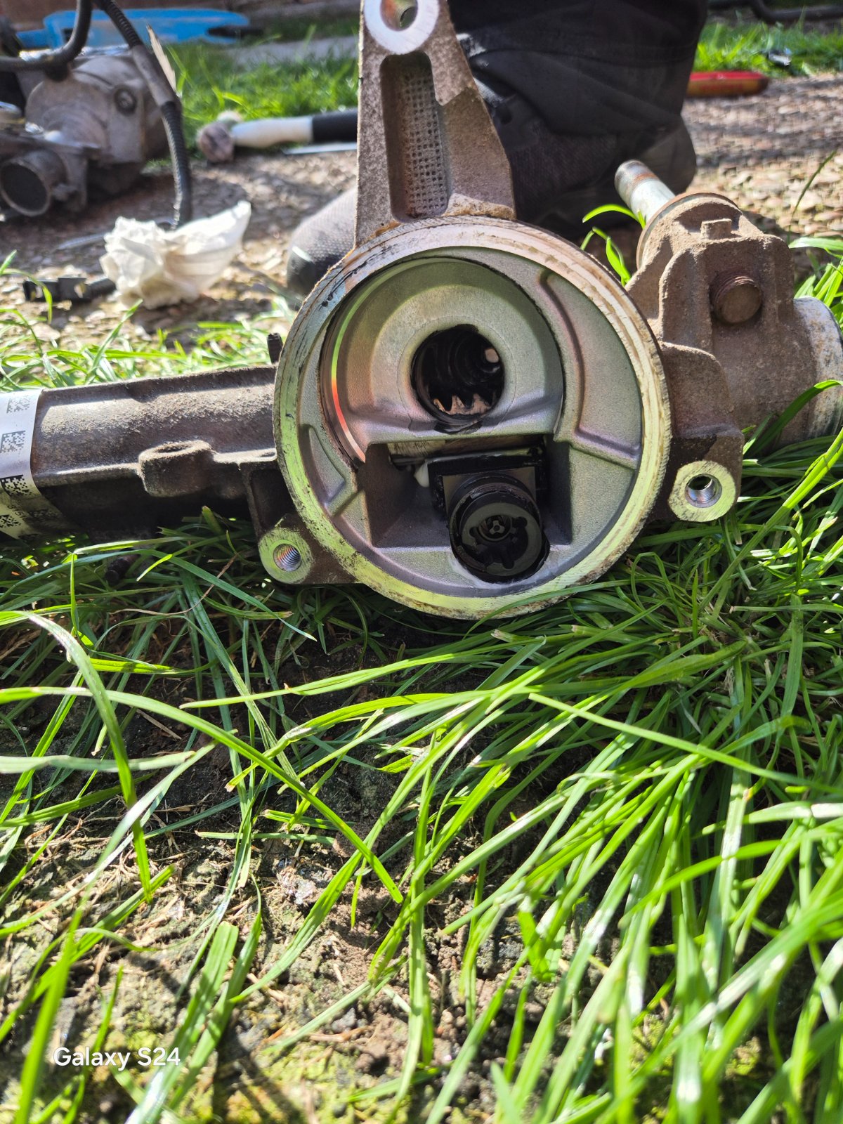

I have finally found the cause of steering rattle/play, its the rack tensionner under the motor as it has a lot of play on one side, managed to remove the motor and ecu and hopefully once swapped there should be no issues with communication.
Here is the youtube link with the video of the rack play on the tensioner under the motor for the guys having trouble finding the worn part.
the rattle was present on small uneven road , I have replaced all sunspension parts and typically the most expensive one was the cause of it
