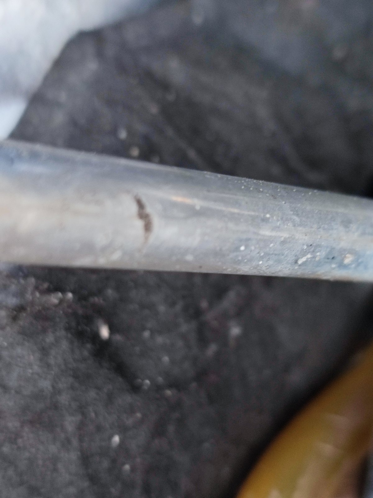

Yeah same here but it will be afternoon before I get out of work and the evening doesn't look great weather wise. The rest of the week looks like a wash out. I'm dreading putting it back together it's tight up behind there and no way of really freeing up space. Any tips on aluminium pipe with a small crack in it. It's the high pressure side of the AC. I was going to try and solder it but I have been told it probably won't hold. I wouldn't trust epoxy to last so I'm thinking I need to cut it and use a compression fitting to join it. I don't think a braze would take either.

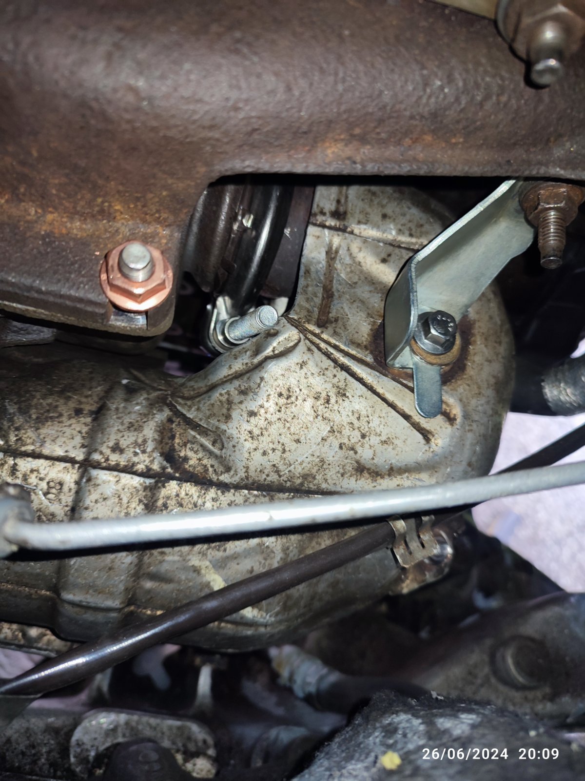

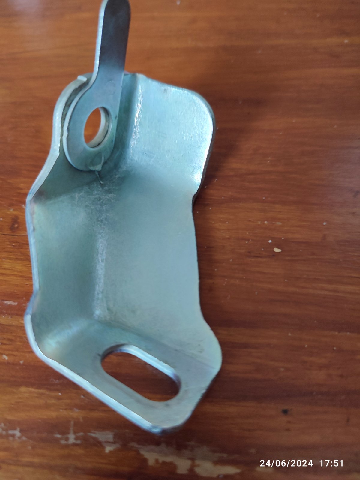

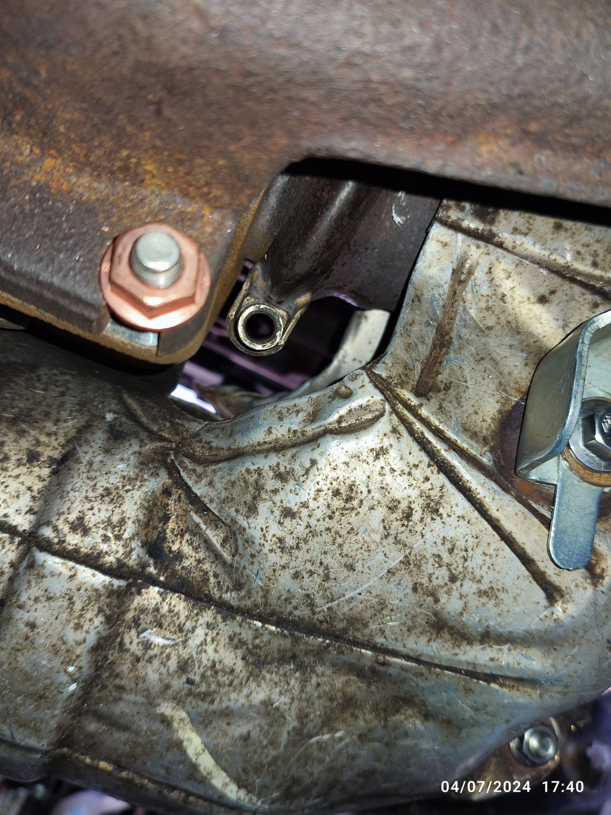

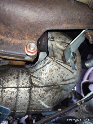

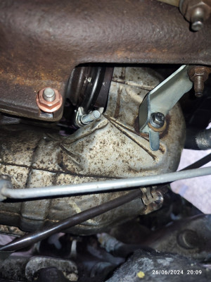

Hi Lads I got the new turbo fitted but the pre-cat is an absolute rhymes with mustard. I can get the cat in no issues it's the clamp that holds it to the turbo that's the problem. It is stuck in between the heat shields and I can't get It to spread enough to capture the flange. I have ordered a special pliers but it won't be here till Monday at the earliest. This is the bracket I lost and here it is in situ. I will post pictures of the new turbo in place later on today and where the pre-cat clamp lives you can just about see it in the picture from above but I can only see it from this perspective from photos with my phone

Re: Injectors misbehaving but trying to understand the numbers

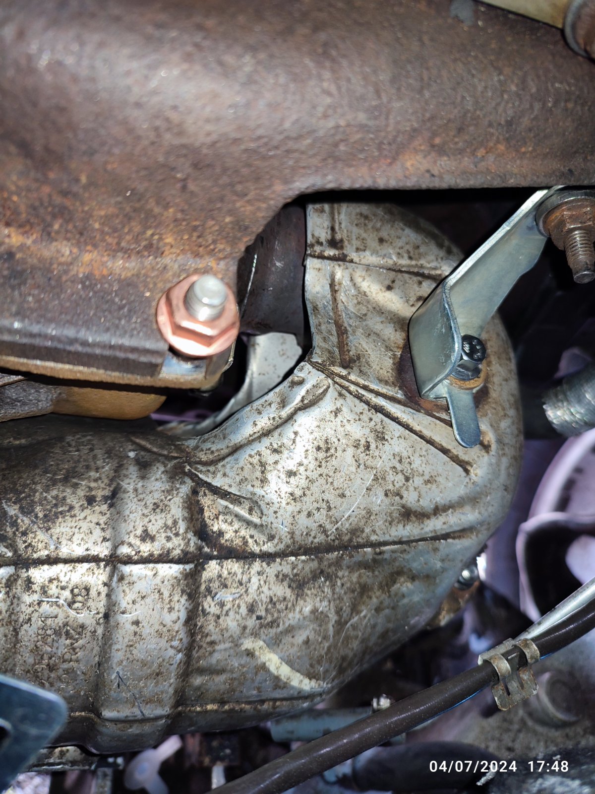

Hi Lads got the clamp to seat correctly finally. It's an absolute pig.A couple of photos of the new bracket and the clamp in position on the pre-cat literally just got it to sit right this evening. I bought a clamp pliers specifically for the job and it struggled as well but I got it on and decided to call it an evening. I'll put the rest of together tomorrow and get a few more pics. I'm off this week so getting a bit done. I was busy levelling my back garden and digging a driveway across to a garage that I am finally getting around to completing which the previous owner of the house had started. Not a great structure but I am improving it as best as I can.

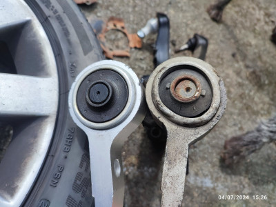

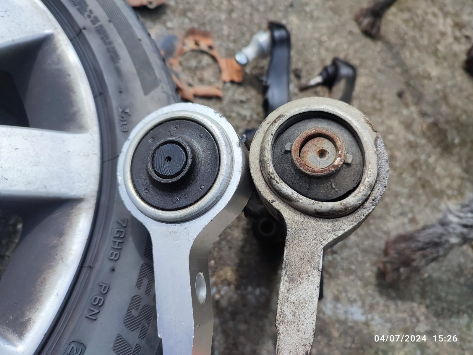

I discovered this on the primera yesterday might have something to do with the shopping trolley handling I was changing it out because the ball joint was iffy just easier to change the entire thing.
Darren

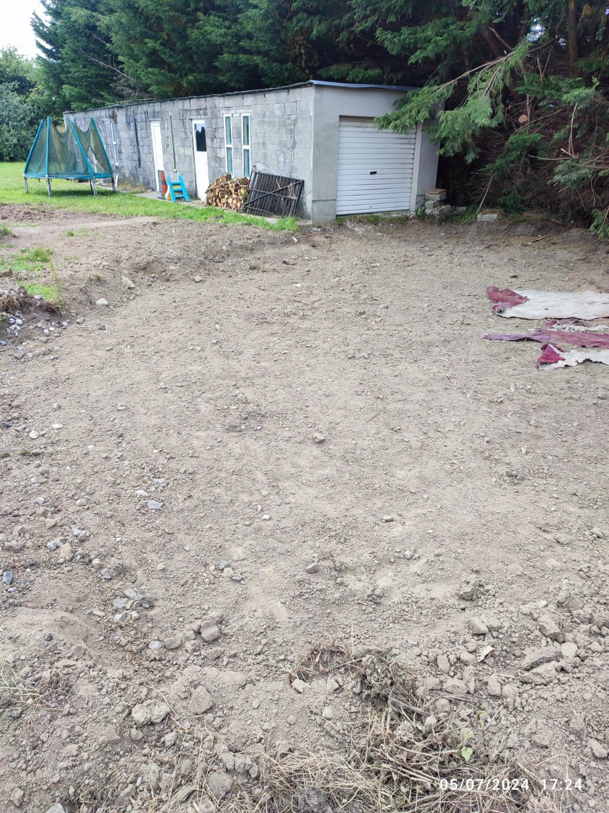

Exhaust reattached and the pre-cat lower bracket turbo outlet pipe reconnected as well. I've to go out for dinner so won't get back at it tonight. This is a picture of my driveway/concrete pad hole so far
. The kids old trampoline makes the walls look pissed but they are actually relatively plum. The leylandiis are next on the hit list.the guy that owned the house before me planted them I absolutely hate them bane of my life.
Don't know much about Primers but that sure doesn't healthy to me!
Good progress on the driveway project too.
I'm sure Leylandii are really good for something, not sure anyone has discovered what yet. Best thing I've found them for is a new found appreciation of seeing the sky! (Once they've been flattened!)
