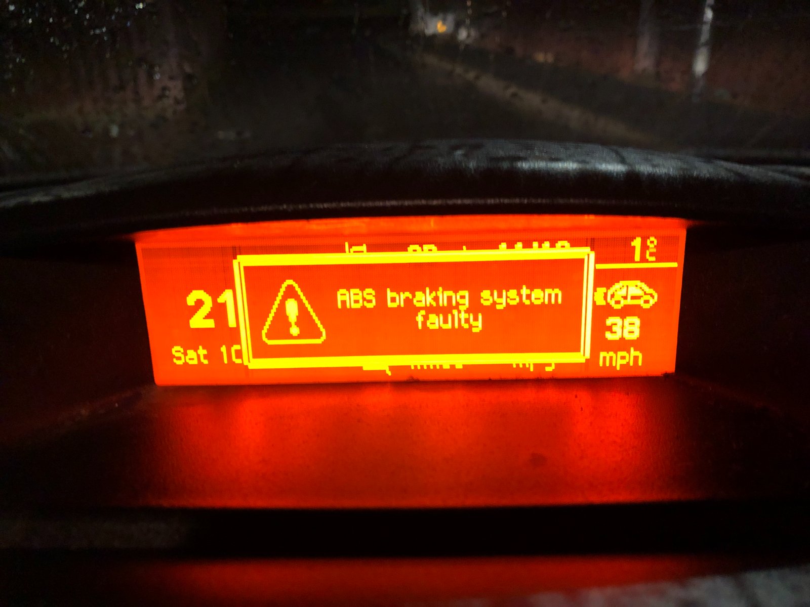

I have an odd problem with my Berlingo Van (Berlingo B9 , 2015, 122000miles)
One day it decided that there are an ABS and ESP/ASR System faults.
Plugged in the OBD reader to see what all the beeping messages was about and came across the following codes…
P0571 – Intersystems CAN. Brake pedal position information sent by the built-in systems interface.
C0040 – Brake Pedal Switch fault: Coherence with the pressure sensor: Coherence.
P0571- Checked operation of brake switch with ODB reader, interestingly they are two detected by the OBD reader Primary and a Secondary – the Primary changes state when pedal is pressed and released, the secondary shows as pressed and doesn’t change its state – quite possibly a duff switch. – yet to confirm if this is normal on a similarly spec’d and age van, which I do have access to. and need to find a moment to visually inspect the switches.
C0040- This could be related to the above fault, but I’m not sure which one is the root cause of the issue. upon inspection of the brake pressure the van reports that there is a constant 30 Bar of pressure on the brakes when idle (not pressed), this increases when the brake pedal is pressed and when released its settles back to 30 Bar. On the other “working” van the pressure sits (when idle) at 0 Bar.
After finding the pressure oddity between the vans, we were suspicious of my vans ABS pump/block which may be at fault.
We handed the van to a Garage to have a look over the issue to confirm - They came to the same conclusion, the garage sent the ABS Pump/Block away to a service centre who repairs, re-conditions and tests them.
However, when the pump returned and was refitted to the van the fault remained. The garage spoke to the pump repairers, they believe the issue is elsewhere in the van as the pump had a clean bill of health. The garage had a go over wiring and earth points to no avail. The Garage then threw in the towel as this was becoming not economical to continue. – fair enough!
With the age and mileage on the van, you would expect things to misbehave. With this issue it will not pass an MOT with ABS faults on the dash, and I feel it’s a shame to condemn it because of it.
So… what do you think?
Cheers
Pedro
