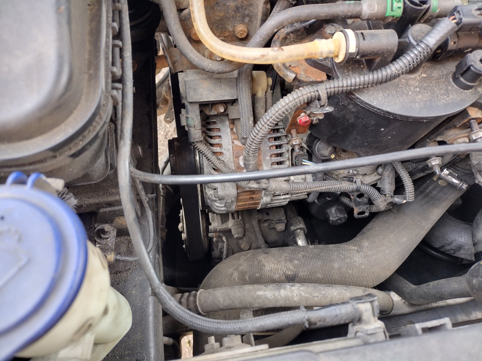

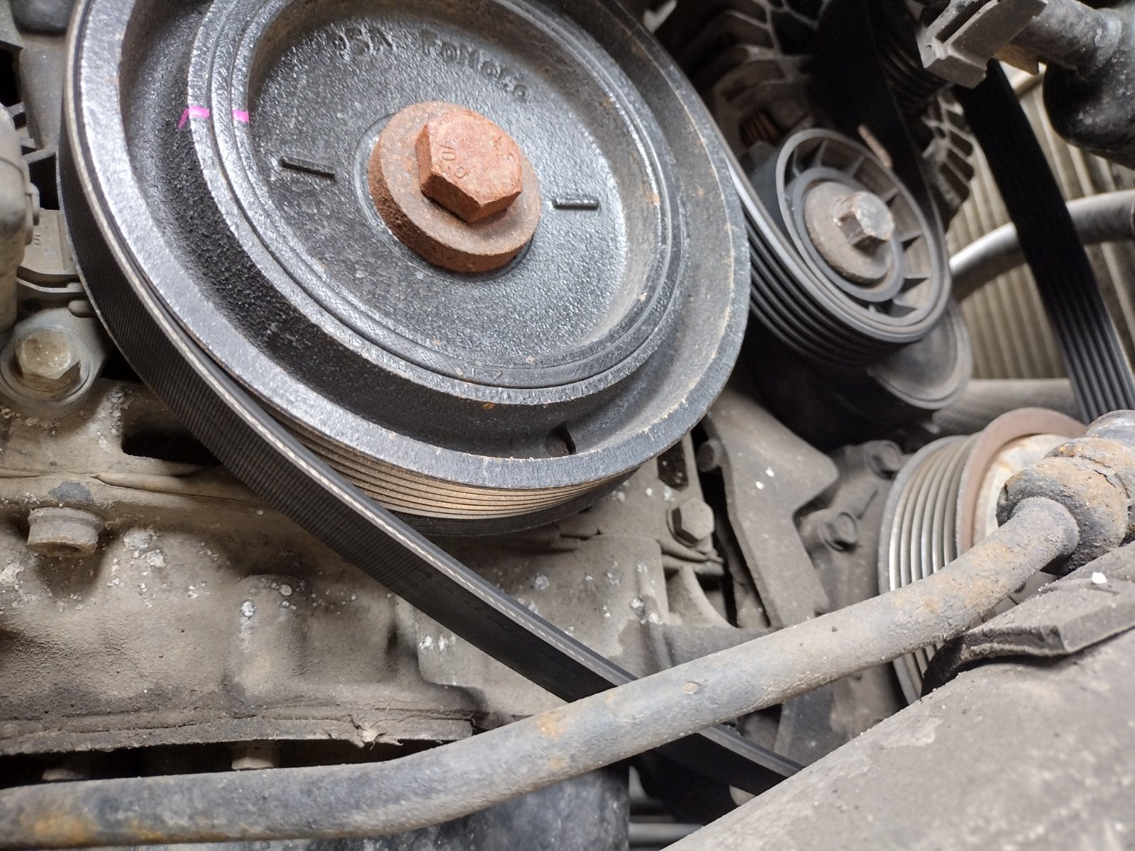

Today's job was sorting out the awful racket the C5 makes, for a good while it's had a drone particularly noticeable at idle and over time it's steadily increased both in volume and irritation factor.
Suspects were the alternator bearings and the belt tensioner's idler pulley. Though the later was a new item put on the car in my ownership - hence still pretty much brand new to my mind!
And the answer was....
... Both!
Alternator bearings very noisy, dry sounding.
Pulley bearings noisy, very very free running.
I'd bought a second hand 180 amp alternator a good while back (the one with the dented mounting lug if anyone can recall) and that's sat on the shelf for a good while. In fact I'd lost it but eventually looked into the correct anonymous cardboard box in a place I'd forgotten car parts were hiding.
The pulley, I'd kept the old pulley, machined the plastic away a touch on the lathe and pressed in a cheap new 6203 ZZ bearing a while back. Stuck in place with picture from memory. Why, you might get ask, did I do that all those months ago? Because I wanted to see if I could fix it!
So this "new" replacement installed. Tip for others:
- tensioner is conventional thread (not an anticlockwise item like some)
- tensioner locking pin hole does NOT tolerate the torque applied undoing said pulley bolt
just a out usable still but hanging on fairly feebly and the fear of it coming free with my fingers in it more present than usual!
A few pictures:
... Both!
A few pictures:

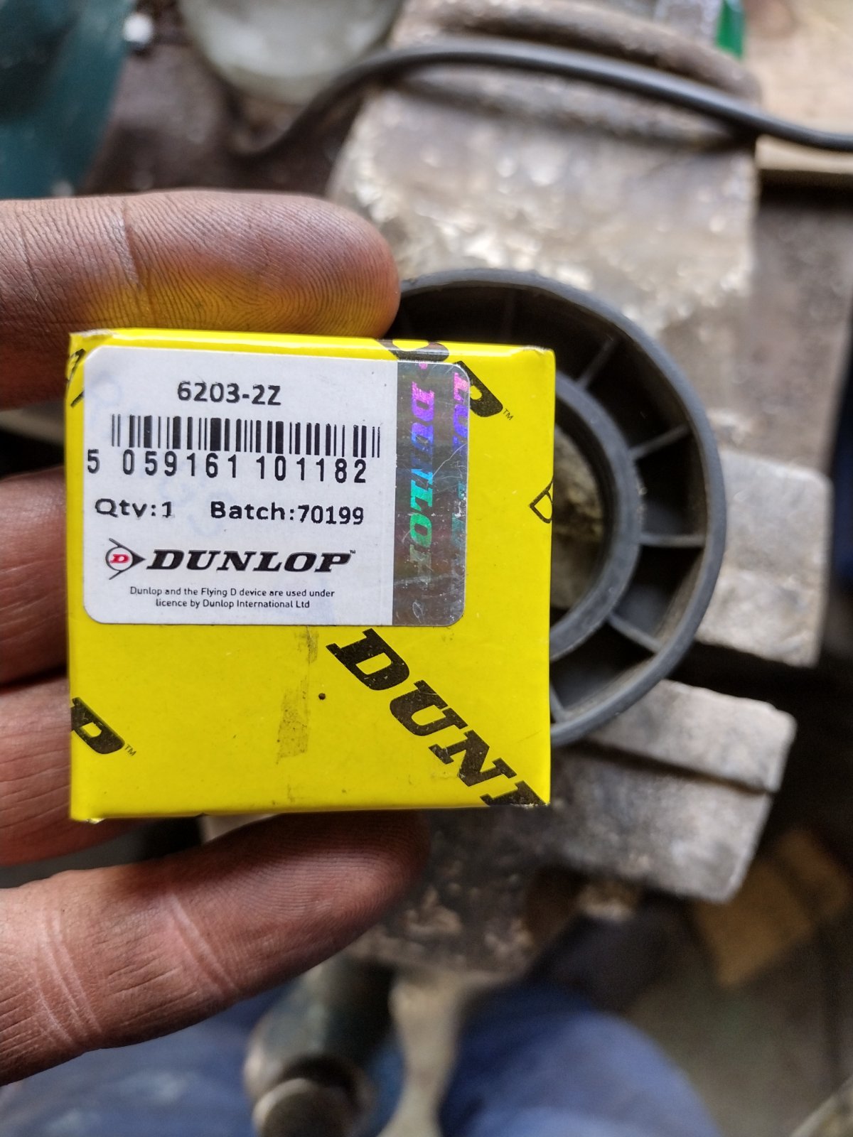

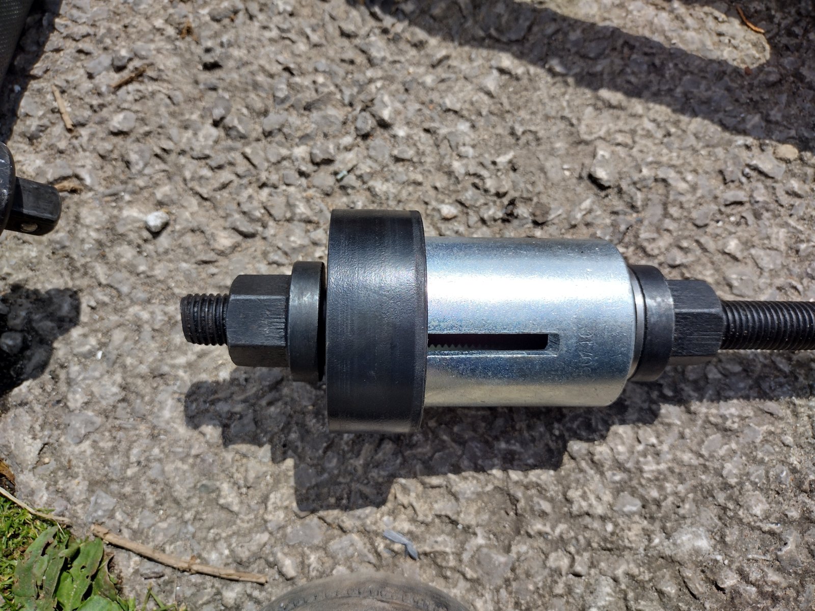

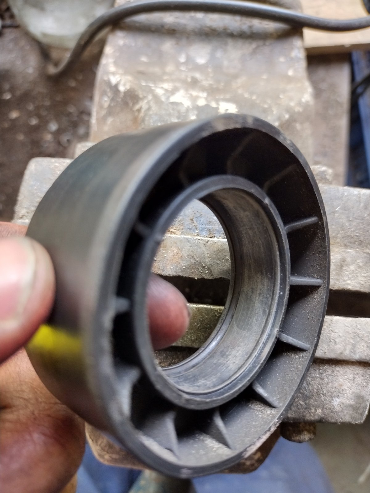

Here's a few of the pulley bearing replacement job:
New pulleys were about £8 (but as I've found out, don't last!) new "Dunlop" bearings were about £1.50.
The old pulley that came off has had a new bearing fitted (hence pictures from today) the one just gone on the car was subjected to the same a good while ago.
Decided to try the metal seal ZZ rather than standard two rubber seal variant. Makes it easier to see in future if it's one I've fixed that lasted a reasonable amount of time if nowt else!

Well apparently.... the Dunlop brand bearings name is now owned by BTL-UK ltd (Bearings Transmissions Linkages) based in Kent. An awful lot of other Dunlop branded stuff has been sold off and re-acquired by various companies around the world. Dunlop were responsible for quite a lot in their day, but now various multi-corps seem to own the name to the various sectors.
- Posts: 5306
- Joined: 25 Apr 2022, 09:03
- x 2337
Had a bit of a googling trawl after tea last night, it's fair to say it hasn't filled me with confidence over the quality of Dunlop / BTL bearings! But will wait and see for myself. Perhaps the latest repaired pulley can come along for ride in the boot for the moment.
