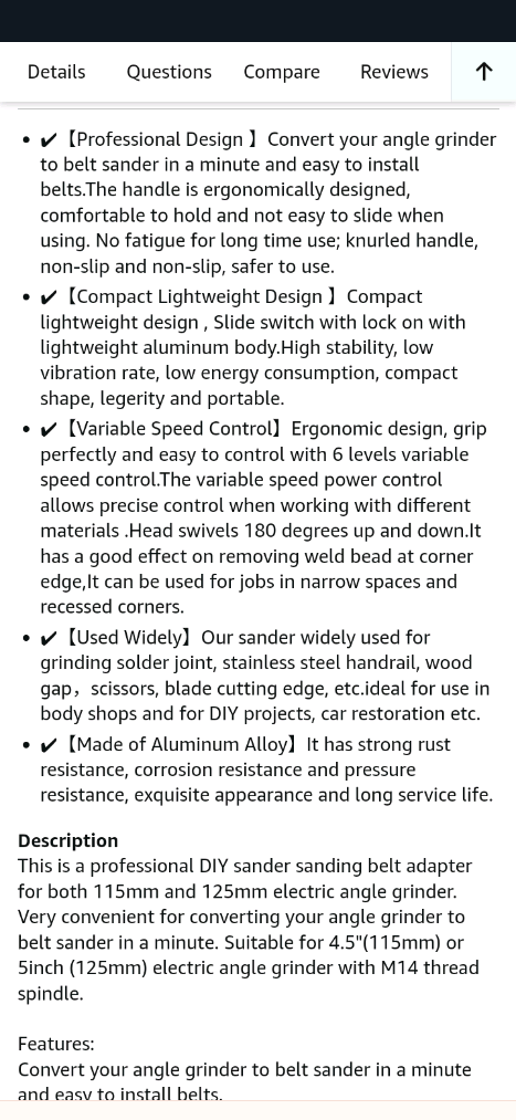

Up to you of course Ryan, but I think I'd find that set up too cumbersome and heavy for the delicate work you have with surface rust. A finger sander is much lighter to work with than that attachment will be on your angle grinder!! Just saying

I play with blades upto 2 metres on a track saw, angle grinders upto 12 inches, ring saws and dragon saws that can cut upto a foot deep by hand, concrete cutting chainsaws... don't even get me started. I think I've got it covered on the strength front. Just not sure I can be that delicate with a finger sander. I'm more used to hold it for dear life than be delicate......

Yes I have no doubt you far exceed the strength requirement, it is more the precision of control to ensure you don't make matters worse that I was getting at. That attachment will have its tip a fair distance from your controlling hand meaning a greater potential for bouncing on the work when it catches a jagged piece of rust. I'd just advise having a practice on a piece of scrap metal to get a feel for it.

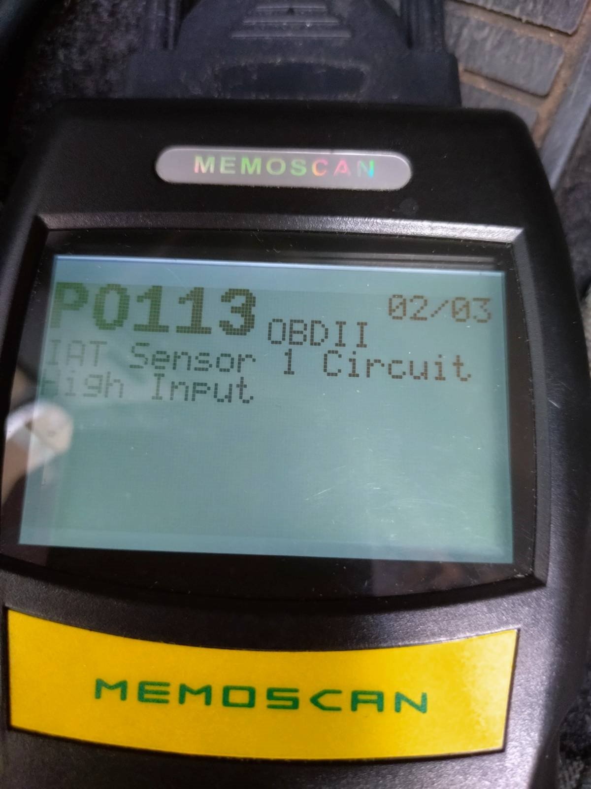

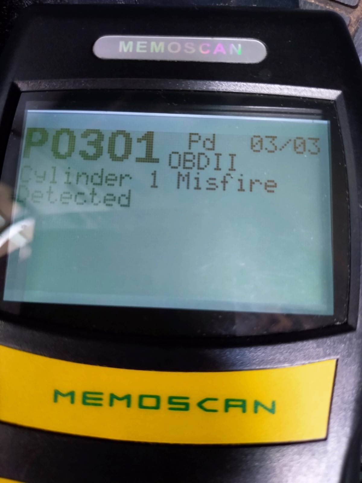

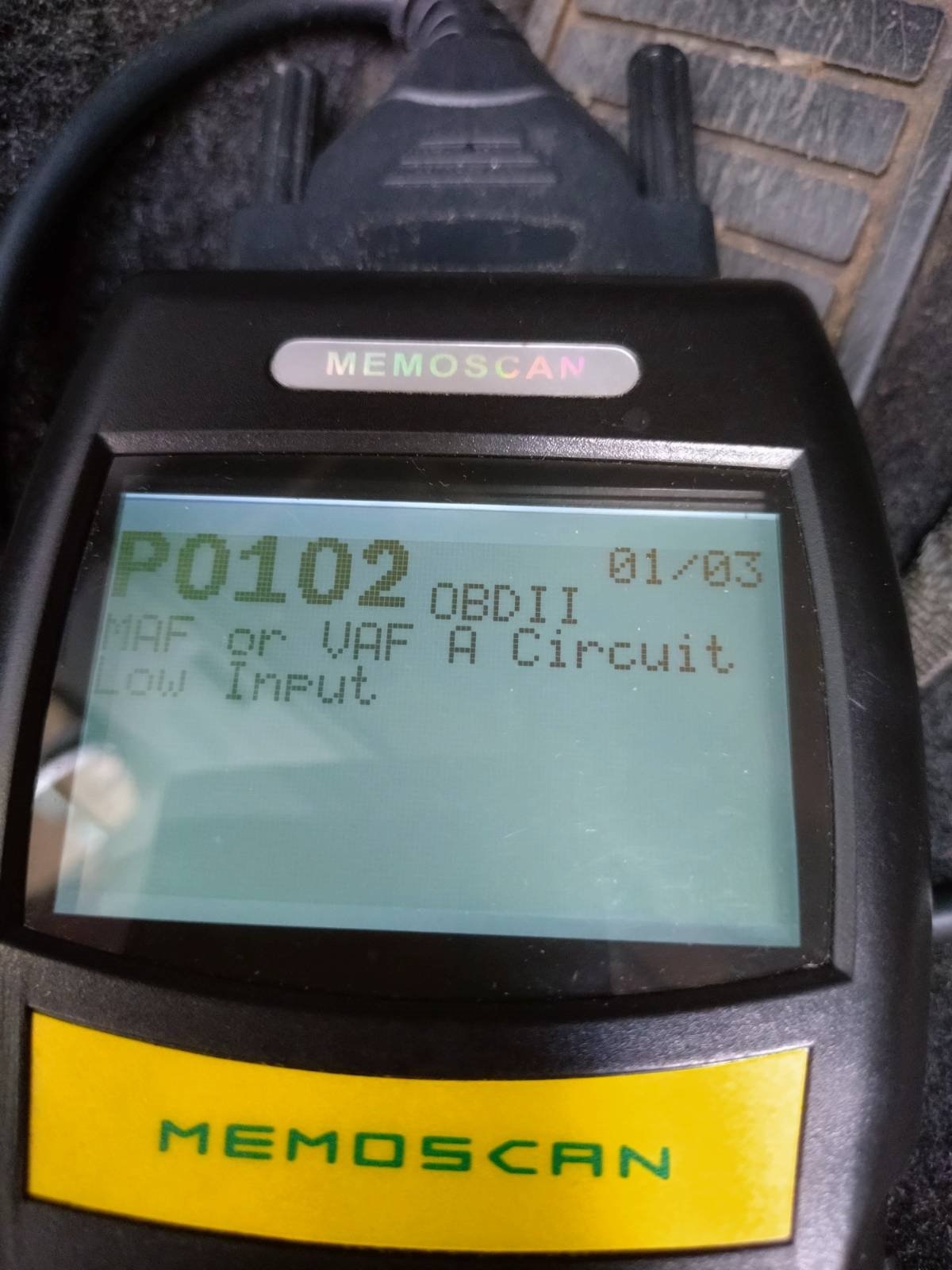

Further to my attempts to cure my intermittent misfire at tickover under load as discussed here, I'm sorry to say the issue has started again and if anything is a bit worse. In addition to happening when idling, with say the A/C on, it has now started happening when you go back on the throttle after having the car in overun, down a hill for example, which is getting annoying. So I thought I'd have a general look and read the codes if there are any. I got out my code reader and set it up to reveal three codes:
So having replaced the plugs a couple of months ago I am going to check number one thoroughly and the identified sensor connectors as a start and see what happens!!

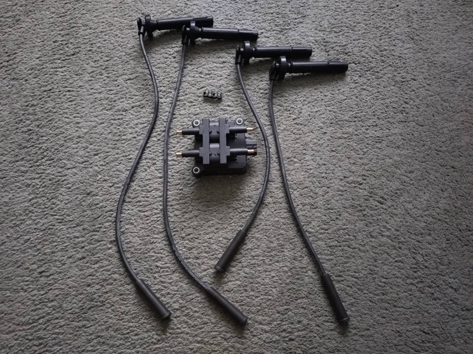

Re: DIY Car Maintenance with function over finesse!!
The PCV valve is on the way from Japan but in the meantime I decided to eliminate the other possible contributers to the problem and ordered the parts shown. With F1 and Footy today they will go on in the morning and ready for the off to Germany on Monday!
