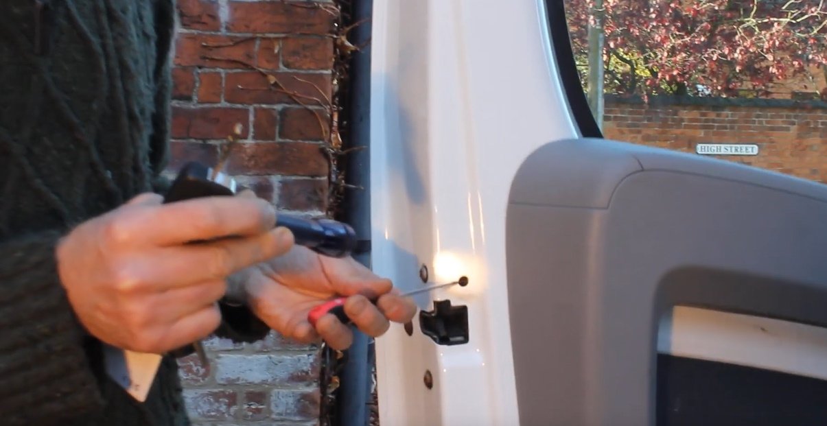

On a side note, we got the passenger side to lock manually, using this video from YouTube:
In case it disappears: there is a little hole above the door handle, where you can flip something like a switch. Then after the door from the outside it will be locked. A screenshot from the video:

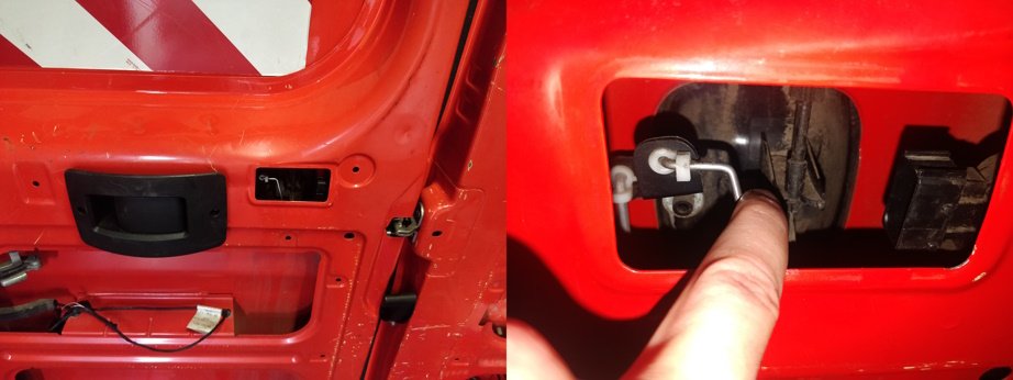

Addition to the above: I found out I can manually lock the rear door, similar to the passenger door:
I removed a little black panel next to the door handle on the inside, exposing a thin metal rod. This rod is connected via a little crank to the lock on the outside, and to what I think might be the electric motor of the central locking system.
Pushing this rod away from the lock slightly causes the lock to engage!

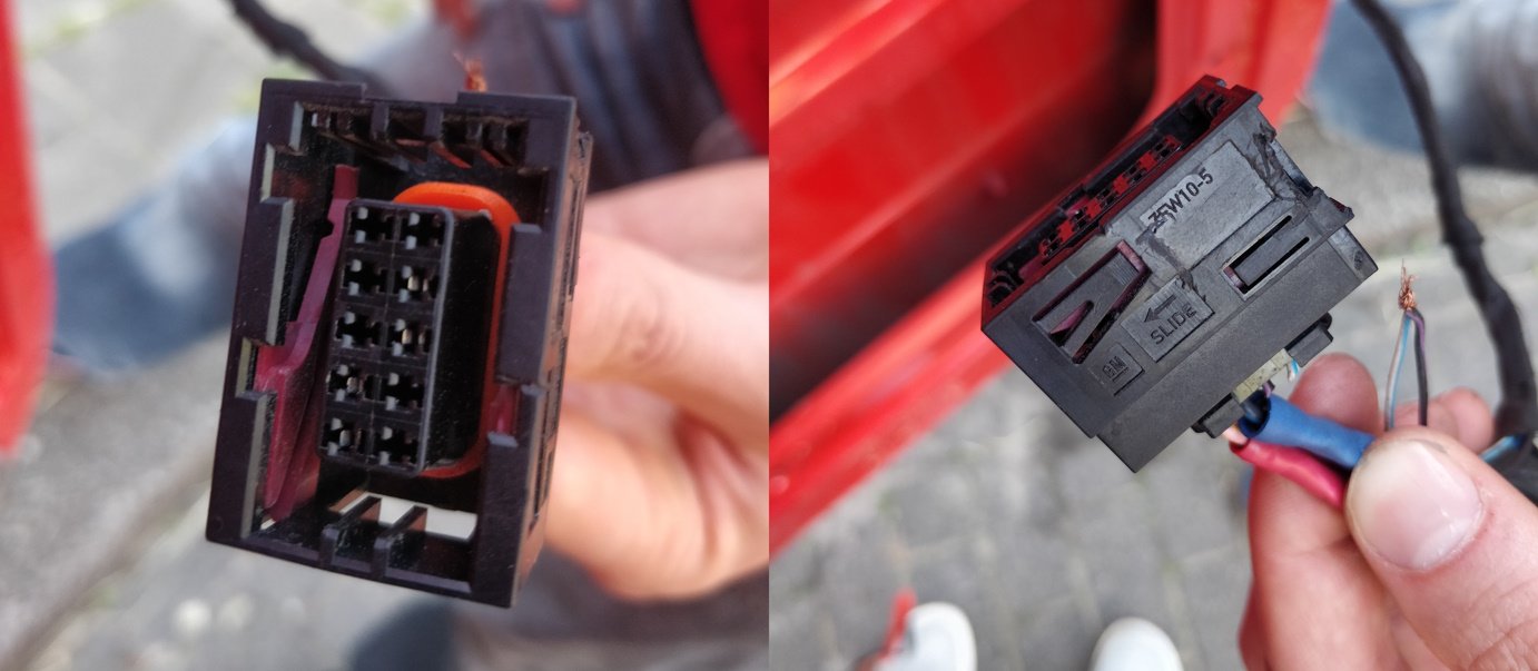

Monologue continues. I found:
  • The connector to the rear door locking actuator is broken, it doesn't stay in place and I don't know if it still connects electrically.
  • Two wires were broken or cut deliberately before the connector and shorted together.
  • Undoing this short causes the open-door indicator to disappear and the central locking to work!
  • The sliding door sometimes doesn't detect correctly either, it needs a really firm push from the outside. I measured that an open door is seen across the sensing wires as 0 Ohm, while a closed door is measured at around 40 Ohm. (Seems random to me, but okay.) Maybe the same would apply to the rear door.
  • When correctly bypassing the rear door detection it still doesn't lock (or unlock actually) through central locking. Either the broken connector doesn't connect at all or the locking actuators are just broken.

It's been a saga of exactly one month, but I resolved the issue!
In the end I simply ordered a new locking actuator female connector, from Alliexpress (https://nl.aliexpress.com/item/1005002548929647.html) (because nobody else sells it). I cut off the old broken connector and the old crimp wire extensions and attached the new connector. I didn't have a proper tool, so that was a pain, but I managed.
And that's it: door detection and central locking is working again!
While debugging I was sent on the wrong path for a long time because I though the old connector was still making electrical contact, even though I didn't mechanically fixate. But I didn't: so sensor and electrical actuator were never broken to begin with.
