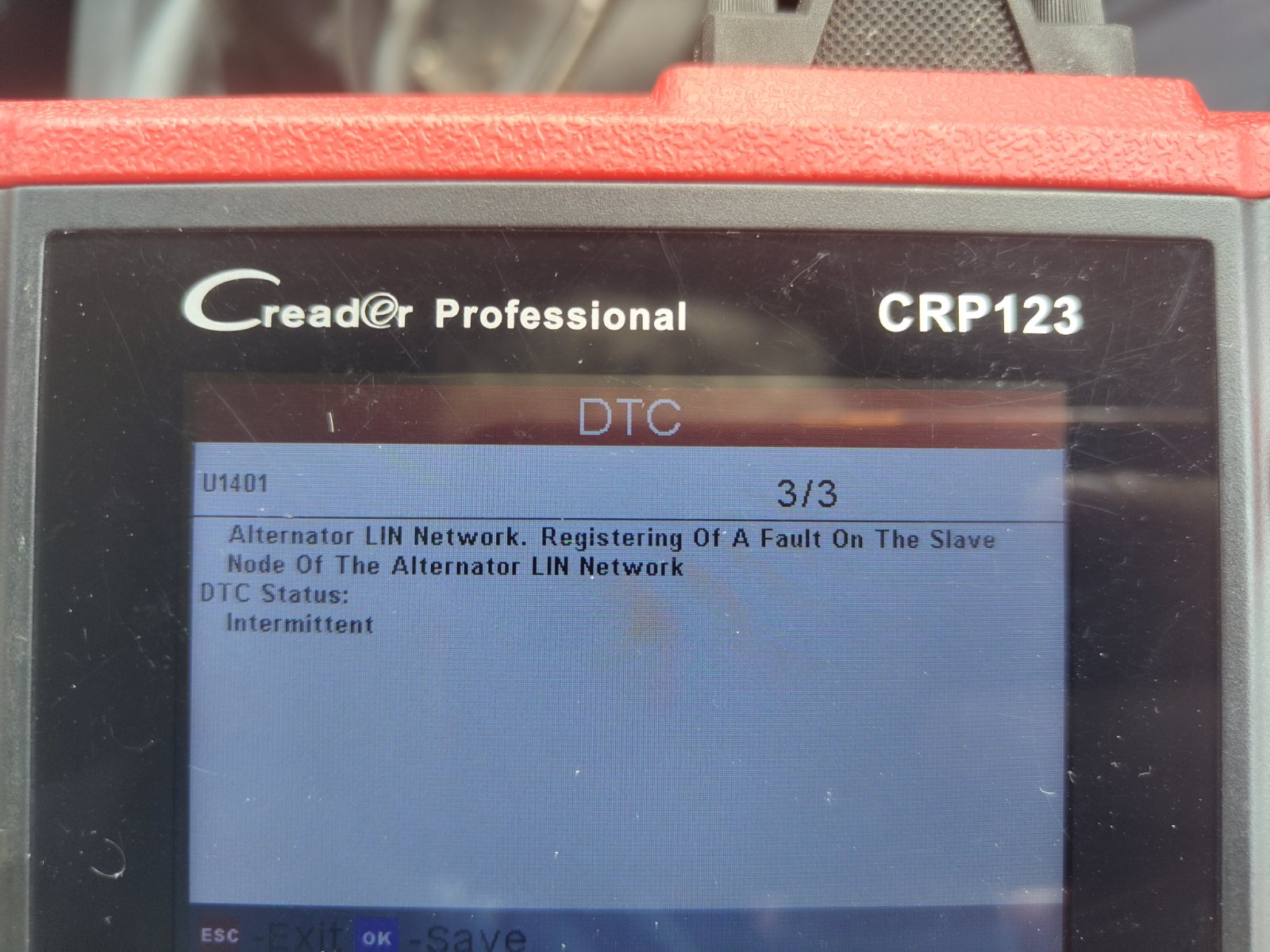

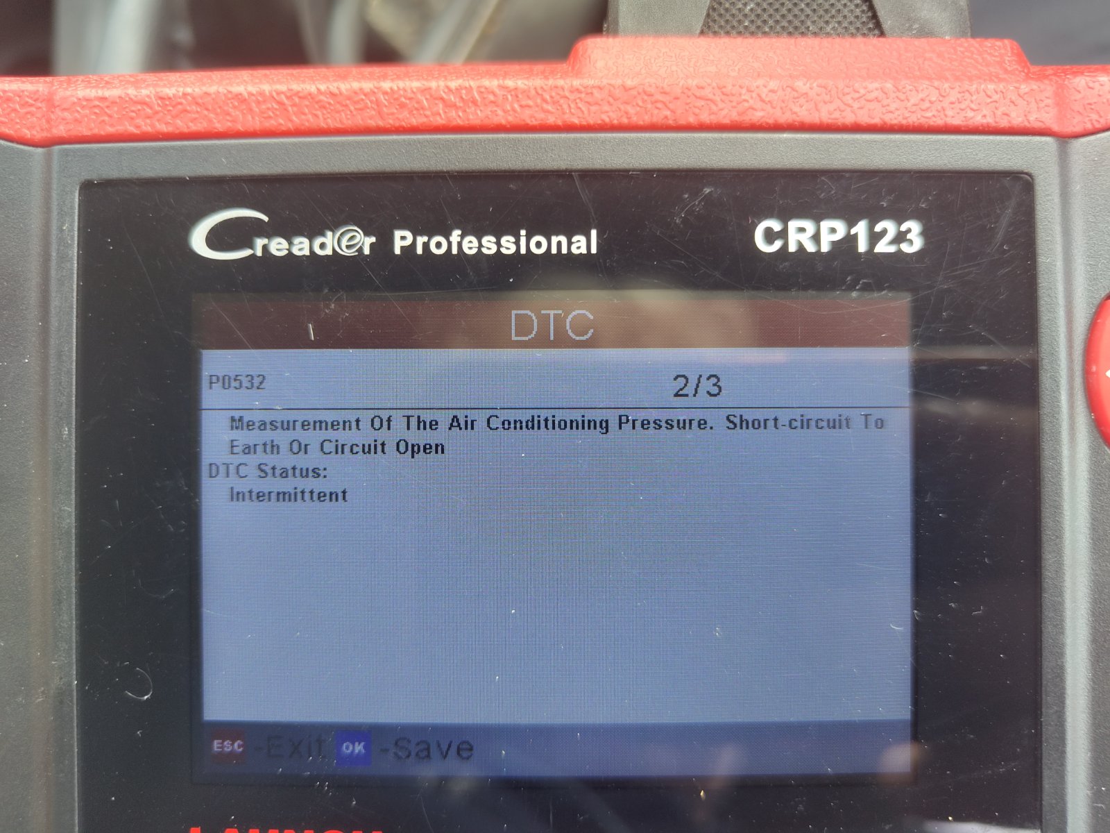

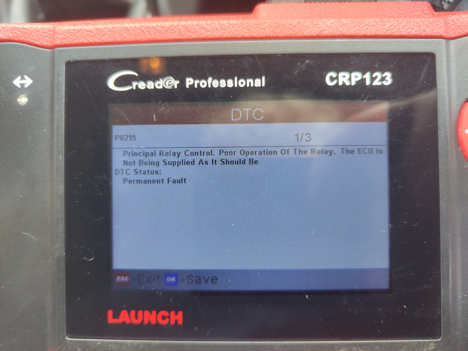

I did a diagnostic check with following codes P0215 P0532 U1401. Checked the fuse on my engine box and fuel pump fues is good, Im in process of removing the common rail sensor see if that can be an issue.

I've left the Air Conditioning one for now as it probably isn't related to the starting issue.
Fault Code: P0215
Description of Fault: Main relay control: Poor operation of the relay, the ECU is not being supplied as it should be. The engine management ECU is still supplied 1 seconds after the request to cut off its supply. Loss of supply of the engine ECU for 1 s without a prior request being detected, due to an incorrect value memorised at the following wake-up.
Conditions of activation of the diagnostics: The following conditions have to be met:
- Ignition switched on
- Battery voltage more than 10 V
Conditions for Fault to clear:
  • Driving for 5 minutes
Downgrade Modes whilst Fault is active: -
Symptoms:
  • Starting problem
Suspect Areas:
  • Main relay
  • Electrical harness
  • Connectors
Fault Code: U1401
Description of Fault: Alternator LIN network: Registering of a fault on the slave node of the alternator LIN network. Faults in communication between ECUs on the CAN.
At least one of the following conditions must be fulfilled:
- Engine running
Symptoms:
  • Jerking/stalling
  • Starting problem
  • Lack of power
  • Absence of automatic stopping of the internal combustion engine (Vehicle equipped with "stop and start")
  • Problem with automatic restarting of the internal combustion engine (Vehicle equipped with "stop and start")
Suspect Areas:
  • LIN network
  • Engine ECU
  • Alternator
