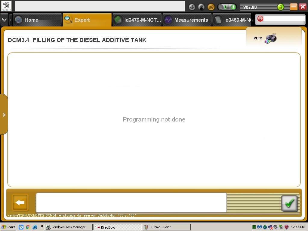

I've browsed a lot of videos and posts showing how to reset DPF Fluid after filling up, but after 3 hours in diagbox I just can't seem to get past this error in the attached screenshot. This error comes after entering the number of grams i've added to the tank. I assume there's another value I need to add somewhere first such as mileage, but can't find any example of anyone needing this step. DPF Fluid Low Warning came on, drove the car for probably another 500 miles, added 2L of fluid which is ~2000 grams. It's a Peugeot 407 Coupe 2.0 and the DPF Management is done through the ECU it doesn't have a dedicated ECU like some Peugeots seem to have for this.

Check to see if the reported level has gone up, sometimes it says not done, when it actually is! Does it give any guidance on volume? It may be that your number is too big. Also seems a bit odd for it to be grammes, normally it's a volume measurement.

I've no idea how it works as it doesnt look like any example done by others, but that menu option seems to be asking for amount of additive added in the tank but wont accept any value because it says something else must be programmed first?
I just tried a different way and did this, but even more confused now:
Got the parameters of the PEF and it says I have 470ml of fluid left in the tank. I then go to Aftersales PEF Filter Repair Operation and it asks to enter Total Weight of Additive Contained in Particle Filter. I enter 470g which is the only value it seems to accept (even though 1ml != 1g of fluid imo and there's not 470ML in the filter, that's in the tank. The ECU says the filter has 1496mg of additive in it which makes more sense as has a few hundred km yet before regeneration is gonna happen according to the ECU Paramater reports.
I then go to Personalised Maintenance of the FAP (Particle Filter) it asks for maintenance limit which apparently is 32000km it confirms 0km remaining before replacement of the PEF and says the FAP needs to he changed due to age if vehicle (120k miles doesnt seem to old to me, but I guess if it's based in a maintenance interval of 32000km it is well over now?)
I then go to Personalised Maintenance of Diesel Fuel Additive System and it asks for vehicle mileage in km. I enter that from the dash in km, it asks for gearbox and engine type etc and it then says its not possible to use this function and I need to Apply the mileage maintenance for the additive. But where do you enter that? I assume I need to enter 32000km somewhere as that's the maintenance limit in parameters of the ECU?

That's the wrong function, the grammes is the spent additive in the filter. You want repair, then refilling of the particle filter additive ( or words to that effect). By the sound of it you have now told it there 1.5 kg of ash in the filter!

I haven't found any menu option under Engine ECU for refilling and the Additive ECU is absent, so I assume it should be under an option somewhere in the Engine ECU, but it might not be maybe? Someone else has said it was hidden under an unrelated ECU on his 407. He advised to go through every ECU in Maintence and then Repair mode until something comes up different to the Filling Additive Tank menu options in Engine ECU. It's gonna be a long day. I can't believe nobody else has had this issue. I've done so much with Diagbox over the last few years but this is unbelievably complicated. Programming 4 new TPMS fro mscratch was easier than this haha!

Who knows, he said it wasn't where everyone says it is on his 407. I've tried every option in Engine ECU and they all fail either wanting mileage to be entered, something checking in service box or say other Programming is needed.
