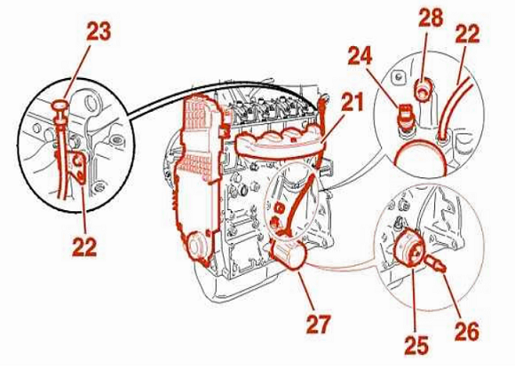

Hello guys, can someone give me the corect torque spec for the bolts holding the oil filter housing to the engine block? I searched everywhere and i cant find nothing about it.

I have the cartridge type oil filter, not this one

The heat shield (21).
Tighten the bolts to 0.8 m.daN .
The oil gauge guide tube (22) (sealing on engine block with RECTIJOINT adhesive paste).
The dipstick (23).
The electric gauge (24) (According to equipment).
Tightening torque to 2.7 da.Nm.
The heat exchanger (25) (According to equipment)
The nipple (26) (According to equipment)
Tightening torque to 0.8 da.Nm.
Oil Filter (27)
The oil pressure switch (28)
Tightening torque to 2.5 da.Nm.
The dipstick (23).
Oil Filter (27)
