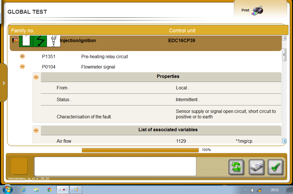

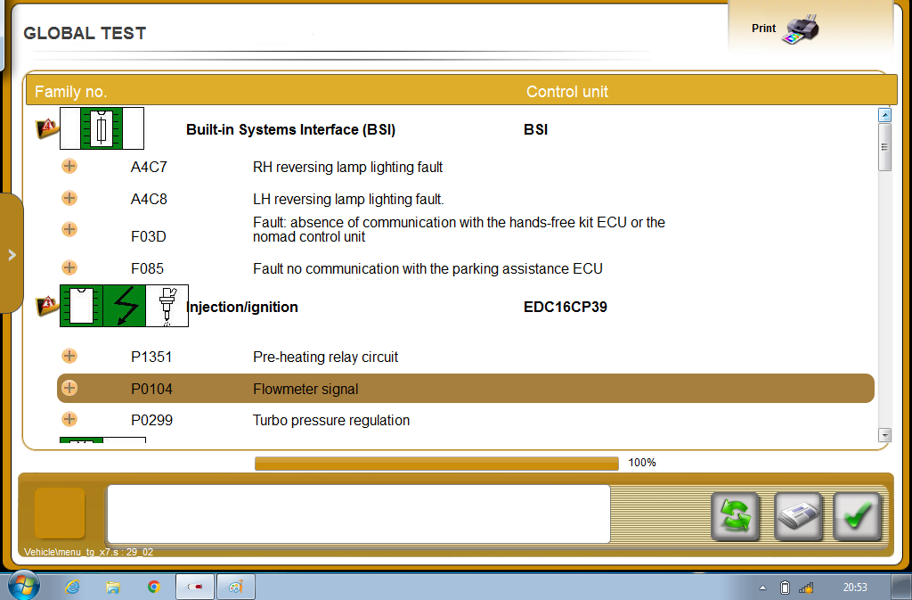

A quick read of the C5 fault codes (and reset) yesterday evening.
Quick dump of the results will have a think when get chance. As there was codes related to airflow sensor and air inlet temperature sensor, I unplugged and gave a good wiggle to the wiring of the MAF. C5 been for usual 80 mile round trip to the office, ok this morning and a bit of a flutter at part throttle from about halfway home. Oh, one new and interesting development, just set off this morning and front left tyre pressure too low on the dash. Stopped in a layby and...

Update: technology falsely accused of being rubbish!MattBLancs wrote: 28 May 2024, 20:57Oh, one new and interesting development, just set off this morning and front left tyre pressure too low on the dash. Stopped in a layby and...
... all four tires are fine. Technology hmm....
Swapping tyres about a while back (new ones on the back) means the tyre reported as "front left" is intact rear right!
Or at least that tyre had, checked with a gauge tonight, just 1.85 bar rather than the recommended 2.4 to 2.8 bar (unloaded Vs loaded figures). Didn't really look under par to be honest. If anything front right looked worse (2.15 Vs recommended 2.4 bar) but guess that is as much a function of big diesel engine sat at the front!
Other front 2.2 and other rear 2.6. topped up to the loaded figures (given my typical usage!!
