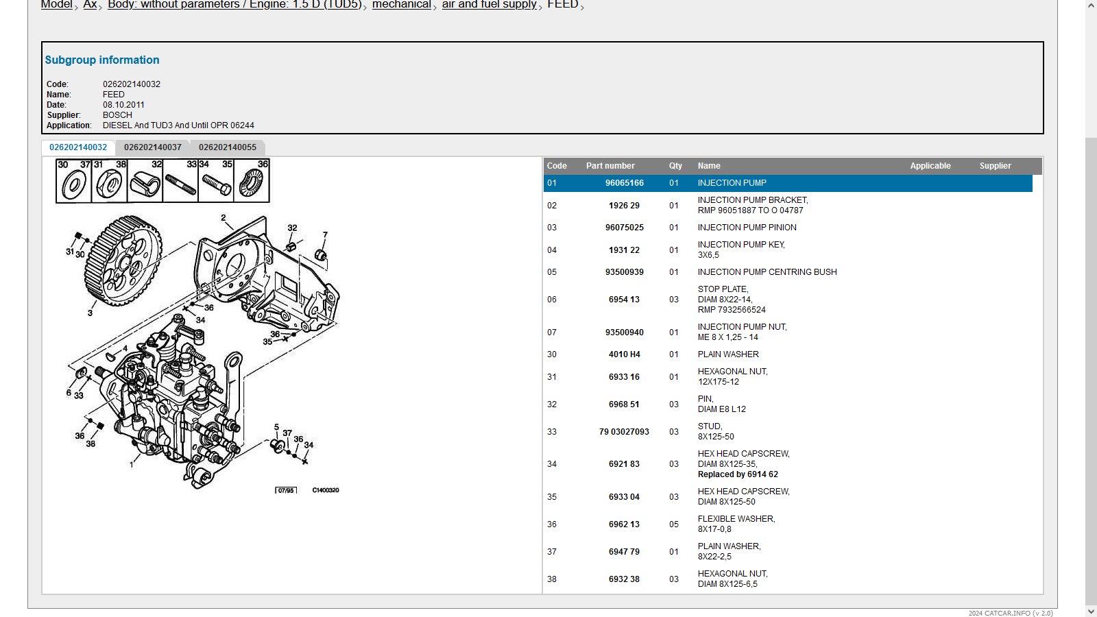

Re: Misfired!
My VIN shows my is Bosch VE not Lucas. I have learned it misfire more when it is cold till warmer, less misfire still ain't right. See my picture.CitroJim wrote: 30 May 2024, 05:52It's all mechanical on these Paul so no ability to do laptop-based diagnostics.PaulC5 wrote: 29 May 2024, 21:40 If you have not had a diagnostic done, I would do that first before spending money on a fuel pump repair.
What pump is fitted to yours Flying Postman? Lucas or Bosch?
My buddy said he thinks the pump lose the pressure when it becomes high revs. Unliked the injectors.

Sorry to hear that.. I must admit life often gets in the way with me and I'd taken my eye off the ball with this one...
Very unlikely to be a pump problem par-se. Much more likely to be a fuel delivery problem to the pump.
Check your leak-off pipes for damage/perishing and replace if at all suspect, including the blanking cap on the last injector. Also, check for air leaks around the fuel filter. Temporarily replace the pipe between filter and pump with a clear one and look for air bubbles - there should be none.
Finally, check the fuel pickup strainer in the tank. It may be partially clogged.
