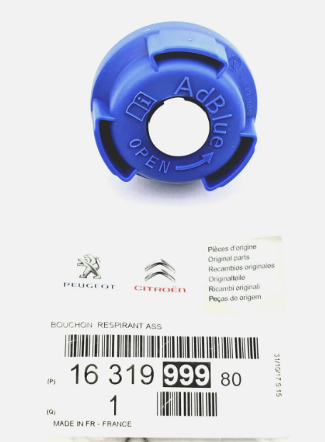

I also changed the filler cap from the current black top one that was on my car to the replacement white cap one the was recommended by people. (Bought off eBay) Part - 1631999980

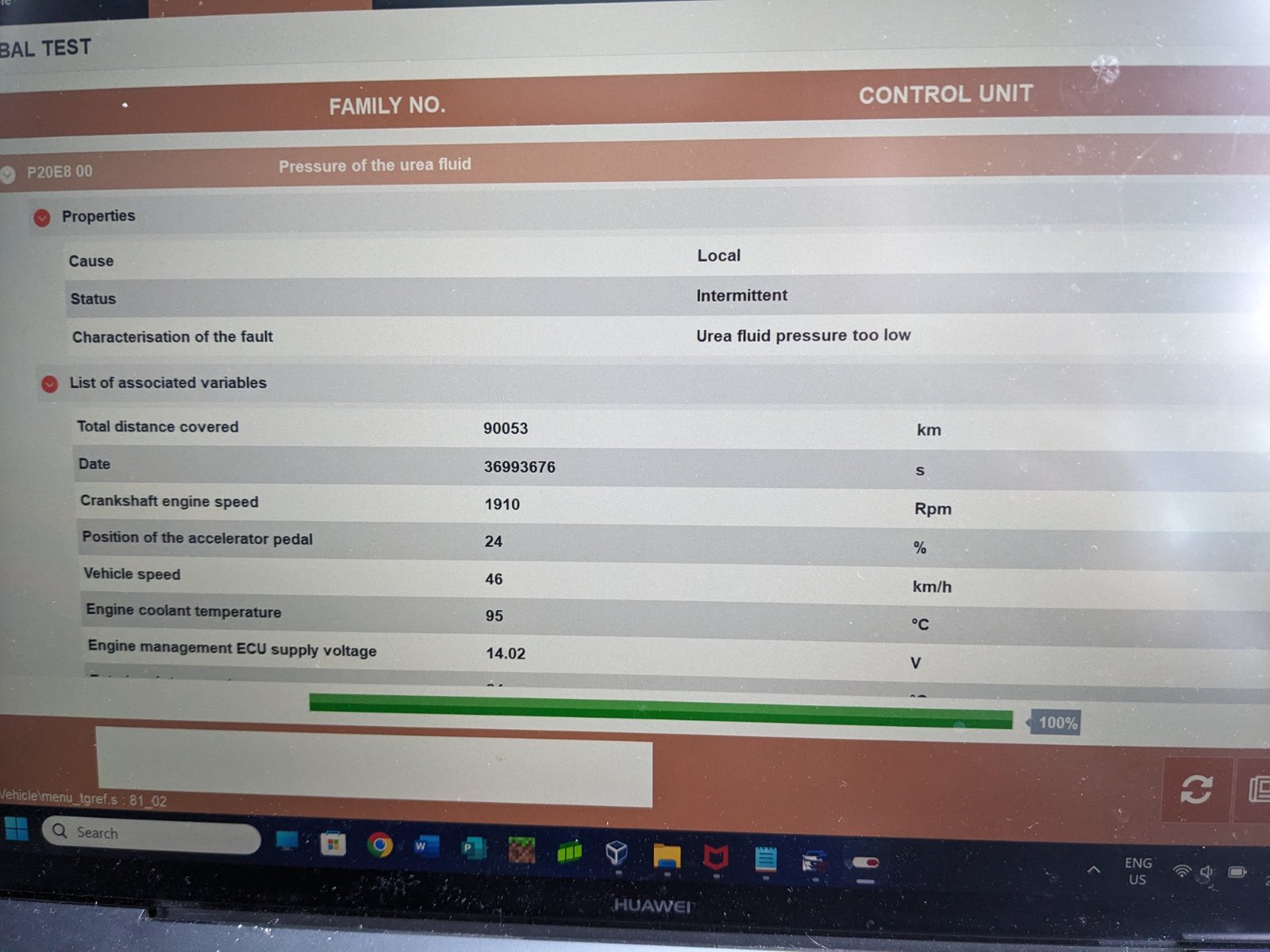

Now I get an intermittent Adblue emissions fault which comes on sometimes whilst driving, the usually goes on next restart.
Today I got an 'engine fault - repair needed'.
I ran diagbox and got error code E20E08 - pressure too low (see attached for full error details).
I'm hoping it's not a leak and full new tank needed.

As a precaution, I've put my older black topped filler cap back on - just in case the white top one I had got was causing the issue. (The eBay item said it was brand new genuine part - but came in an opened Citroen parts bag - so I've no idea if it's genuine, new etc).

That is the correct part number for the replacement cap:

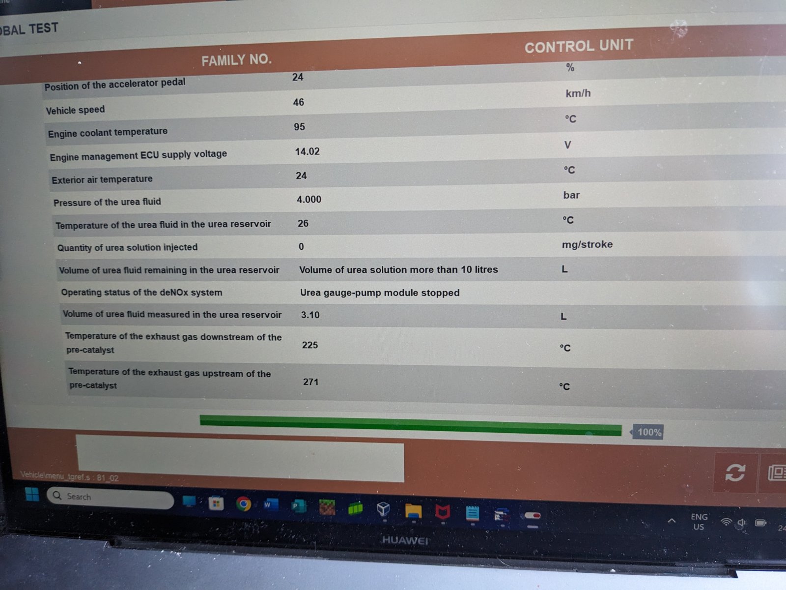

There's no fault for crystallisation, the fault is pressure too low. Could be the pump, the pressure sensor, or injector failed ( but that usually has its own fault. There was a thread recently where someone repaired the pressure sensor - which otherwise only comes as part of the (expensive) tank. You need to clear the fault, reset the denox system, then watch the live data with the engine running to see what it does. Once it starts to warm up status should go from waiting to pressurising and the pressure should rise to about 6 bar, then it should start injecting and the pressure will drop back to about 5.5.

P20E8 00 has a specific Technical Service Bulleting and it relates to what I said above for vehicles with this engine (DV6*) which includes your build date. From later build dates they modified the assembly, but in this case check to make sure that the heated urea pipe is firmly in place and has not come apart at any point - which would cause a pressure fault.

I've cleared the fault and reinitialised the denox system (tank, not catalyst) in diagbox repair pack area and that has cleared the engine warning light now.
I'll have a physical look at the pipe and monitor the live feed to see if the pressure increases.
I know 4 is the lowest it reads and needs to go to around 6 then pump kicks in and drops

The low pressure fault is back.
The live data shows it doesn't go above 4, so doesn't kick in the pump.
So seems like a new tank needed

My old tank still had the old black cap, so I think when the low light came on and I filled the tank and replaced the cap, the old black cap had caused a pressure seal in the tank, so it only went down hill from the moment I opened it.
