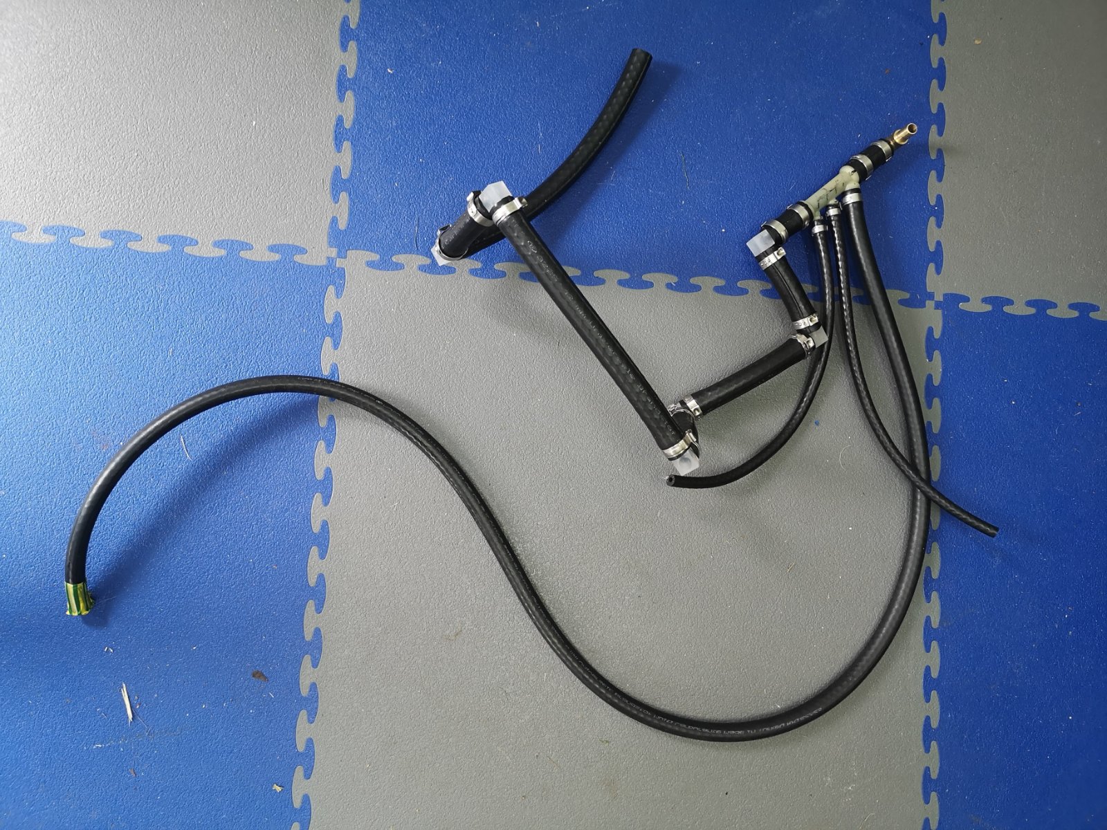

My Autodoc order finally arrived yesterday and they'd got most of it right - the 12mm, 8mm and 4mm stuff had all been correctly supplied, and is lovely supple stuff, easy to work with. Annoyingly whilst they'd merrily charged me for the 10mm Gates fuel hose I'd ordered, they'd sent some cheap nasty 10mm coolant pipe - it's not even oil resistant so no use to me. As an emergency recovery to try and get to my MOT retest, last night I ordered a metre of 10mm Chinese fuel hose from Amazon which cost more than the Gates stuff, but arrived this afternoon.
Last night I set to and started assembling what you see below...
1200mm of 8mm hose running from the "triple tee" down to the steering pinion valve
310mm of 4mm running from the triple tee down to each of the bulkhead rigid pipes, so far so simple.
Bizarrely, the "in and out" barbs of the triple tee suit 12mm pipe, though the stub on the reservoir and the tee to take in the flow from the electrovalve both suit 10mm pipe. I've assembled the complex section that goes from the bottom of the triple tee to a point just in front of the top of the gearbox in 12mm hose, using plastic elbows where the original had tight turns so the new one will follow the route of the original pipe. From there I'll fit a reducing elbow from 12mm down to 10mm and use 10mm hose from there, picking up the electrovalve tee and on to the pressure regulator return. I have a similar reducing elbow on top of the triple-tee, and will then run a short bit of 10mm hose from that back to the reservoir. All the joints where the hose goes onto a barbed fitting have been secured with new stainless "single ear" crimp-on clips, should be secure and leak free. What you see below is now assembled into the car, with the reservoir back in place. The original click-clips fitted the 4mm Gates hose nicely for where it meets the bulkhead rigid pipes, but I found it easier to use a "jubilee" style screw clamp to secure the 8mm hose to the pinion valve return as access for hose-clip pliers is pretty tight down there!
Now I have the 10mm hose I need, once the kids are asleep this evening I should be able to knock up the last few bits, get it all connected up and slot the airbox back in ready to set off for an MOT retest at 6am tomorrrow. Wish me luck...

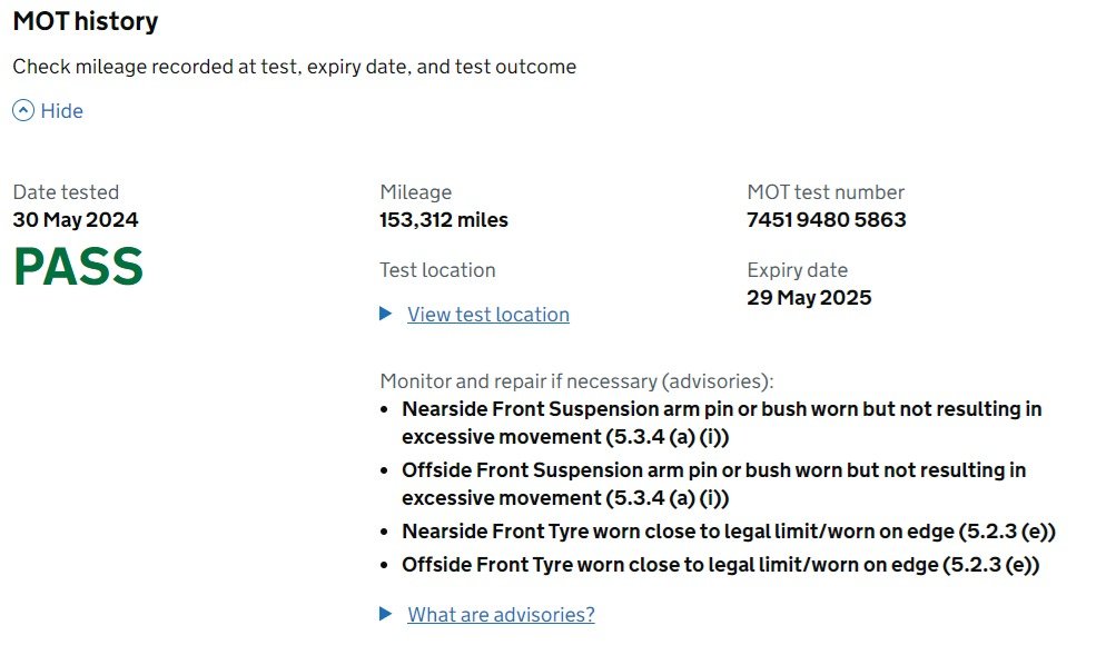

Finally! (And show me an activa that doesn't have worn outer shoulders on the front tyres...)
That means we're back up to seven working activas in the UK. Phew.

Tyres, the softer the side wall the worse that will be (remember the Pilot Sports were quite still in the sidewall)......check tyre pressures. On my 17in TR1's I have increased pressure from the recommended for the 205/15's.
