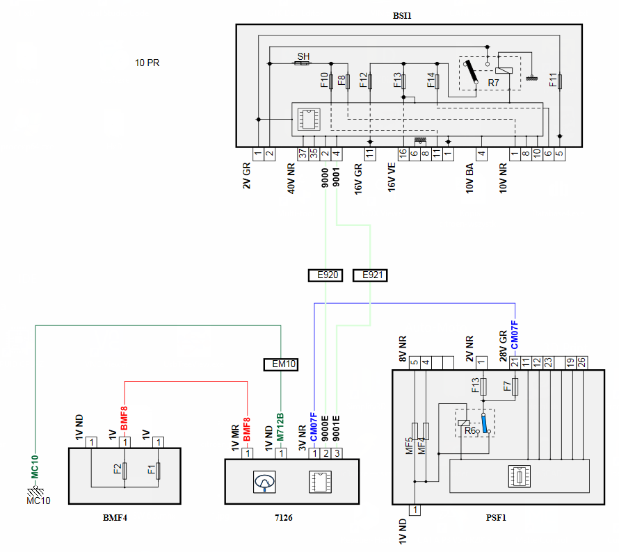

Try to find if your power steering ecu getting power. Than you have to check a whole loom going out from power steering ecu. According to the description no signal (either no +12V going in to ecu or broken can loom, or broken ecu)
