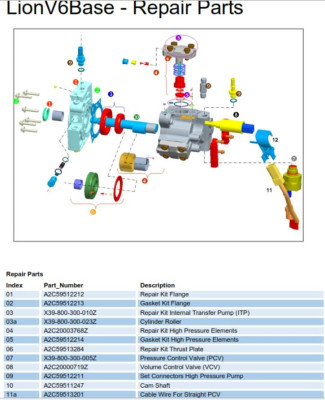

Also a VDO Lion V6 Base Repair parts diagram with part numbers and measurements
Rather expensive it appears @ £190 and seems only genuine part (no after market available)
