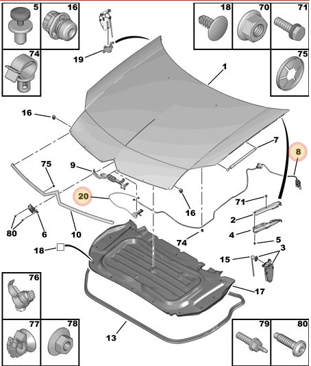

If it's anything like the X7, the plastic release tab had snapped in the winter. To get the bonnet open I had to use a long screwdriver to release the catch holding the bonnet on the latch.
In my case, I was able to partially open the first part of the bonnet, but the second cable is attached to the release tab at the front of the bonnet, and this is what was broken. However, if you can't release the first part of the bonnet, then I'm not sure what you are going to do as it may be the first cable that has gone!
(8) Is the stage 1 internal control release from inside the vehicle and is no longer available from Citroen.
(20) Is the secondary cable that is connected to the tab for the stage 2 release.
Both cables are connected to the locking mechanism. (8) is the partial release to lift the bonnet from the lock and the cable with tab (20) releases the lock catch as far as I can see.

Re: Torn bonnet pull Citroen C6
Hmm this could be a challenge...
If it is (8) then the best way will be to from the bottom. Remove the engine undertray and the radiator ducting in front of the cooling pack, you should then be able to reach up to the lock mechanism to release it.
I believe some people have had success with a long screwdriver through the front grill as Mark suggests but the C6 lock is set back and above the grill quite a distance and a very long screwdriver would be required.
I can supply used cables if you can't find any locally.
Thanks for the information.
Unfortunately, it is Nr. 8 that no longer works. This lifts the bonnet not out of the lock as described by Marc.
That's why the bonnet doesn't open even a little bit.
Perhaps the wire is not torn off directly at the lock mechanism, but at the beginning or somewhere along its long path.
But where is this wire?
And it may be easier to expose this cable and then unlock it by the wire.
Greetings Wolfgang
Greetings Wolfgang
There is no further info on the wire itself that I have Wolfgang, and I have checked the trim diagrams to see if there was any info on the routing of the wire.
- x 6955
However, the system is similar to the C5 X7, so if it will help, I can put the X7 procedure up in the members section for you in case it helps - I can't see too much difference apart from the pyrotechnics (pedestrian impact system) etc.? Let me know if this would be of help, but on the C6 it still involves:
Removal of:
Removal of:
- The front bumper
- The air filter box
- The battery carrier
- The engine fuse box
- The front pillar trim (Left hand )
- The built-in systems interface
- The driver’s steering column air bag
