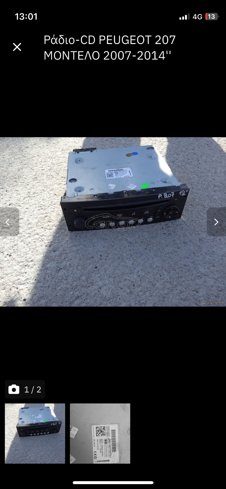

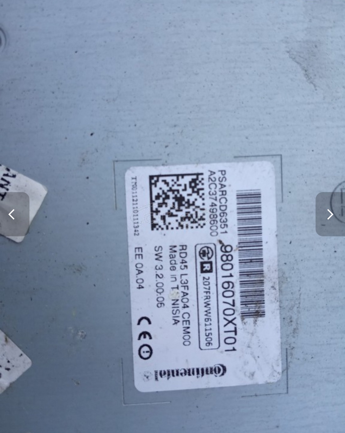

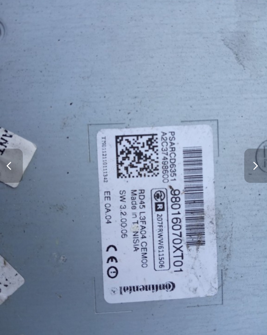

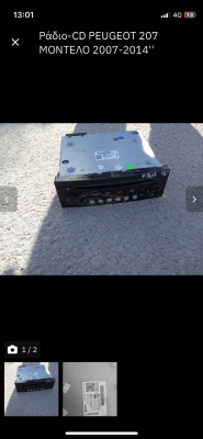

This is the radio I was planning to buy can you tell if it need a microphone or anything else?
Posts: 37748
x 5808
Re: Citroen c4 2008 display
Post by GiveMeABreak »
See my last post ^
