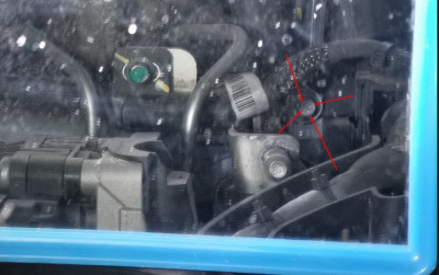

I would like you share with you my adventure with the fault code P1352, a VERY tricky faul and very common on Peugeot-Citroens.
The diagnostic tool shows fault on glowplugs or glowplugs relay. After searching the whole internet, i found nothing!
I found people who had the same fault code as me, they changed glowplugs, they changed the relay but the fault remained.
I checked the glowplugs with mutlimeter and they looked good :?
Guess what? I changed glowplugs and relay and the fault code still remained. :oops:
My old glowplugs were working perfectly (tested them after removing them)
So if you have this fault code, before changing anything on the car, firstly check:
1) the glowplugs cables which are behind the airbox (sometimes the airbox is wearing out the cables)
2) chech the connector of the relay plug for corrosion
3) CHECK THE EARTH POINT MM01
I solved my problem by removing the MM01 earth point, cleaned it with contact spray and oiled it with contact oil and put it back and tighened it good.
This solved my problem after 3 months of check engine.
I think this happened after a mechanic changed the thermostat and probably he did something wrong there.
I made a video of the location:
https://www.youtube.com/watch?v=s_HPmiJR8wM

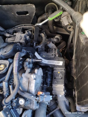

Thank you so much, finally this fault is gone. And thanks to the pics they help a lot.

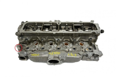

IMAGES WHERE DELETED SO IM UPLOADING AGAIN
Here some pictures to understand the location:

Hello, thank you very much for sharing this information. I have a same issue, but my bolt of EARTH POINT MM01 is missing.
Does anyone knows characteristics of it? Thank you

Hello All,
Thank you pablo95 for raising this topic.
So, by putting my missing EARTH POINT MM01 bolt (fyi, it has 6mm diameter) - the issue was not resolved. Only the thing I got was that my error in the scanning device went from intermittent to permanent (already something :) ). But the issue still exists, my relay seems to be a new, no corrosion observed. The glow plugs are new as well.
