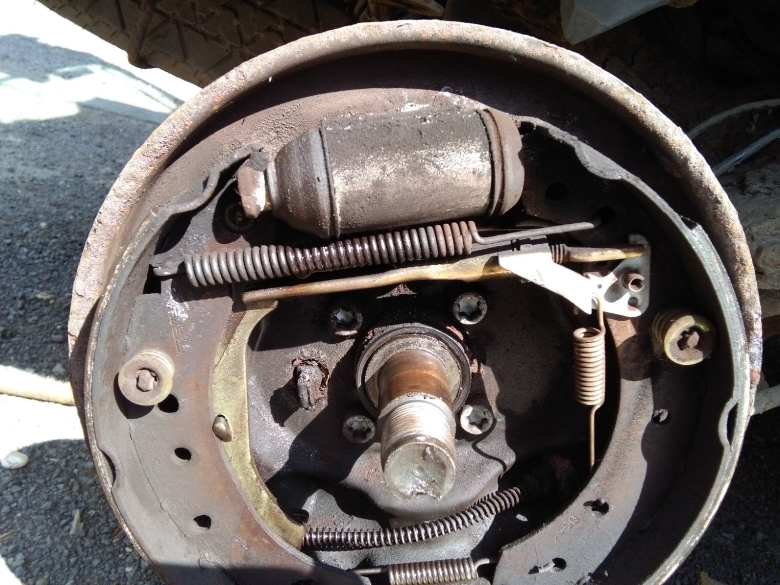

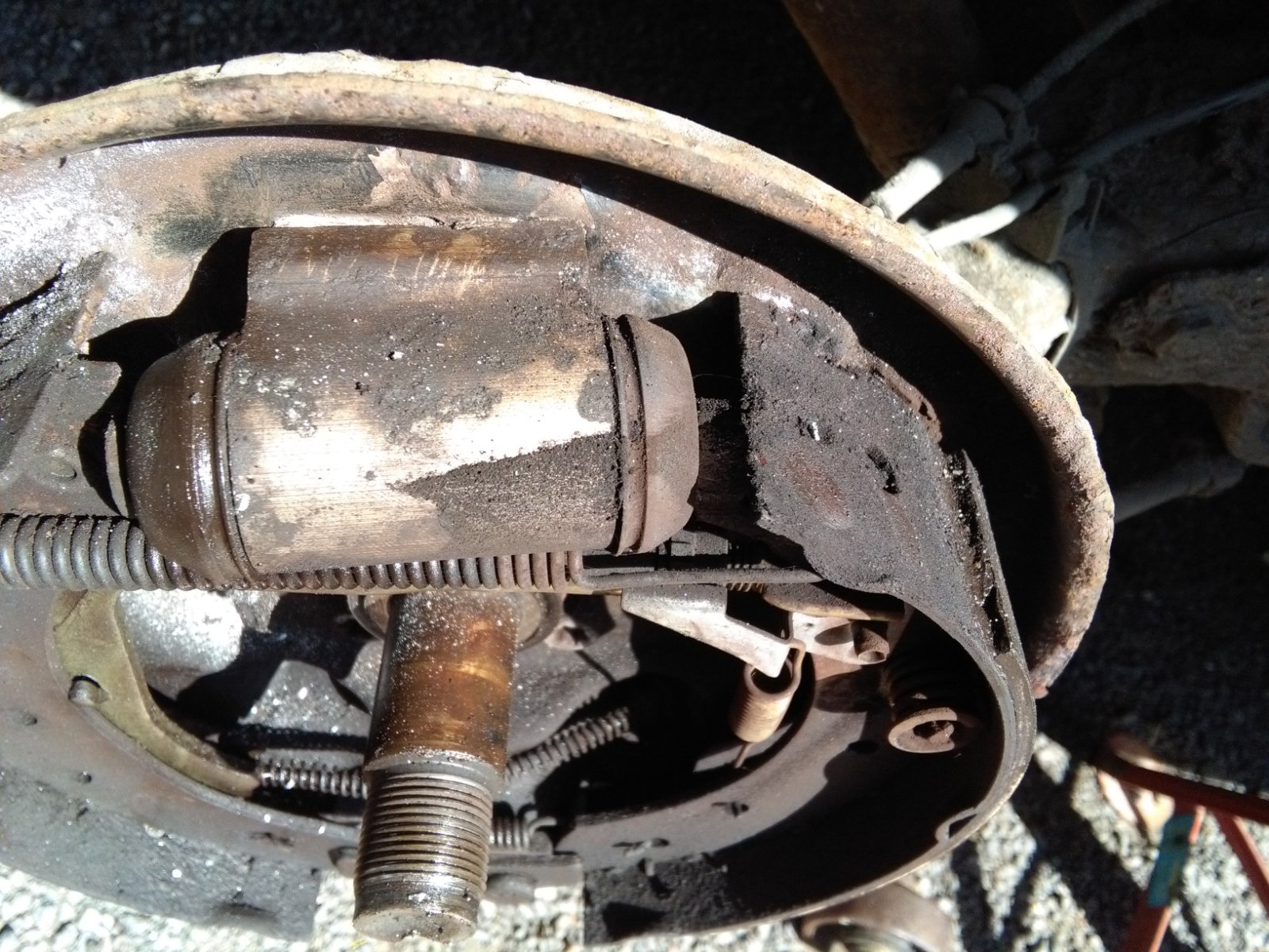

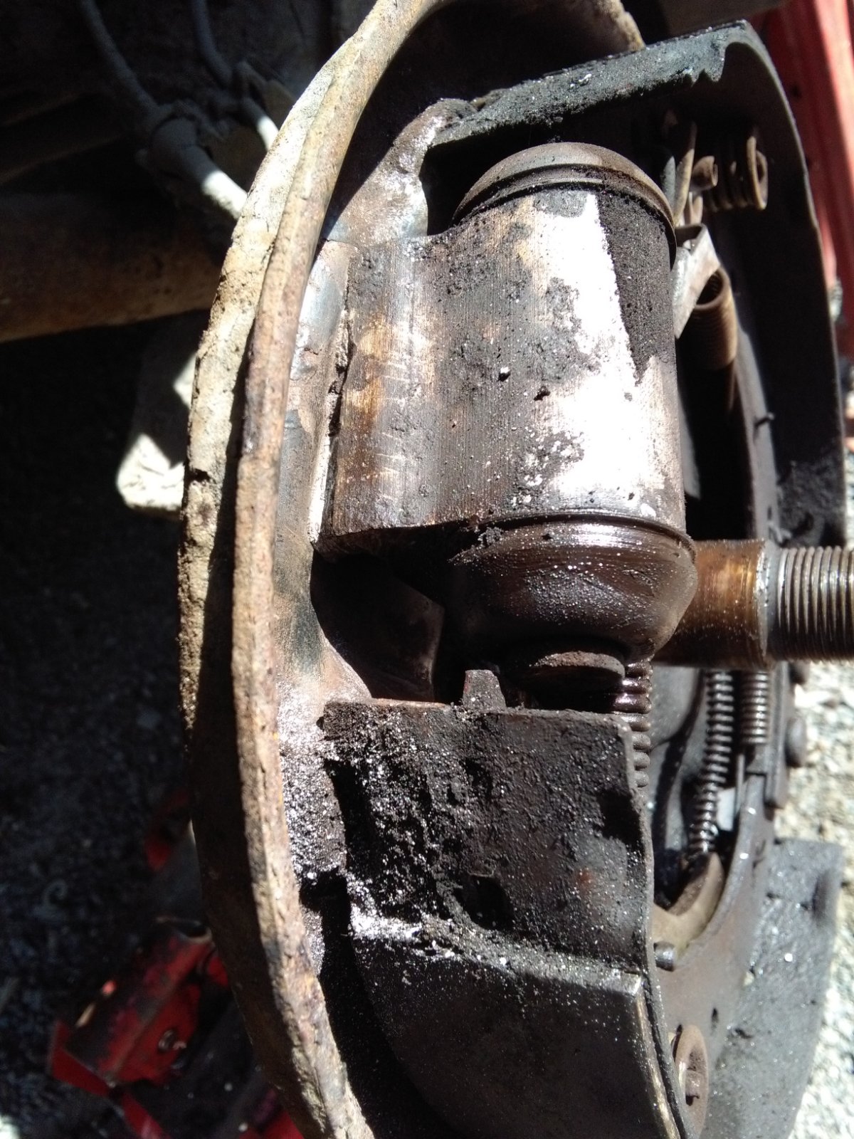

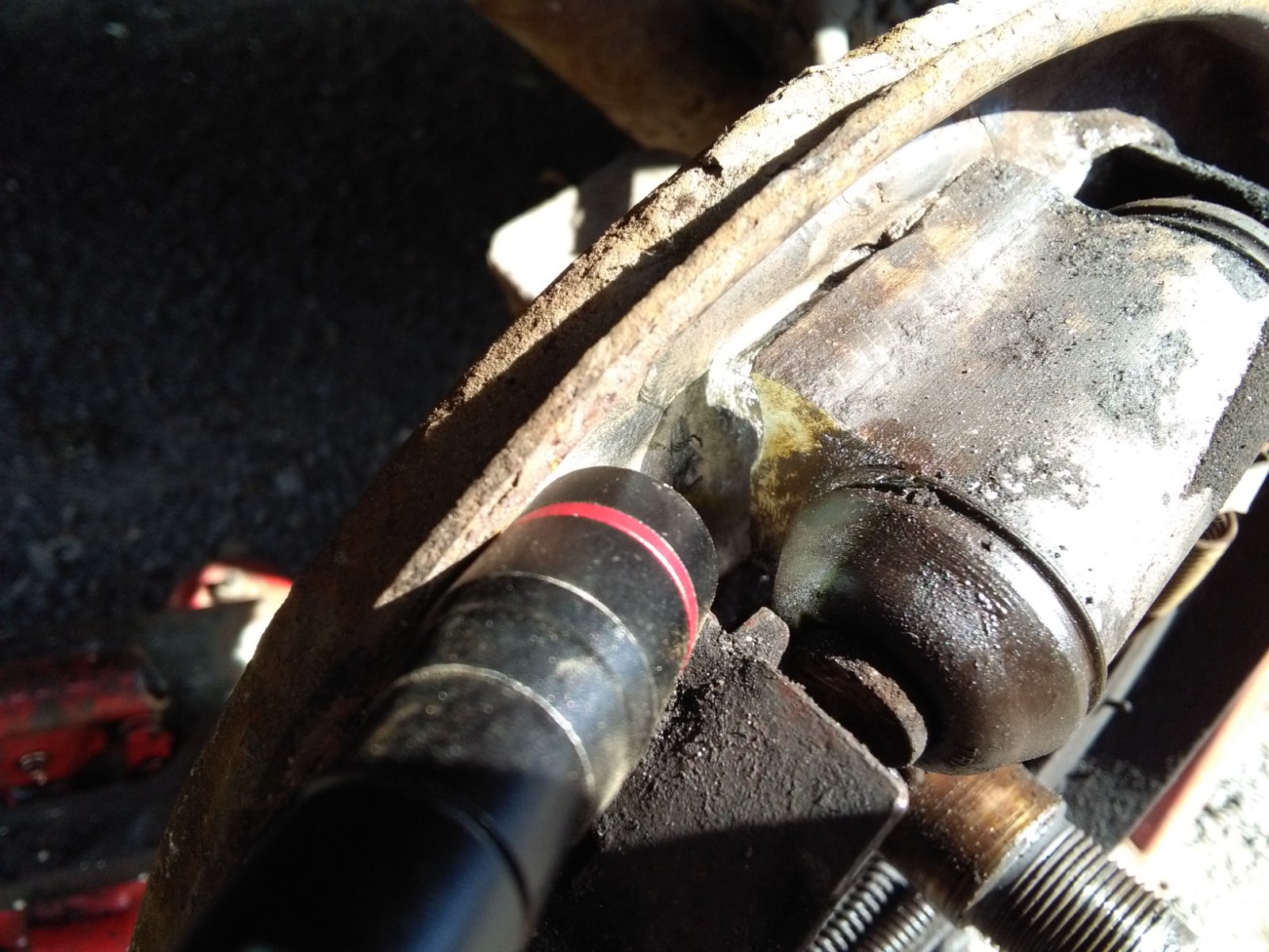

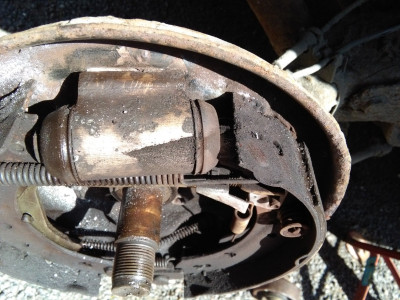

Removed the hub and found the problem. The cylinder was about 6mm away from the backplate at one end so the end of the piston was missing the end of the shoe. Presumably the piston is stepped under the rubber cover and this was operating the brake. Big build up of white stuff that old brake fluid can leave behind. This has been misaligned for years and must have been leaking slightly for years. I suspect whoever fitted the pads turned the one on that side 90 degrees to fit it at the bottom without realising it was behind the piston at the top and pulled the cylinder forward.
- x 6956
Re: ABS on rear Drum Brakes?
Well spotted and thanks for posting the pics and update - sure to be helpful to others.

I removed the bolt holding the cylinder to attempt to clean the white crud from behind it to try and fit it properly and considered continuing to use it which I accept isn't wise but there wasn't much play in the pipe so was concerned about damaging it although I will check to see how possible that is. After wire brushing the pipe and connector look surprisingly uncorroded. I've WD40'd it which will have a few days to soak so hopefully it'll release without trauma and swearing.
