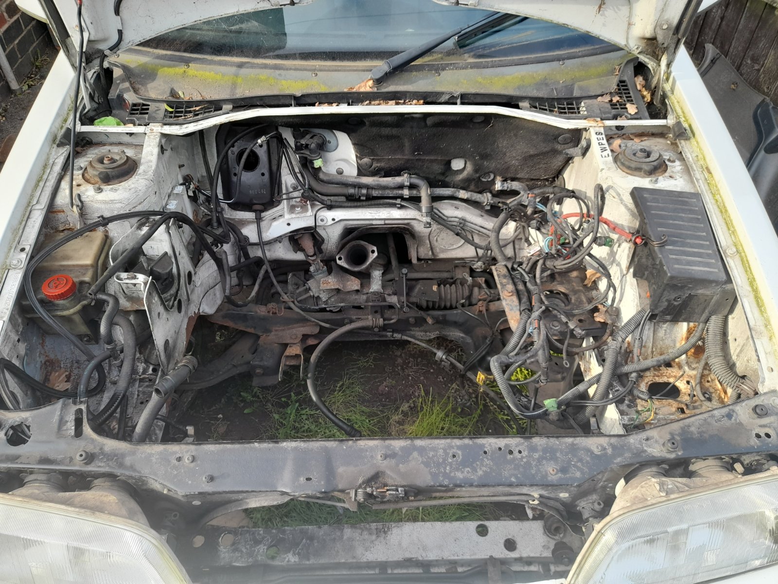

Had little time to play the last couple of days, but have done a little cleanup & pre-emptive rust protection on the front chassis legs and inner wings while access is good, removed her face to avoid damage during engine install & removed the OS front wing and strut for better access/protection while I attend to the only real hole on the strut tower. Pretty easy as it'd all been thrown loosely back together to make it roll, and will make fixing the rust sooooo much easier
Hoping to get a couple of hours "on the job" today, might even remember to take some more pics.

Oops! not been too well the last few days but I have managed to weld up the strut tower patch, stonechip/underseal/tidied up & done a first trial fit of the engine.
So far, I've got a few things to work around. This engine/'box combo has previously been in a 206 and was set up with the 206 PAS pump up top with the reservoir on the pump, and a later 3 wire alternator down low so I need to fiddle round with mounting brackets/belt alignment since the 2 wire alternator I have doesn't fit the current bracket & the PAS pump is in the wrong place too. Current options are-:
A- make adaptor plates to line the alternator up properly, re-bend/reroute PAS pressure line & run 206 pump/reservoir. (not ideal, ugly but will work)
B- find correct mounting bracket for the car to locate alternator/PAS pump correctly & use the proper pump. (preferred, but not easy any more as the once ubiquitous XUD bits are not getting any more common)
C- Cry gently into my coffee, longing for the days when D8A powered cars/vans littered every breakers and they couldn't give the bits away cheap enough (not really an option, but it's what I feel like doing!)
Next issue is the lower engine mount/intermediate bearing bracket is maybe a touch too close to the subframe, not a big problem as I have a few different ones around to try if need be.
Next, need to measure and find one gear shift rod (the forward/back one) to get the shift linkage finished up & finally (for the moment) is to make bracketry to convert the hydro clutch fork to work with the cable. Oh, and sort out a tach trigger that'll work with the petrol flywheel.

OK it looks like a 250mm Pug Partner shift rod will work, there's one at a scrappy not too far away & think it's even a DW8 so might have an alternator bracket that'd work. Test-fired the engine yesterday evening for a morale boost, damn thing just wants to live. It's been laying turbo-down in the back of a leaky scrap car for probably getting on 5 years now & covered in white furry corrosion but having plumbed up the fuel & given it a few seconds of glow manually (GP relay isn't working currently) it fired up in half a turn & not even a whiff of smoke...
Photos? Bleh, will have to remember to grab the camera before we get too much further along!

Dan, we need photos! Especially me
Good progress so far, this is a great project
