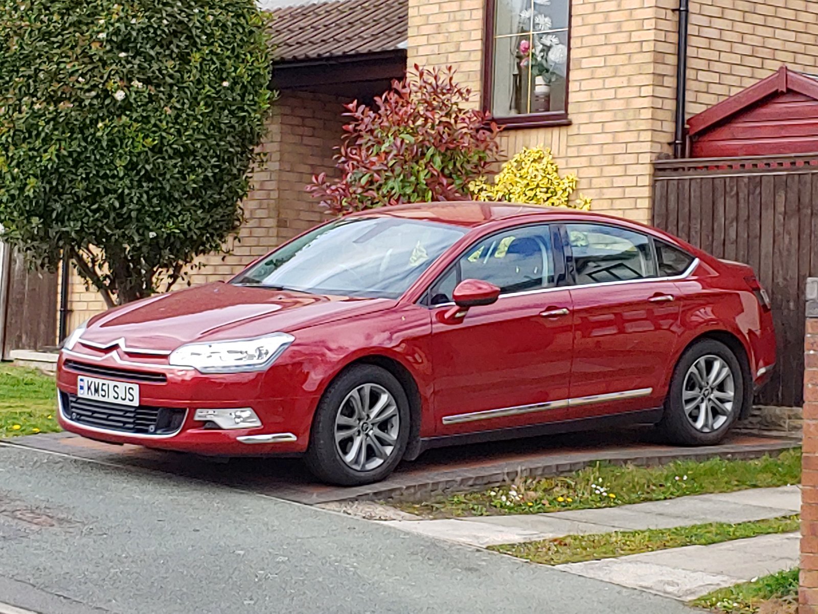

My C5 has had a serious arterial failure, so much so it will never be able to get up again unaided.
If anyone needs any parts before it gets a Piggy Backed to its final resting place please get in touch

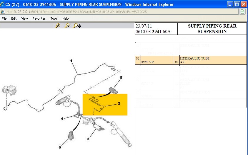

The ”Almost” relates to the main front to rear suspension pipe, it has three holes, one at each end plus another very small one, 4” in from one end.

Note, Front to Rear Pipe New £533, but none available in the UK or anyway to find if it ever will be available anywhere…….. or, I could get a 2nd hand one from France for about £416 plus import duty!

My Local hydraulics specialist has not seen a flare of that type/size, and apparently 4.5mm diameter seamless tube is not commonly stocked.

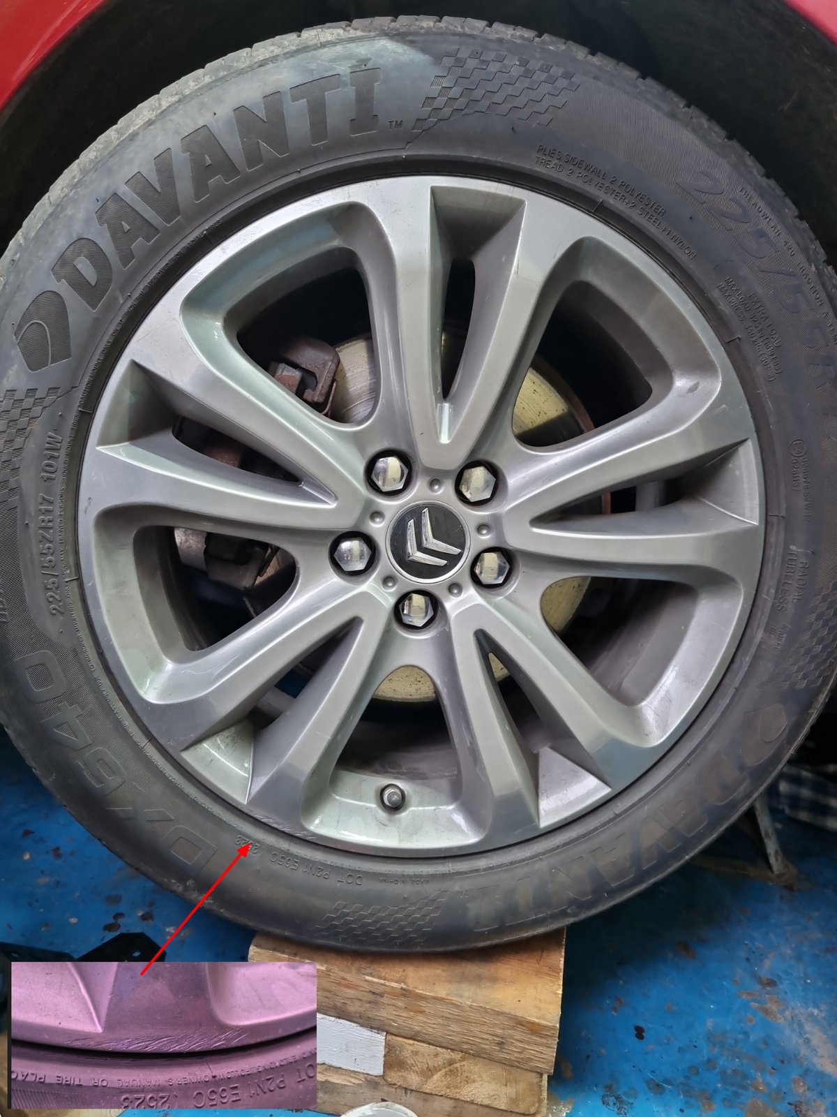

See Photos. I have photographed the grazed wheel, all other wheels are good.

Yes I've seen that one and the OEM version of that pipe is what I fitted in 2019, the pipe that failed goes from the front to the rear, it's about 5 meters long with all sorts of bends and replacing involves exhaust off, Tank off, possibly front sub-frame lowered, and all the underbelly shielding. :dunno:
