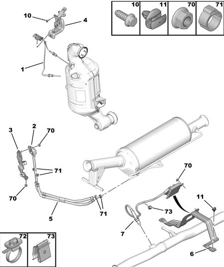

Re: C4GP 1.6 BlueHDi first cat up/downstream temp sensors reversed is okay?
So just for clarification:
(1) Is the temperature sensor to measure the exhaust gas temperature.
DPF
(5) are the Upstream and Downstream Particle Filter Pressure Sensors, connected to (2), the Differential Pressure Sensor.
(7) Is the NOx sensor for the Adblue system.
So there's only 1 temperature sensor.
The only thing I haven't shown here is the UREA (Adblue) injector.
DPF
I'm not sure we're talking about the same thing. The DPF pressure sensors at (5) don't measure temperature they measure pressure before and after the particle filter. The particle filter differential pressure sensor measures the difference in pressure of the exhaust gases between upstream and downstream of the particle filter. They have nothing to do with the Catalytic Converter. They inform the engine ECU when the particle filter is blocked so a regeneration can take place.
The exhaust gas temperature sensor of which there is only one shown here, is just so the engine ECU knows how hot the temperature is so it can decide when to regenerate the filter (and relevant operations). The NOx sensor is intended to measure the overall volume of nitrogen oxides and the mixture of the exhaust gas downstream of the deNOx system.

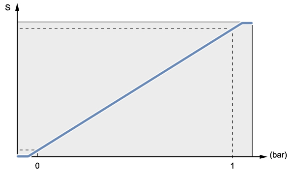

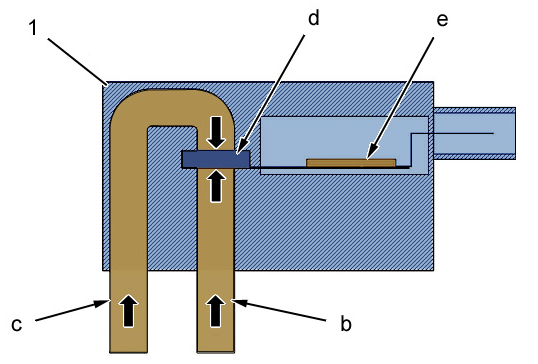

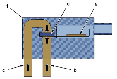

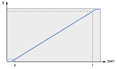

Here's a typical DPF sensor (in this case fitted to the DV5 engine) in case you are referring to this and the upstream and downstream sensors must be connected correctly as you can see:
The particle filter differential pressure sensor receives the pressure upstream of the particle filter on its upper face and the pressure downstream of the particle filter on its lower face.
The difference between the pressure upstream and the pressure downstream of the particle filter causes the resistance of the piezoresistor sensor to vary.
Depending on the resistance of the piezo-resistive sensor, the integrated electronics generate a code which is transmitted to the engine management ECU.
The particle filter differential pressure sensor is able to carry out self-diagnostics and signal any fault to the engine management ECU.
Key
"S" Particle filter differential pressure sensor digital output signal.
(bar) Difference in pressure measured between the pressure upstream and the pressure downstream of the particle filter in bars.
The particle filter differential pressure sensor output signal is proportional to the difference in pressure upstream and downstream of the particle filter.
- (1) Particle filter differential pressure sensor.
- "b" Pressure take-off downstream of the particle filter.
- "c" Pressure take-off upstream of the particle filter.
- "d" Piezo-resistive sensor.
- "e" Integral electronics.
Key
| Description | Values |
| Supply voltage | 5 ± 0,25 volts |
| Maximum supply current | 20 mA |
| Range of differential pressure measured | Differential pressure measured between 0 and 1 bar |
| Maximum pressure admissible without irreversibly damaging the operation of the sensor | Maximum pressure upstream: 2,4 bars |
| Maximum pressure admissible without irreversibly damaging the operation of the sensor | Maximum pressure downstream: 1,3 bars |
| Maximum pressure admissible without mechanically destroying the sensor | Pressure upstream: 3,3 bars |
| Maximum pressure admissible without mechanically destroying the sensor | Pressure downstream: 1,4 bars |

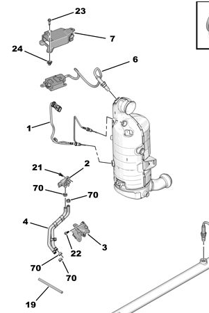

Hi Chris. I have an expert van mk3 with the same dpf as the diagram.
While i was trying to remove the 2 temperature sensors to do a dpf clean, i may have applied too much heat damaging the cable on one sensor. It seemed more of a loose connection. I purchased an aftermarket sensor and did a forced regen. The pressure went down to 2 mbar, cleaning the dpf worked. Reading the DTCs displayed downstream temp too high. After a week of driving the engine management light came on. After comparing the new 4 pin sensor to the original i found the cable are different lengths, therefore i fitted them the wrong way around. Problem fixed. Few days afters DPF warning light came on, backpressure over 60 at idle. It seems the downstream (i think its after the first temp sensor) was over 60 degrees higher than the upstream that appear odd.
One thing i cant understand from the diagram is why is there a pressure sensor on the lower cat? is this really the DPF? Maybe the clean increased temperatures and the lower cat is now cleaner? Can someone clarify.
Also my ECU has an error code U3-FFF. Ive replaced the fuel filter as someone has suggested.
