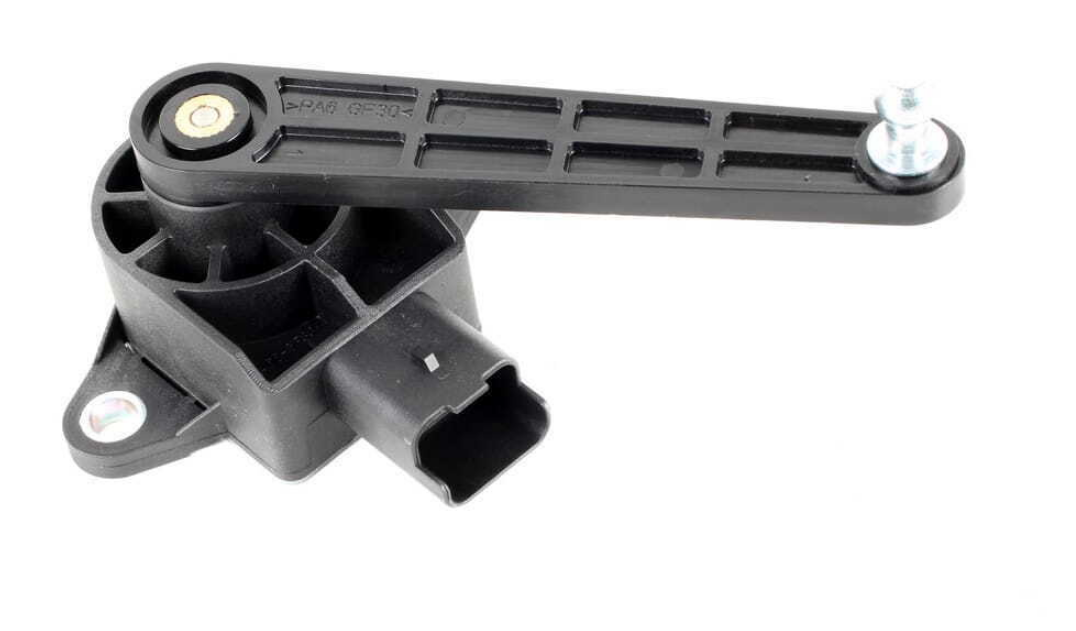

They look like this:
This is the only thing that would affect weight on the axle where the sensor could become unstuck with additional passengers / luggage and then when the vehicle is lighter again, the fault would come back again.
The corrector is a lot cheaper to replace.
If this solves your problem great, but it may be a coincidence. Otherwise you can't disassemble the headlamp as far as I can see. So start with the sensor.

1) If the height sensors (on the axles as per my picture) are faulty = headlamps work only up and down, not side to side. - This is why both won't work directionally - this is caused by the height corrector.
2) If the Headlamp Azimuth Motor inside the lamp (not replaceable) is faulty it can also affect lamp movement.
3) Headlamps are supposed to be different beam angles for the left and right lamp, and lengths, so they don't blind other drivers.
4) Forget the fog lamps, they are nothing to do with the headlamps.
So your issue is either the motor in the headlamp = new headlamp or height corrector as far as I can see.
The fault B1109 may be intermittent - so check the wiring connector to the headlamp.
