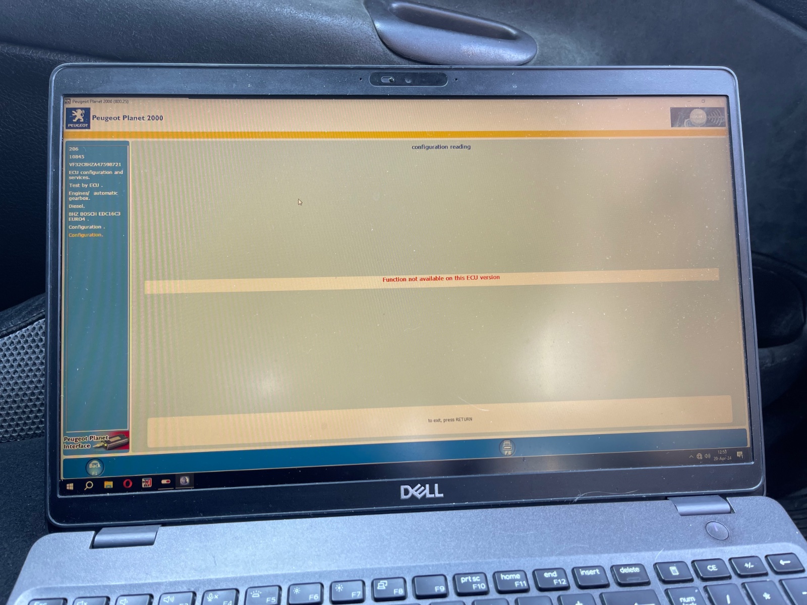

Hi everyone, I’ve just got my hands on diagbox and I’m trying to get cruise control working on my 1.4 hdi however when I try to enter configuration it says function not available on this ecu version not sure how to get around this I’ve seen a forum of of someone else who has done it although he has not explained how he did this, thanks

What version of Diagbox are you running? The photo shows PP2000.
What year is the 206?
Is the system full chip and is it Rev C?
x 6955
Re: Peugeot 206 cruise controll
Not all Engine ECUs support cruise control - this is what it is telling you.

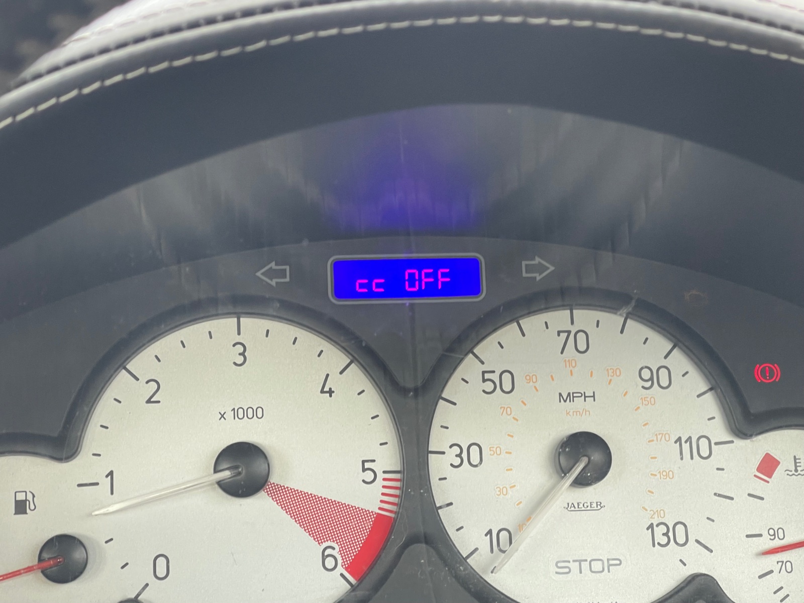

It’s diagbox 9.149, the year is 2006, not sure what you mean by full chip and rev c, I’ve managed to tell the bsi that it is there and it says cc off and waits for me to set a speed but then does nothing
