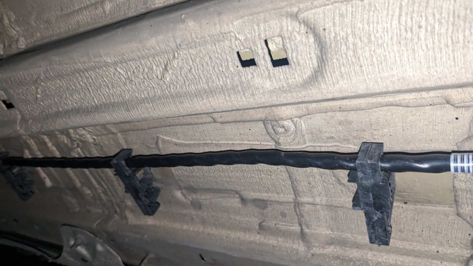

Hi
I have just had the adblue tank/pump and pipe replaced on my K9 2019 Berlingo. Please can someone confirm if the pipe should be exposed like it is in the picture?
Thanks
x 6955
Re: Adblue pipe exposed?
Yes, that’s correct. It’s a heated pipe in any case to prevent crystallisation.

Thanks, it just looks so exposed and vulnerable.
