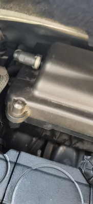

Can anyone tell me what pipe is on the Airbox of a DS3 turbo and where is it going? I want to do an intake on my DS3 and do not know what to do with the vacuum pipe once the airbox is removed.

Can you upload a photo of the pipe?
I suspect that it is the vapour cannister purge pipe, but I am not sure from your description.
- x 6956
Re: Airbox Vacuum pipe
That certainly looks like it and in that case it will go to the petrol vapour canister which is then connected to the fuel tank.

On earlier cars, that pie connected with the air pipe just before the turbo inlet. It is connected to a valve under the manifold that opens up when the engine is running.

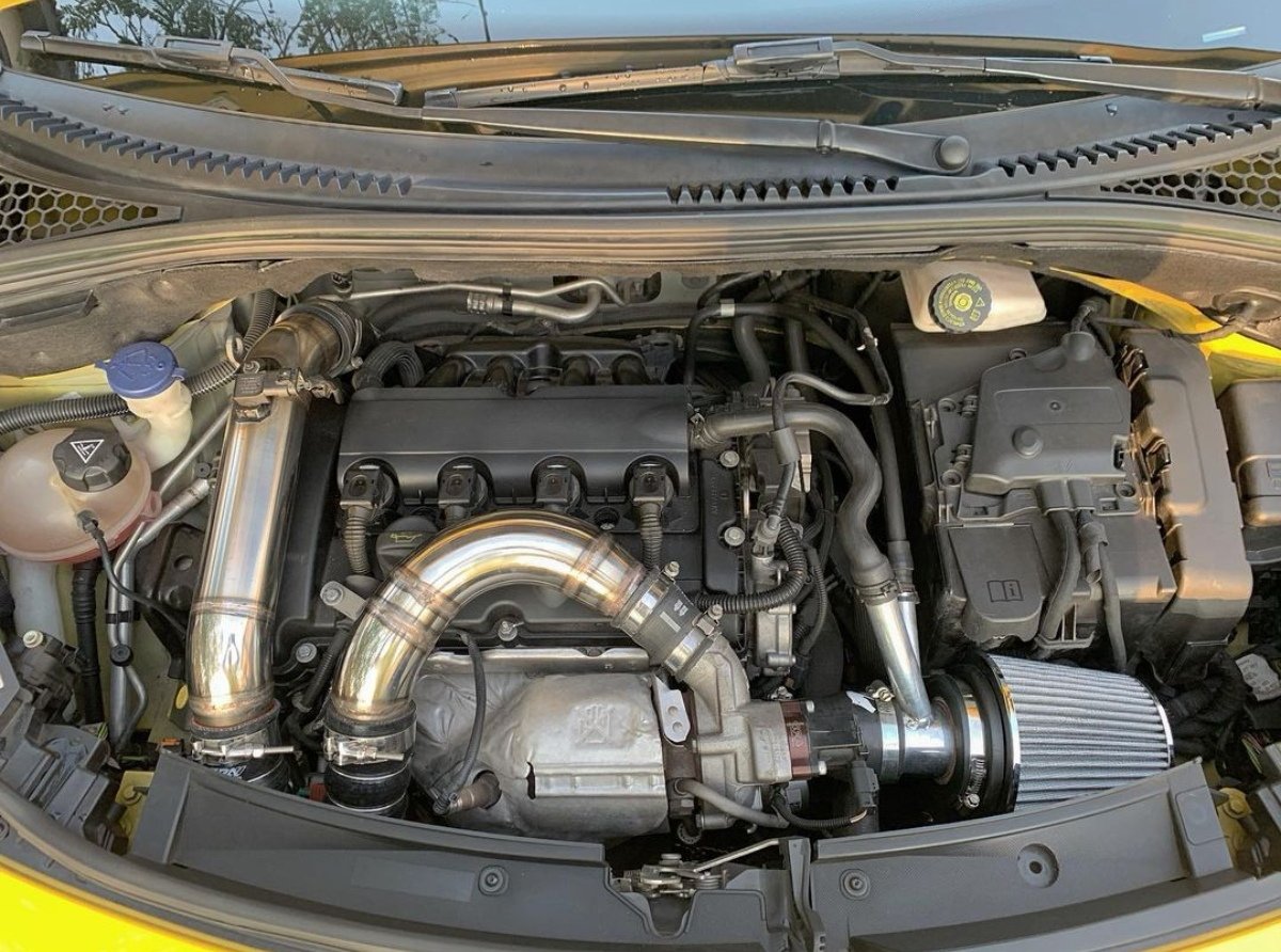

The vapour hose is in that picture, the one closest to the battery running to the air intake pipe.
