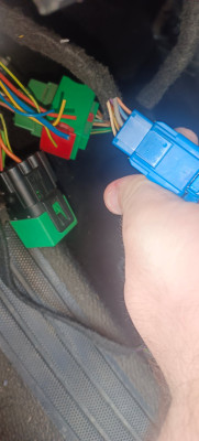

Does anyone know where these cables go? They are jus cutted of and hanging in the air.
Posts: 37767
x 5813
Re: c5 x7 starts then after 2 - 3 sec. shuts off. After changing cabin filter.
Post by GiveMeABreak »
So in order to help, if you gently peel back some of the black insulating tape, the wiring sleeves will have wiring codes on.
For that Blue connector, if you can tell me how many pins it has (in total, regardless if there are any blanks without wires) and provide a few codes, I can advise on what it's for.

My C5 has that as well they're not a cut plug it's just part of the loom. The others I think are just termination plugs in the loom
Darren

obolikol wrote: 14 Apr 2024, 11:32 Image
They are repair/accessory wires, you will find the other ends of them underneath the under bonnet fuse box. The are spare wires already ran through bulkhead for fitting accessories or replacing broken wires.

Thanks for clarifying Wheeler
