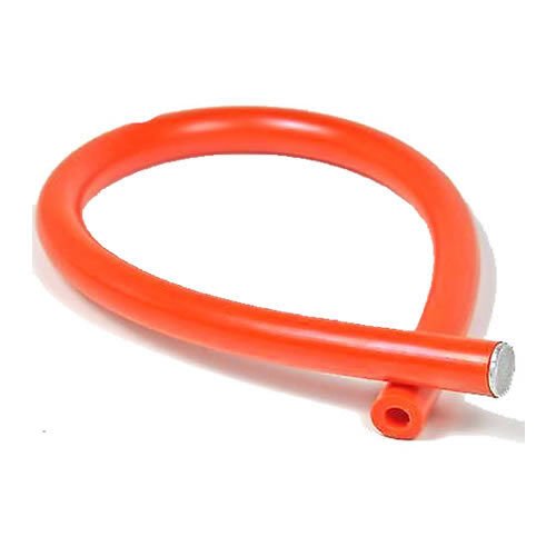

Except for on hydraulic Citroens I have used one of these since about 1980.
Cheap and effective.
No need for an assistant.
Attach the open end to the bleed nipple and open it, drop the 'closed' end into a bottle.
Pump the pedal in the usual fashion, three pumps is usually sufficient.
Close the bleed nipple, remove the tube and onto the next wheel.
There is a one way valve in the 'closed' end that lets fluid and air out but not back in again.
