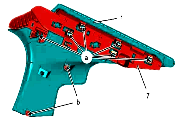

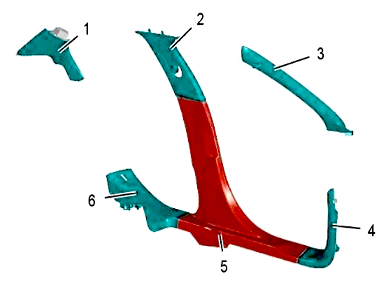

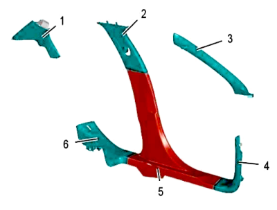

To get to the rear belts, you'll first need to remove the rear parcel shelf and then the parcel shelf trim and lower sill trims (1) & (6) shown on the diagram:
(1) Rear parcel tray trim.
(2) Centre pillar upper trim.
(3) Windscreen pillar trim.
(4) Front pillar trim.
(5) The centre pillar lower trim.
(6) Hinged rear door sill trim.
(1) Rear parcel tray trim This shows the inside of the rear parcel trim so you can see where the clips are.

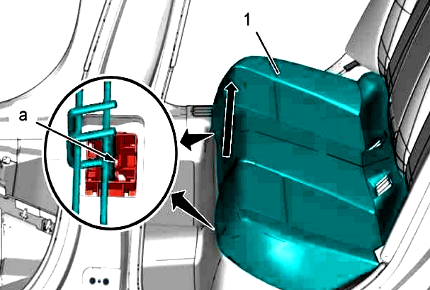

Before tackling the rear sill trim, you'll need to remove the rear seat cushions. Be careful as there are electronic wires for the seat belt sensors around this area.
Detach the rear seat cushion (1) (In "a") using trim removal tools.
Disengage the rear seat cushion (1).

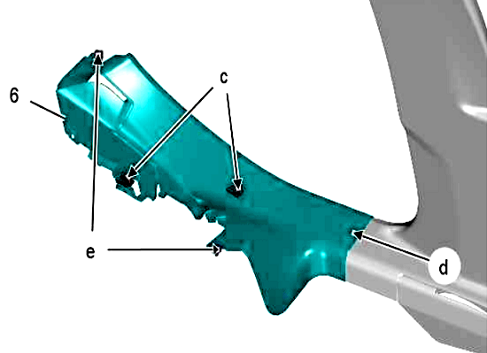

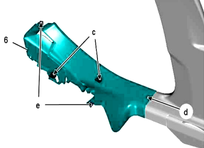

Unclip the hinged rear door sill trim (6) (at "e" and "c") using trim removal tools.
Unclip the hinged rear door sill trim (6) (at "d") using trim removal tools.
Remove the hinged rear door sill trim (6).

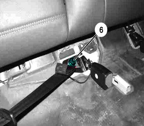

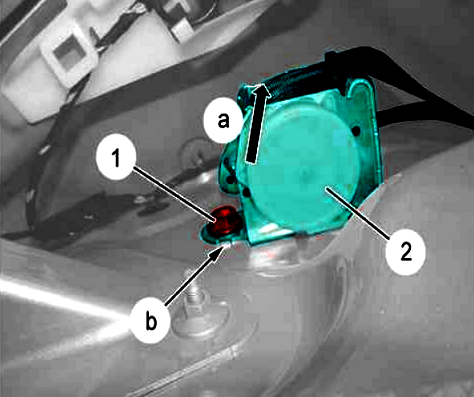

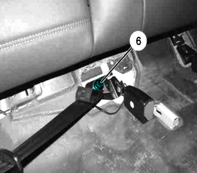

Remove the screw (6).
Remove the bolt (1).
Release the reel (2) from the slot (as "b") (At "a").
Remove:

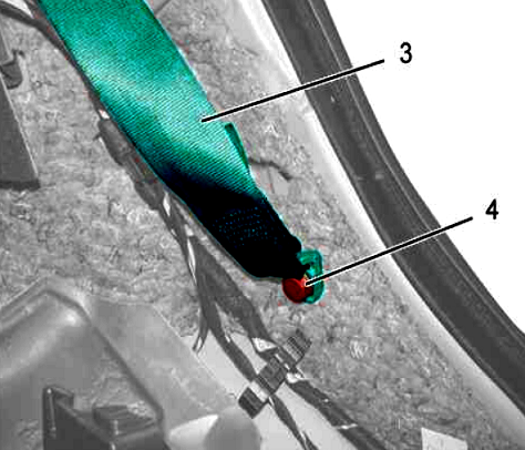

The securing bolt (4)
The seat belt (3)

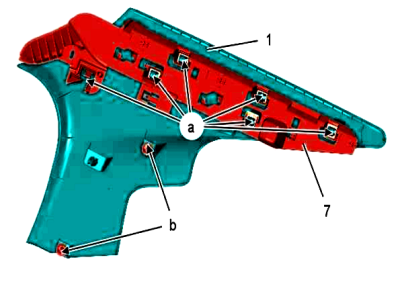

Remove:
The seat belt (3)
