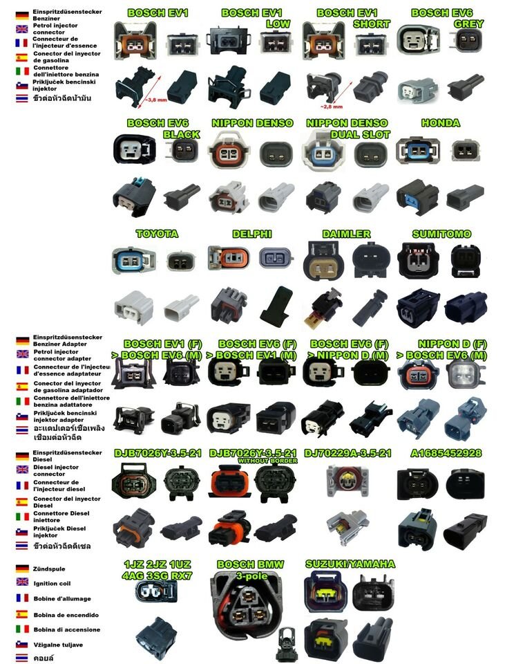

Unread post by 407 »
Looks like a Bosch EV1 5 pin 1287013006, 1 287 013 006, 282193-1
try Amazon, Ebay or Aliexpress https://www.ebay.com.au/itm/171580535426 or a good electronics shop (eg https://www.farnell.com/)
I also think the 2nd pin (circled) is loose and pushed in and you might be able to refit it into the socket by pushing at the rear of the socket with small screwdriver
Or fit it and then push it in from the rear to make contact with the male connector
