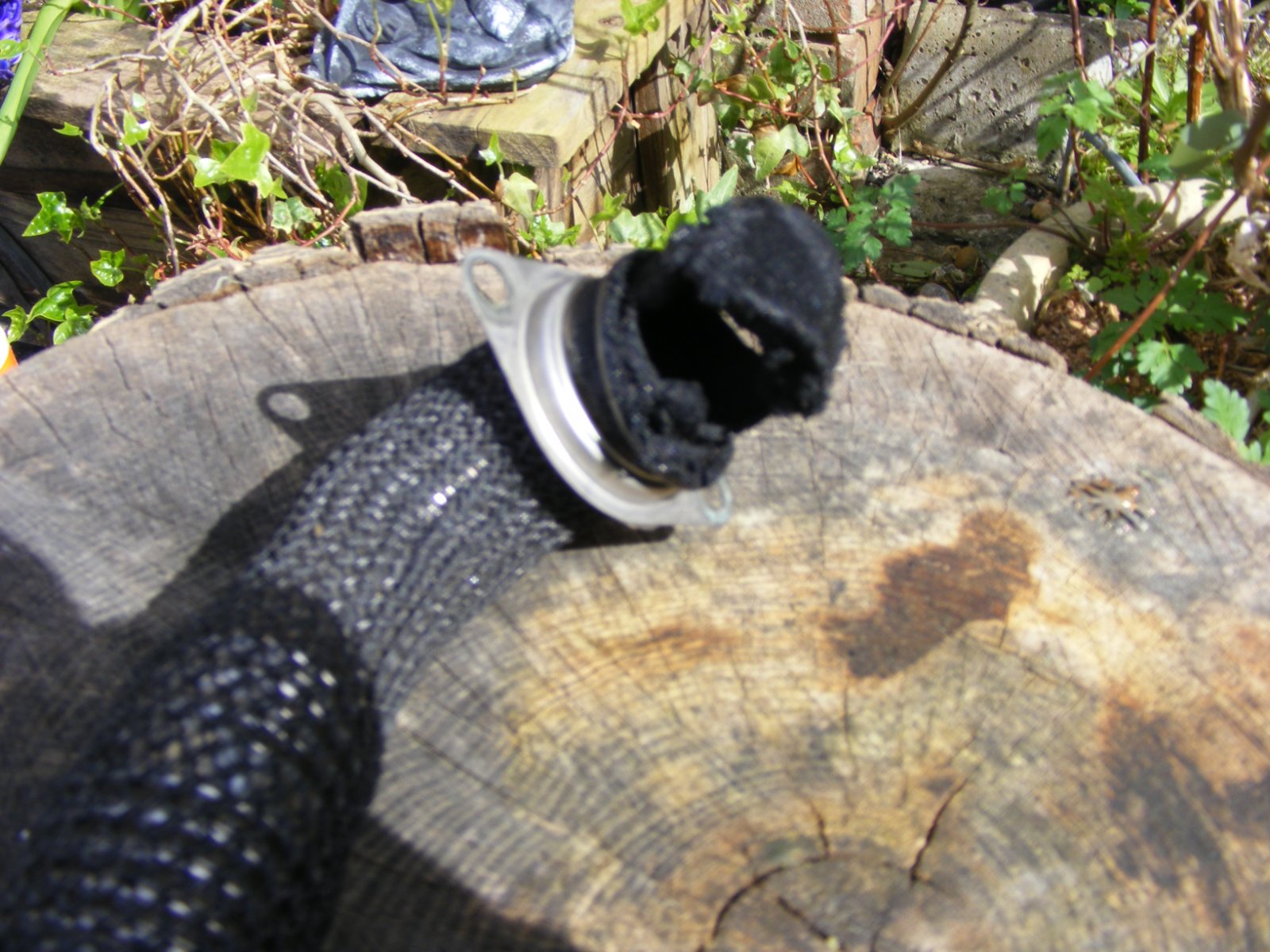

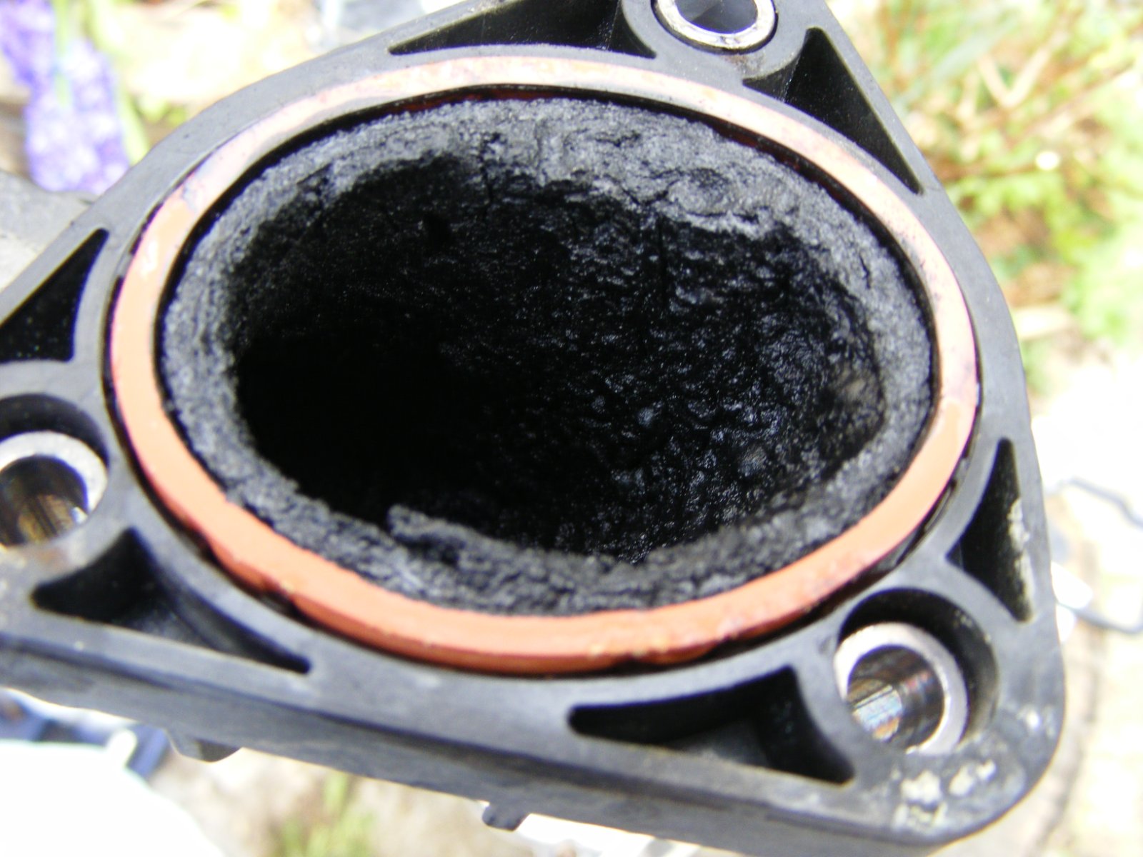

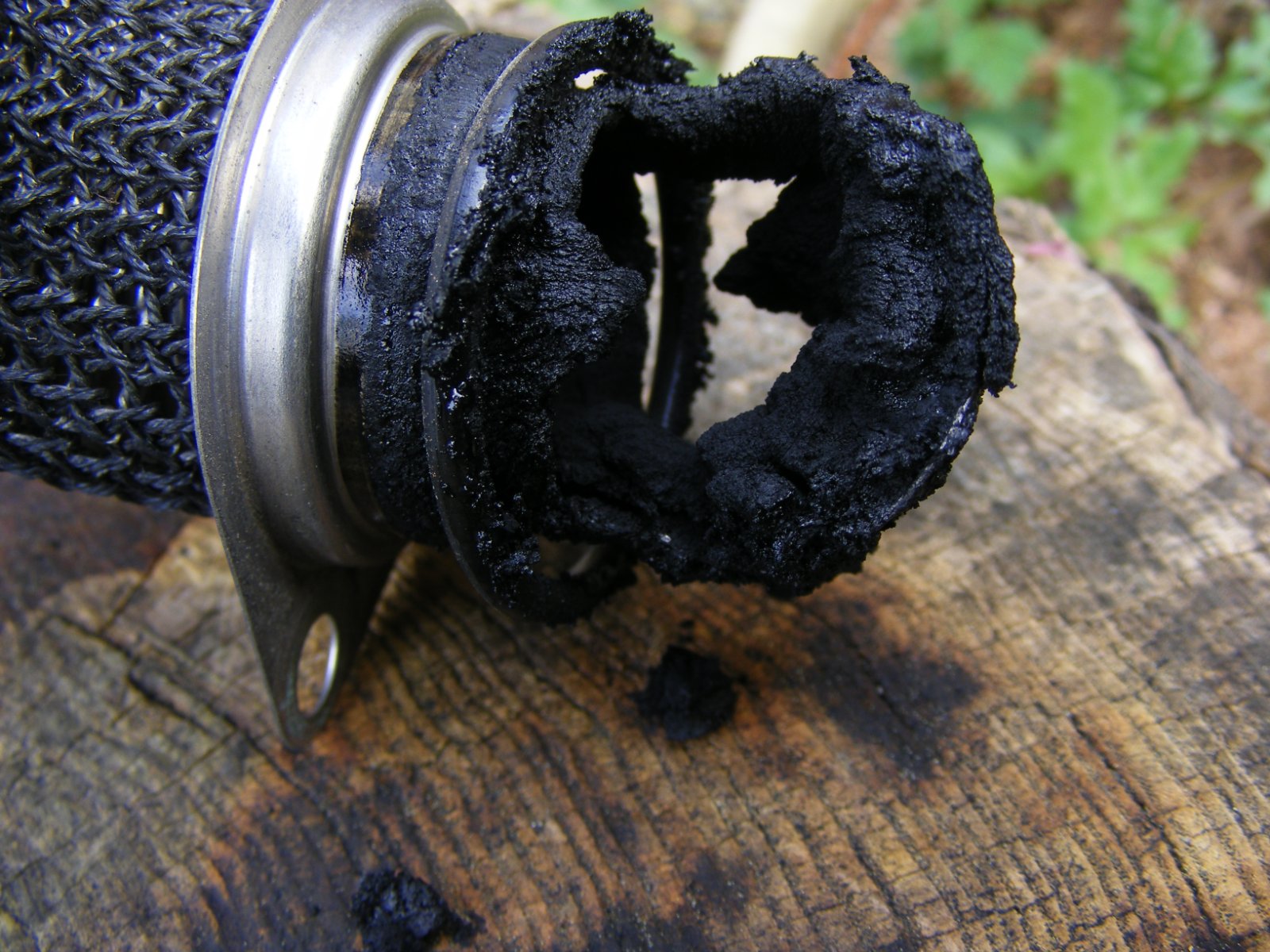

Some photos of very dirty egr pipe work....&

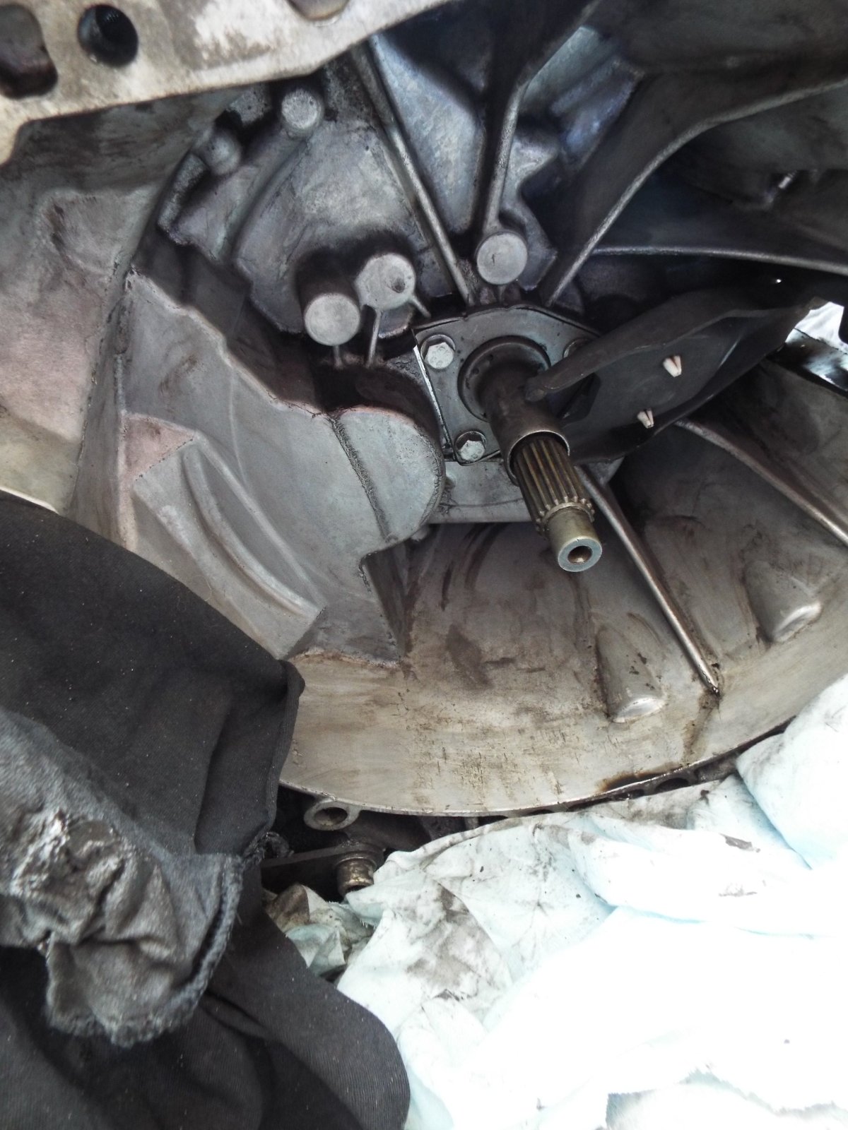

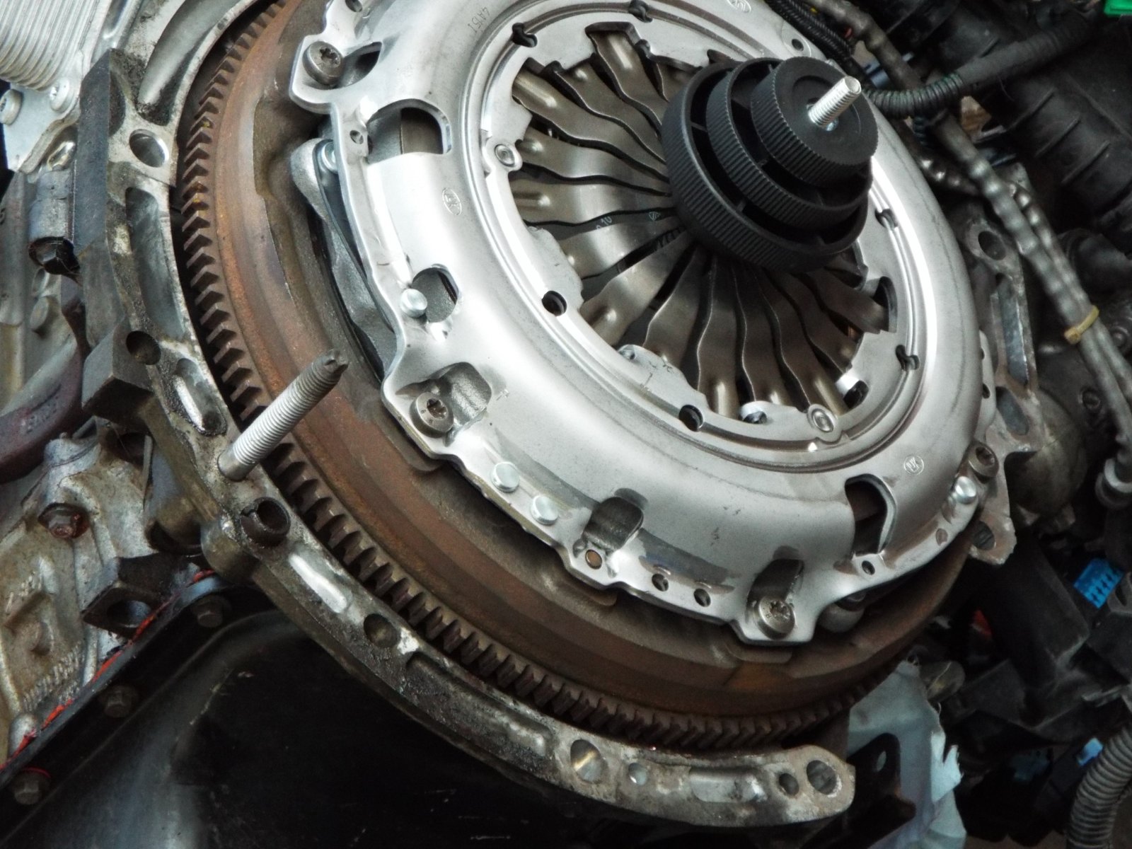

This is a major job, theres so much to come off these engines thank god it was taken out of the car. We found out a core plug had gone , where are they located ? yes under the exhaust manifold. We then thought this was the cause and the head gasket would be ok , no, once the head was removed pots 1 and 4 revealed tell tell signs of weapage plus the head gasket showd signs of rust and a small split which lines up perfect with the leakge area of pot number 1. The gear box was also removed & the clutch plate removed to reveal a clutch plate diplaying all the signs of a former owner riding the clucth pedal hence why this clutch replacement less than 2 yrs ago failing. The flywheel is solid and the face looks fine dont need replacing , thank god ..
Also discovered the thermostat stuck wide open so this will be replaced. Glow plugs are all fine . Plus egr system has had a partial clean out which will be completed in a couple of days.

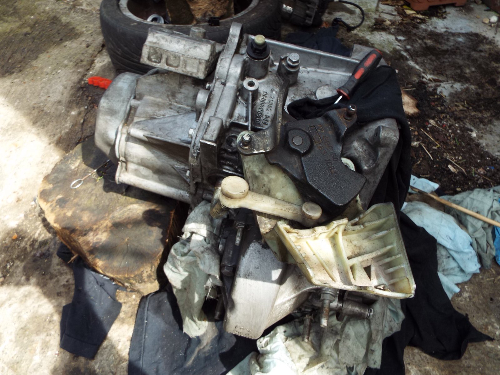

Felt a little better today , so i did ... Look at the photos ! Oh that sensor was covered in black sticky coke , so it got a decoke like the gear box did ! Now i can see its part number on the sensor .
