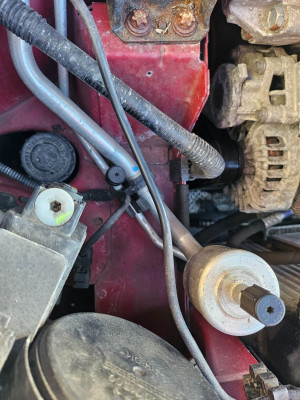

Hello and thank you for any advice you can give.
I've got a C4 cactus and the air con is clearly labelled on grey caps for 1234yf gas. No probs

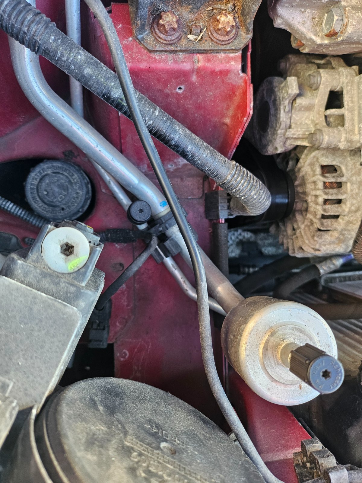

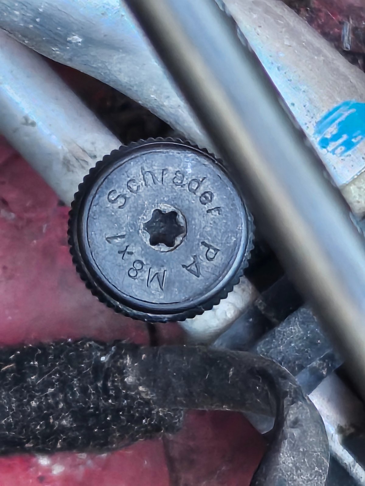

However, my wife has a 2015 C4 and it's less clear. The caps are black, don't indicate which gas and I'm not even sure which is low/high. My cactus is so much clearer.
Attached pic. Any advice appreciated

The one on the pot / fat pipe is the low side. The later gas has a different size connector, so if you have a known one on the Cactus then compare with the C4 - my guess would be if it doesn't say on a label under the bonnet then it will be 134a.

Re: Air con query
Thank you for replying. Much appreciated
I'm thinking 134 also as there's nothing suggesting the newer gas and having just gone and checked, the 134 connected does fit the pot/larger pipe. I just needed someone to validate my thoughts.
