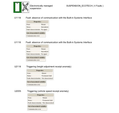

Hi Guys, Am I looking at the same issue as Monad?
During pre MOT Checks and servicing I have a few faults still present:-
Re Electronically managed suspension
U1118 - Fault: absence of communication with the Built-in Systems Interface (x2) , Intermittent Fault - Communication error?
U2118 - Triggering (height adjustment receipt anomaly) , Permanent Fault - Communication error?
U2005 - Triggering (vehicle speed receipt anomaly) , Permanent Fault - Communication error?
History.
  • The U1118 faults were first seen a few months back, see viewtopic.php?t=76359&hilit=U1118. As all the other faults were cleared and did not return again I never followed it up #-o .
  • I fully depressurised the system with Diagbox to help me check suspension joints. However, this did not go as planned, I now have more than 150ml of LDS that I managed to catch as it spewed from the reservoir. Previously I had only checked the level by lowering the car to the lowest setting. The stuff I did not catch covered the pump and its BHI, both of which were wet prior to this!
  • Prior to fitting 3 new front Spheres I have ordered, I thought I would also check the heights. I seem to be about 20mm high front & rear and I'm hesitant to change this because, (a) I have never had to adjust the rear, (b) I only adjusted the front a few years back when things got knocked while changing the rack, and (c) the car looks right
The U1118 has been around since May 2023, the U2005 has been around since December 2017 and the car drives okay, apart from not being as smooth as it should?
Any thoughts would be appreciated.
Thanks

Stu 🏴󠁧󠁢󠁷󠁬󠁳󠁿
x 6956
Re: C5 X7 faulty BHI?
Ignore U2005 Stu. That's a phantom fault as a result of the suspension ECU (contained within the BHI) being interrogated.
U2118 is an ECU partial triggering fault - that is on the intersystem CAN network - but this is a generalised CAN fault and can appear on different ECUs, but in the case of Diagbox it has pointed this specifically towards the suspension height. As the height sensors on this vehicle are just analogue sensors, the fault is likely to be with the BHI having an issue reading the data correctly. That could indicate some issue between the sensor wiring and the BHI. Given that you've already noted some contamination with LDS leaking onto the BHI and mentioned it was wet already, I would be looking at ALL the BHI connectors, pins and sockets and giving these a good clean up with electrical contact cleaner as a first check.
Fault Code: U2118
Description of Fault: Intersystem CAN network: Request for partial ECU triggering not plausible or absent. Communication fault between ECUs detected for 3 secs.
Conditions of activation of the diagnostics
The following conditions have to be met:
- Engine running
- Ignition on
Conditions for Fault to clear:
  • Driving with the engine hot for 5 minutes
Downgrade Modes whilst Fault is active: -
Symptoms:
  • Engine hesitating, cutting out
  • Lack of power
  • Starting problem
Suspect Areas:
  • Engine ECU
  • Intersystem network
Fault Code: U1118
Description of Fault: Intersystem CAN network: Loss of communication with the ECU BSI. Communication fault between ECUs detected for 3 secs.
- Engine running
- Ignition on
  • Reversible deactivation of the vehicle speed limiter, cruise control and speed curbing functions when there is an engine information fault.
  • Irreversible deactivation of the vehicle speed limiter (Need to switch the ignition off and then on, in order to make the function available again).
  • Deactivation of the tight spot for the cruise control.
  • Reversible deactivation of the vehicle speed limiter.
  • Reversible deactivation of the vehicle cruise control.
  • Reversible deactivation of the vehicle speed limiter, cruise control and speed curbing functions when there is a transmission information fault.
  • Reversible deactivation of the vehicle speed limiter, cruise control and speed curbing functions when there is a vehicle information fault.
  • Switching on of the warning lamp and/or warning message: Warning lamp MIL
Symptoms:
  • Lack of power
  • Starting problem
Suspect Areas:
  • Engine ECU
Sloppysod

Thanks for that Marc, I have been with the car all day, and now having a rest now.
Had planed to look at the BHI connectors, but forgot, will do tomorrow morning though.
I am suspecting a front height corrector as I have noticed that sometimes when sitting at the traffic lights the car will suddenly correct the front height by lifting the front about and 1" or so.
I think the previous height settings I calculated may have been incorrect and the car was possibly in the Normal+1 position #-o
I have run every suspension actuator test without any failures or error messages - So I assume that any problem is no longer visible - for now
I cleared all the faults and took the car for a 'vigorous' test drive, I found some really potholed roads, in normal mode, normal+1 and sport mode in both - no faults on return.
First thing this morning I checked front and rear suspension heights, engine ticking over, hand brake on!! Front was 169mm, Rear Was 76mm, not bad but still wrong!
After the test drive, I measured the heights again, this time, Front was 173mm, Rear Was 87mm, so they still need adjusting.
Questions
When the car gets a error in either height corrector, does it go into 'Safe' mode by either, raising the suspension a little or default to sport mode?
Also, not sure why the two measurements from today are different, I can only think it being either the "handbrake on" and/or the "Suspension cold" vs "handbrake off" and/or "Suspension warm". #-o
Would, having too much LDS in the tank make any difference?
I done a bounce test this morning, suspension cold, and I thought my diagnosis regarding new spheres was wrong, but when I done another with the suspension warm, I think I was right, would warm suspension make a difference?
Now I have a problem what setting do you adjust in Diagbox from the Height setting option?
  • Front & Rear Setting Height
  • Front & Rear Filtered Height
  • Front & Rear Reference Height Programmed
  • Initial Front & Rear Reference Height
viewtopic.php?t=81842
Stu 🏴󠁧󠁢󠁷󠁬󠁳󠁿
PaulC5
Posts: 2586
Joined: 06 Jun 2023, 15:26
x 675
Unread post by PaulC5 »
'I am suspecting a front height corrector as I have noticed that sometimes when sitting at the traffic lights the car will suddenly correct the front height by lifting the front about and 1" or so.'
Our 2007 C5 does this sometimes but I find greasing the height sensor pivot joints seems to stop it happening for some time.
x 6956
No this is normal operation and is referred to as hysteresis, so don't go adjusting on the basis that those measurements are changing because of this function:
During normal operation, for a selected body height, the integrated hydraulic block corrects the ground clearance in the following cases:
  • Difference between the front or rear height and the reference ride height more than -4 mm and 4 mm (hysteresis)
  • Difference between the front height and the rear height more than 8 mm
The function takes into account the average height of the body in order to eliminate "interference" and filter the current travel values.
A timed period referred to as the "dashpot" is applied between the time the system detects that the body is outside the hysteresis zone and the time when the height correction comes into operation, in accordance with the conditions below:
  • On starting, a timed period of 0,5 second, when the driver requests a change in height or when the integrated hydraulic block ECU is triggered for "height correction"
  • When the vehicle has been driven and becomes stationary with the engine running, the timed period is 60 seconds
In the other cases, the timed period is 10 seconds
Note: The height can only be modified when the suspension stiffness pattern is in "soft" mode.
You can't change the reference heights Stu as these are programmed at the factory for comparison against the actual ride heights.
Regarding back up modes:- yes, there are values that will be applied or functions set to limits or inhibited, depending on what the fault is or what info is deemed incorrect, but these are quite complicated as they depend on multiple factors, for example restricting height correction, stopping road condition monitoring, deactivation of hydractive function etc.
