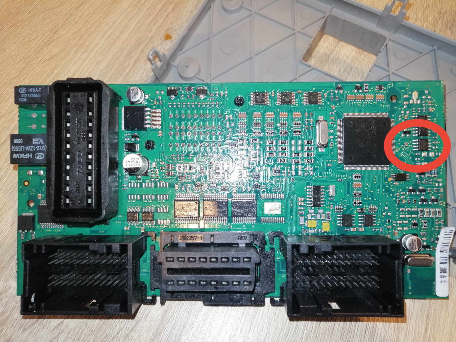

The Can Bus A82C250 controller in BSI was defective. After changed this microcontroller the BSI came back to life again, but the CAN data was intermittent.
When I touched the BSI connector (CAN wires) I realized that it had a bad contact too in this connector.
I opened up the BSI again, and resoldered the connector pins.
All CAN problems are solved now.

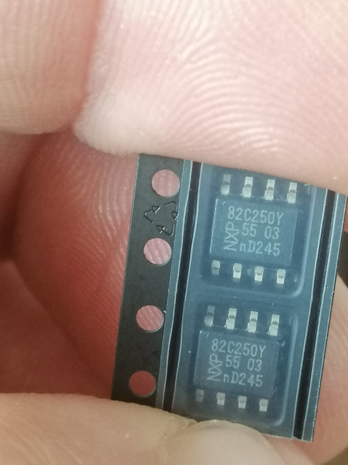

Nice work, do you have a picture & location of this A82C250 controller (whatever that is
) inside the BSI?
