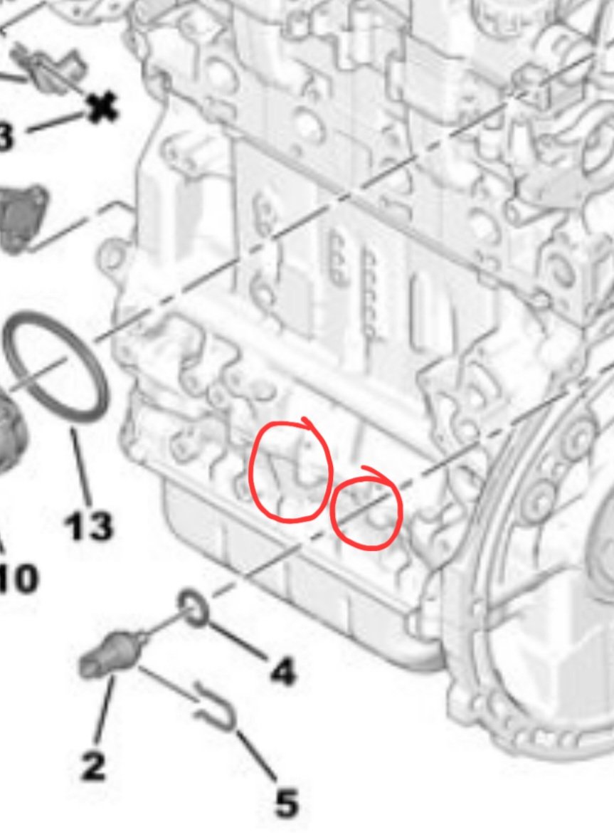

Ok back of the engine area dry. A screen shot added to this showing 2 drawn red circles by me, showing where coolant is seen on the little bolts in this area .
My deep fear is the engine has warped bottom end ? Is this possible.
Somethings i dont like doing or to keen on
Ive for now shoved in a bottle of wynns stop leak for the whole system to be honest if it works & i can get some use till the mot runs out then ive had my moneys worth i get then i could possibly break for parts & claw back some cash that way.
Its run throught the system over an hour the leak has stopped theres no air in the system the heater blows lovely hot air if i get 7 months out the car i will be happy with that. Ive full AA cover ( the ones who come get you after 2 wks wait ) so if i break down im ok. Sometimes we just need to take it as it is.
Red circles bolts with coolant drops on ... leaking here why ?

Head gasket has gone. Back later for more

Marc if you read this any chance of a head gasket replacement procedure ?
:-D
Forum Treasurer
Posts: 12565
Joined: 07 Aug 2002, 17:12
x 1484
Re: Citroen c3 picasso
Unread post by RichardW »
Biggest problem on the 16v is getting the injectors out if they are carboned in. Head bolts are also prone to snapping the heads off. If it's high miles you may also find the cam chain / tensioner needs replacing.

RichardW wrote: 23 Mar 2024, 15:08 Biggest problem on the 16v is getting the injectors out if they are carboned in. Head bolts are also prone to snapping the heads off. If it's high miles you may also find the cam chain / tensioner needs replacing.
The injectors are clean so thats a plus i guess as for miles 90000 just a tad over. So i might be ok.
